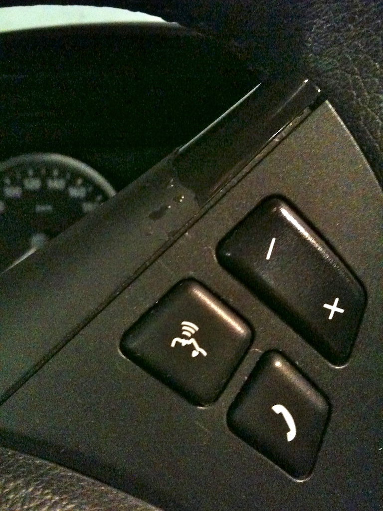

Originally Posted by nwilliams' post='952233' date='Jul 23 2009, 08:21 PM
Like the title says, my M steering wheel has a plastic layer that covers it and some of it is starting to peel.
Anyone had this happen? What do you recommend I do?
Attachment 85046
Attachment 85047
Attachment 85048
Attachment 85049
Happened to me and when I brought it in and they replaced it for free under warrenty.
I just told them the steering wheel is peeling and that this is covered under warrenty.
If you go onto the M5 forums you will see this is a common issue with the M5 steering wheel.
They replaced it with a standard matt replacement and it doesn't have that rubberized coating.
it's easy to replace yourself. the piece is ~$40 if you're out of warranty. I have one at home since I swapped over to silver on my M wheel, but shipping to CA is a pain.
I found some on eBay. Did you have to remove the steering wheel to install this piece, or do you simply pop off the old one and snap on the new?
I'm interested in hearing the answer to that one, because I'm interested in it too. Think we can get a GP going on?)
Anyway, I took the car to a local BMW dealer and they replaced the peeling wheel trim under warranty. The interesting thing is the service writer knew what I was goign to say before I said it. He said they don't replace it with a mat black piece. They replace it with a new rubberized part that is made differently. (I"m not sure how true that could be.)
The one thing that annoyed me is all three things I needed him to look at (low oil, peeling wheel, over head microphone cover cracked) got an "I don't think it's covered" as the first thing out of his mouth.
They came around and decided to fix it all, but I probably won't go back to that dealer again.
you pop off the airbag, undo 4 or 6 screws (can't remember) then the whole front half of the wheel comes off (buttons, etc.) you flip that over and there's 4 torx screws holding the trim onto that assembly. remove, swap piece, screw everything back in. 20 mins tops.
Attachment 85046
Attachment 85047
Attachment 85048
Attachment 85049
It happened on my X5 as well and it was covered under warranty, no questions asked.
