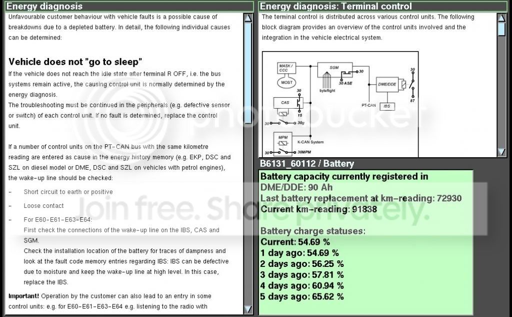

I am with you all the way re: the stealers so you need to be sure of yourground first. To that end you need to get the "if" out of theequation first.
Get a multimeter and record your battery voltage for the followingconditions:
a) After the car has been left standing overnight (or for a couple of daysif you can) or both - should be around 12.5v
b) With the engine running in the driveway - should be around 14.5v
c) With the engine switched off, but immediately after you have been on ahalf decent run (i.e. Alternator been charging for a decent while, say 30 minutes) -Should be around 12.5v
Only then will you have some idea as to what is happening to your battery(in differing circumstances) and if it is all or part or none of the problem.
If you have DIS (or know someone that has it and will help you out) you canaccess the battery history charge status over the past 5 days, it should beshowing somewhere in the upper 90's, it will also tell you when the lastbattery change / registration was, (see image below) confirming whether thestealer did the job correctly or not.
I'm not saying the battery is definitely your problem but everything youdescribe has all the hall marks so you need to either eliminate it or proveotherwise in the first instance.
Fixing a battery issue whether it is down to a dead cell, Alternator notcharging or something is draining it overnight is likely to be a whole lot less expensiveto fix than swopping out ECU's or other components.
Let us know how you get on.
http://i616.photobucket.com/albums/t...ps654aede3.jpg
