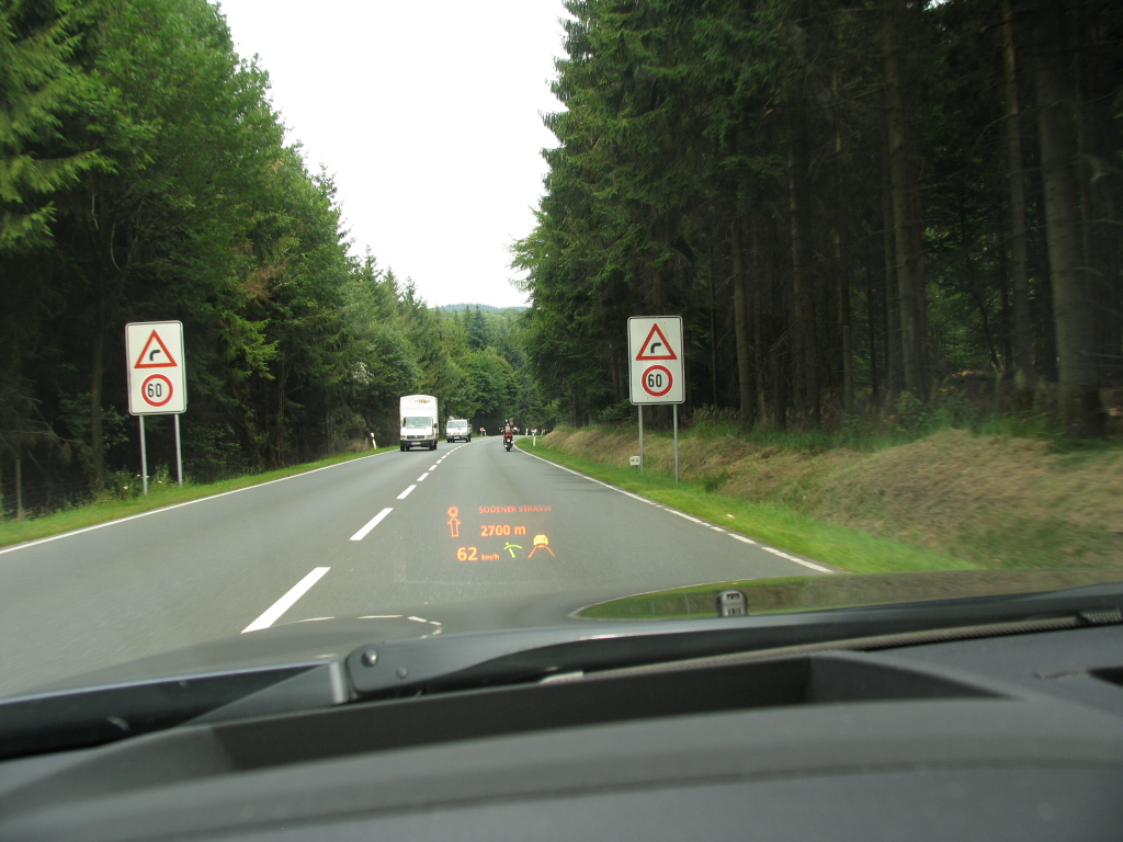

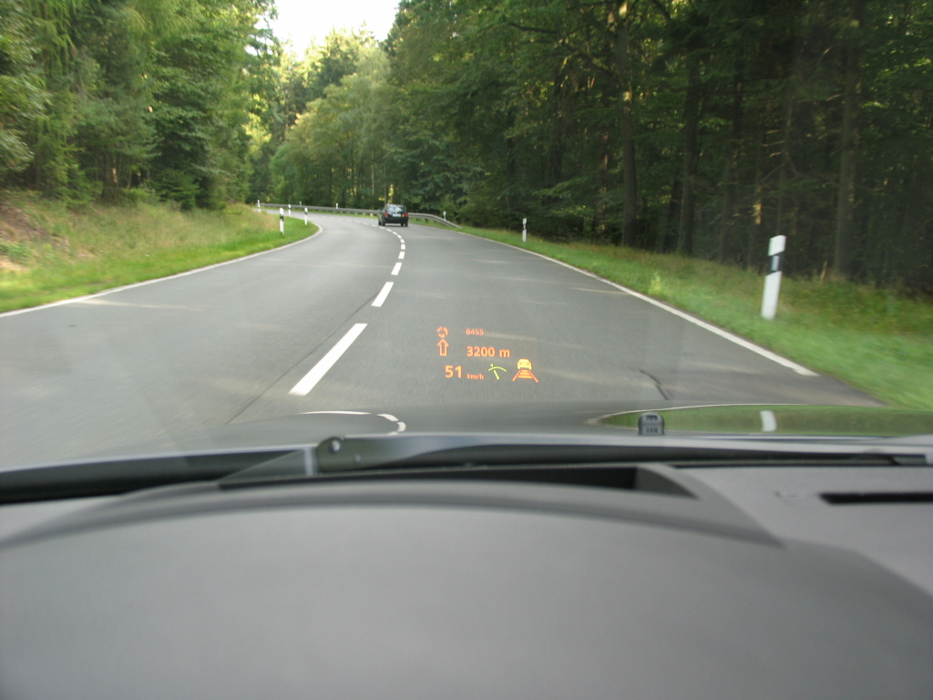

I took pics today, but the problem is, you can't really see it in the pics. Those two pics below show before and after. If you move the mouse between the HUD and the hood you will see that the gap is now bigger.
When the HUD gets raised, it doesn't just move up a little, it also comes a little closer.
Attachment 9140
Attachment 9141
[snapback]150400[/snapback]
Thanks ... it is difficult to see but at least its something
