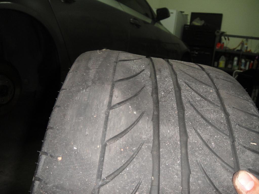

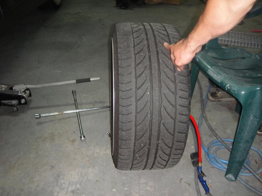

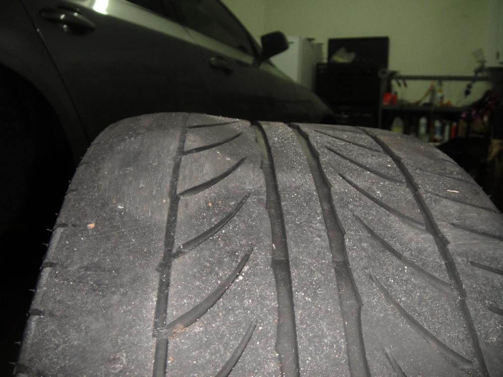

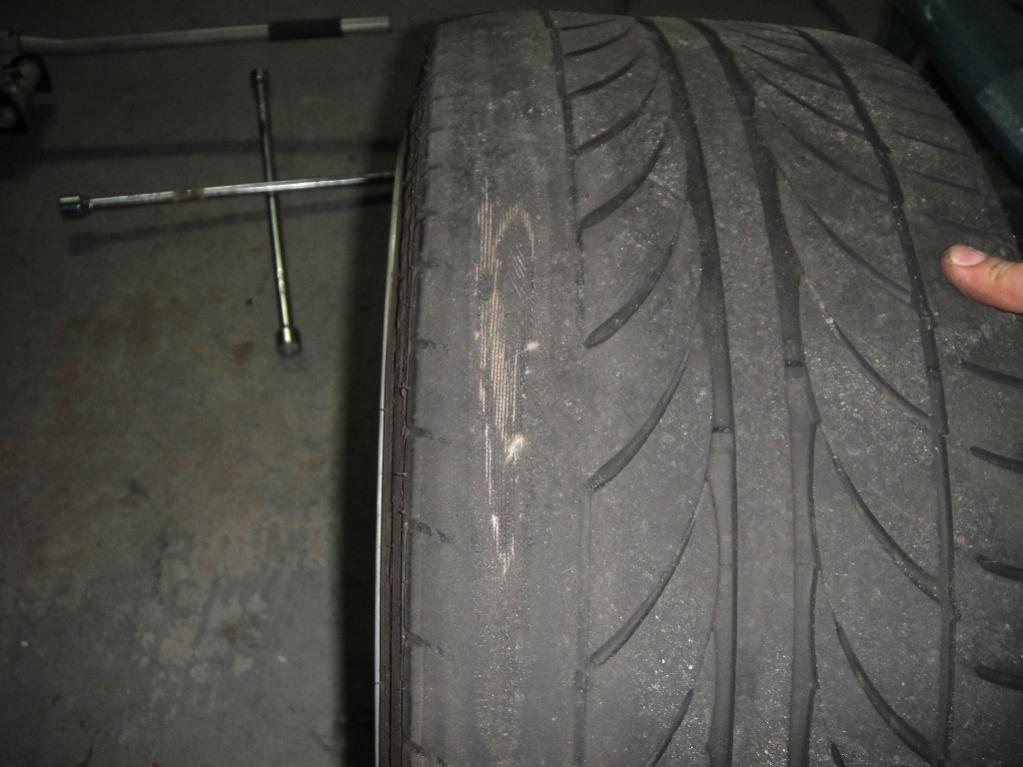

Originally Posted by H F
The reason the insides wear out is... because all the cars wieght is actually mostley sitting on the inside 3 inches of the tire , because the negative camber is so radical, the top of the tire is leaning way in,,, and the bottom inside corner is supporting all the cars weight,,, thats why it wears out on the inside edge...
When they do an aliegnment they actually put 200 lbs on the rear floor board to get additional wieght on the tires and more wieght toward the center.. then they set the camber..
On my car i went 1. % negative camber and added 5psi..(went with nitrogen) added 180 lbs,( woofer, box and amps ) of wieght to get the car to ride more on the center of the tire,, and it worked,,...i break the tires off the wheels rotate my rears side to side .. and no more inside tire wear.. after i rotate the rears and they start wearing evenly i reduce tire pressure to 3lbs over,, as the tire wears evenly all the way across ...I have actually been working on this madness for the last two years to get my tires to last...I purchased all four tires on october 2010 and my rears are due,, but worn out completly even..
Thanks for the tip bro, just got 2 new rears today so will keep a good eye on them and swap them on the rims when the time comes
Im not even gonna get an alignment, my fronts are perfect just the rear that was worn the hell out and since im not the only one that has experienced this i guess its a "common" thing.
My rears:
RIGHT WHEEL
LEFT WHEEL
Old Mar 19, 2013 | 06:01 PM
  #33
unoe60's Avatar
Joined: Dec 2012
Posts: 57
Originally Posted by Lambda28
You're my hero of the day. I was wondering if I could salvage my rear evo v12 tires due to negative camber (w 10mm spacers). Answered my question. Thanks!

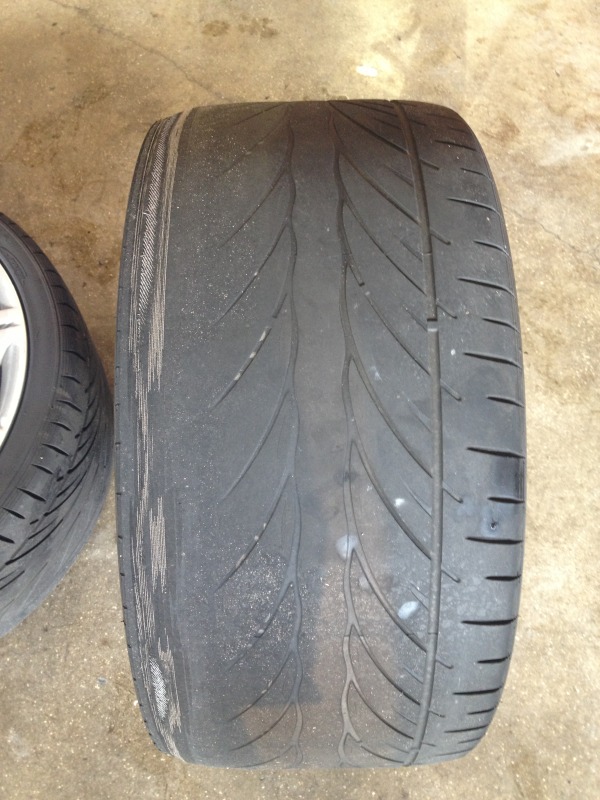

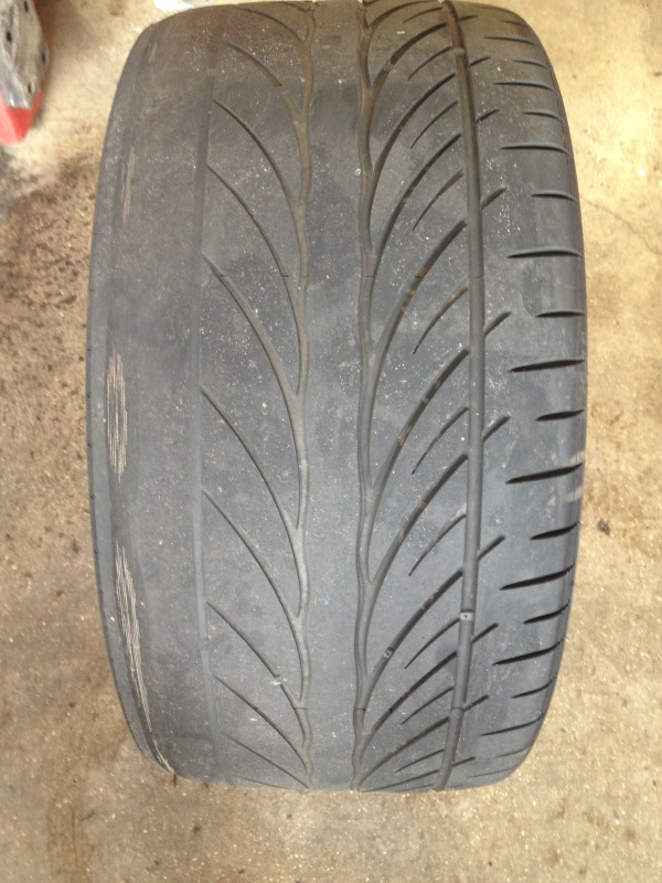

Here are some photos of mine. I didn't notice anything but when doing about 120 or so down the highway I would get this violent shake that seemed to only shake my back deck. So This is what I discovered....... This is about 20,000 miles or so. Notice how there is a bubble and metal showing but on only 2 sections of the wheel?
Attached Thumbnails Heavy thread wear after installing spacers???-dsc09093.jpg   Heavy thread wear after installing spacers???-dsc09091.jpg   Heavy thread wear after installing spacers???-dsc09095.jpg   Heavy thread wear after installing spacers???-dsc09094.jpg
Damn, I didn't have bubbles!
Ever since i added my spacers i have had a little shaking @ 70-80 mph, cant really tell if its coming from the rear or the front or both... and i don't want to take one or two off to see which one it is...lazy
New tires didn't change anything though, it still shakes. I was kind of hoping it was just the tires, but no
I think if you adjust the camber the shaking will go away. I have the same issue but I always drive 60mph or below or 90mph and above so it doesn't bother me. But I probably will take it in to have the camber adjusted a bit. I mean it is in spec but I'd like to have more tire on the pavement and see if I can get rid of the shaking. It's not really bad at all. I changed the rear control arms (2 per side) about 35K mi. ago and had alignment done after that. They were within spec so were not adjusted. But if you have AS it could be that it needs to be recalibrated too. This definitely plays a part believe it or not. Do not ask me exactly how, but i had an issue until i hooked it up to the computer and re-adjusted the AS. The one you do in the vehicle is not the same, that's just calibration.

Ur welcome glad to help... I think u should still get the alignment and reduce the camber..to 1%,,, it will lengthen the time before u have to rotate them. and the cars weight will sit more toward the outside of the tire,, it will make a huge difference on the tire wear....
Most of the time, when you add spacers, you get a vibration. This is due to the fact that the tire and wheel combo are balanced without the spacer. It is not because the spacer is unbalanced but most balancers, will aks for rim diameter, rim width, position of wheel weights, and a measurement fo the inner wheel lip, in relation to the machine's hub (or offset). The last measurement will always will wrong, since the spacers are left on the car and not on the wheel. The offset (last measurement) will be off by the size of the spacers. The thicker the spacer, the more noticeable the vibration is.
Unfortunately, most large tire shops (America's Tire, etc) don't even want to deal with cars that have spacers. They will work on cars with hubcentric spacers but not just spacers, but I haven't gotten them to balance the wheels with the spacers. Maybe, I should talk to one of their store managers.
I have to look for a place that will work with me in balancing my tires/wheels in terms of balancing it with the spacers.
I still think you should have your car aligned as that tread wear is not optimal. Or you can continue to watch it but at some point, if you are using directional tires, you'll need to have the tires demounted, reversed and placed in the opposite corner for even wear.
