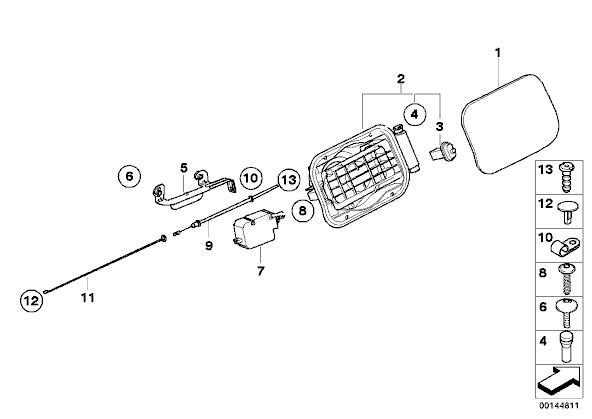

Last night after taking on fuel, I noticed that my gas door was having some trouble closing tightly. This morning I noticed that it was open and I tried to close it. Seems like the spring part that pushes the door open is not staying down once I attemp to close the door.
If someone has come accross this issue before please advise. Also any instructions to getting it fixed would also help. I've tried doing a search with no luck on this issue.
Thanks.

Check item #3. Should be spring loaded. Maybe it's stuck.
No. Description Supplement Qty From Up To Part Number Price Notes
01 Fill-in flap, primed 1 51177034281 $33.88
02 Cover pot 1 51177183712 $58.27
03 BUFFER STOP WITH EJECTOR 1 51178228939 $10.15
04 Plug 4 51177044256 $1.48
05 Support, centr.lock.syst.,fill-in flap 1 51177072202 $5.15
06 Torx bolt ISA M6X12 2 51248198651 ENDED
07 Actuator 1 67116988089 $71.84
08 TORX-BOLT FOR PLASTIC MATERIAL ISA L=16MM 2 51266914320 ENDED
09 Bowden cable, filler flap 1 51257066025 $12.99
10 Clamp 1 52101919476 $1.22
11 PULLING STRIP F EMERGENCY MECHANISM 1 51258234140 $1.78
12 EMERGENCY MECHANISM 1 51258234143 $1.35
13 Sleeve 1 51257075026 $5.05

might want to check the release thats in your trunk to make sure that its not holding the door open.

Yup just replaced the spring part (number 3 above) it was like 15 bucks or something

My gas door has done that a couple of times. I just use my finger to depress the spring and it resets itself. Just push down on the rubber grommet (3 above), and you'll feel it click back into place--kind of like an ink pen.
+1. although my problem was the door wouldnt spring open when pushed down.
