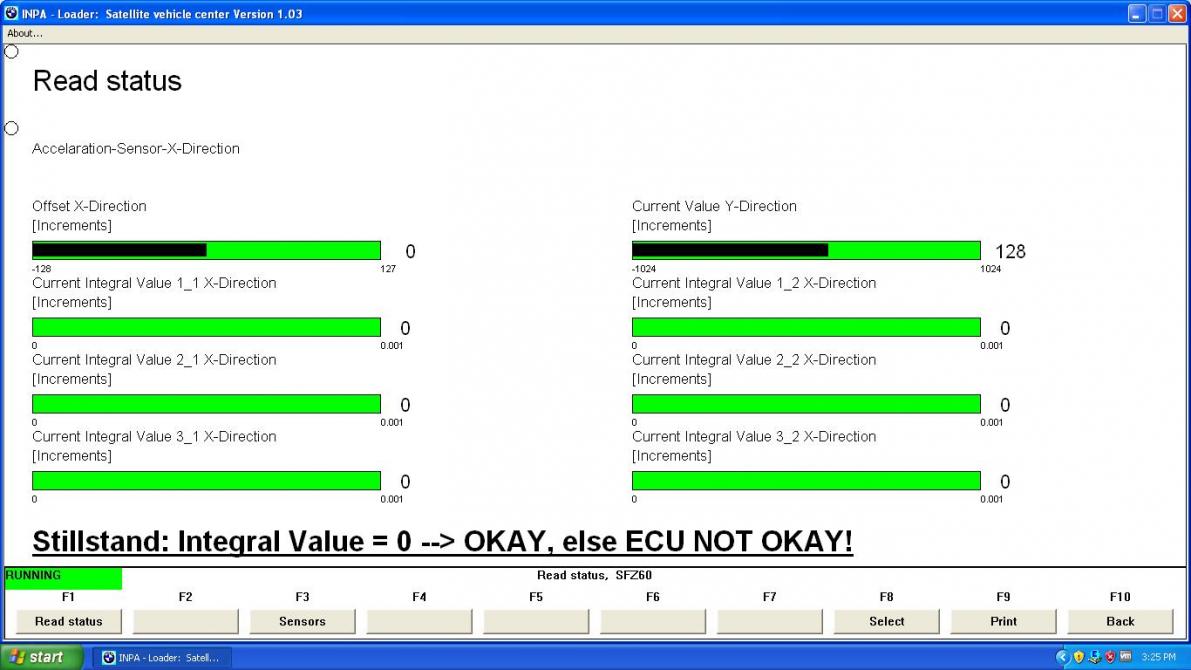

I have passanger restreint system mulfunction with this code
9AFF resistor detonation pill detonation circuit 2 big
Attached Thumbnails Error in vehiacle sattelite center-%7B7411acaf-576f-45b2-bb13-00e1662411a3%7D.jpg   Error in vehiacle sattelite center-sattelite-x-direction.jpg   Error in vehiacle sattelite center-sattelite-y-direction.jpg

The code means there is high resistance in the battery safety terminal firing circuit. In an accident? Change the battery lately? Check the battery positive terminal, in particular the 2 small gauge wires going to the terminal.
