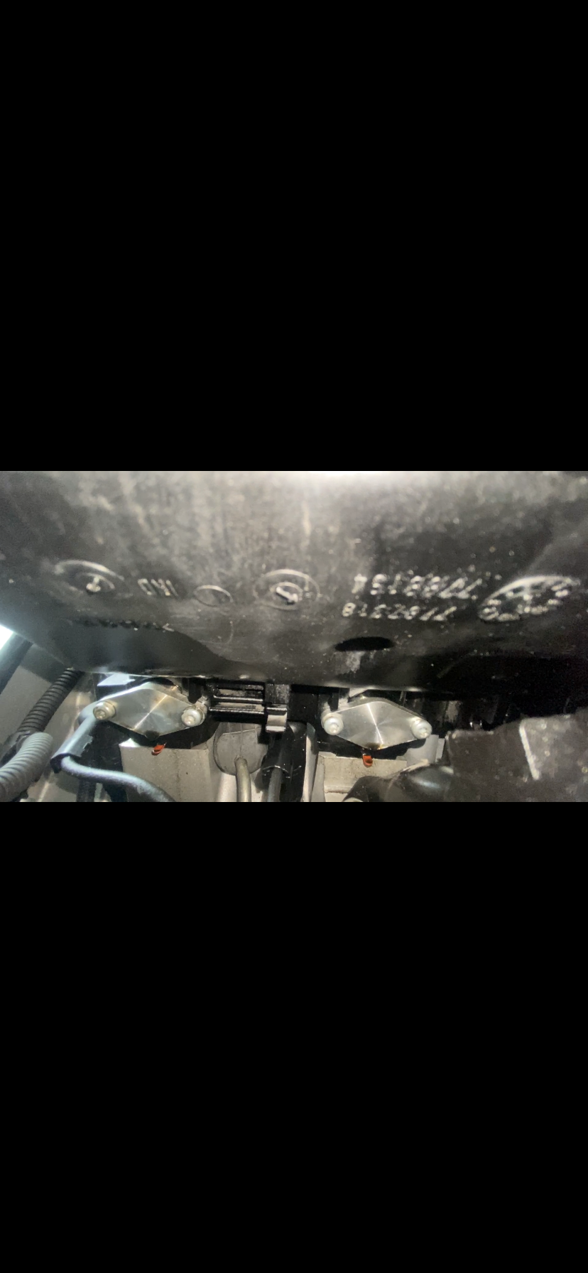

this is under the intake manifold
the shop told me that my vacuum pump is leaking too. i guess the oil is leaking onto the tstat as it seems. because I dont have any coolant loss but its moist there on the tstat housing

I removed my intake manifold one week ago and renewed the gaskets and cleaned the intake. Now seems like its the swirl flaps leaking. I deleted them with a kit long time ago and it looks like its leaking where the block off plates are.
any solution to this?

Try gasket maker to seal would be my guess

where exactly should i seal it
