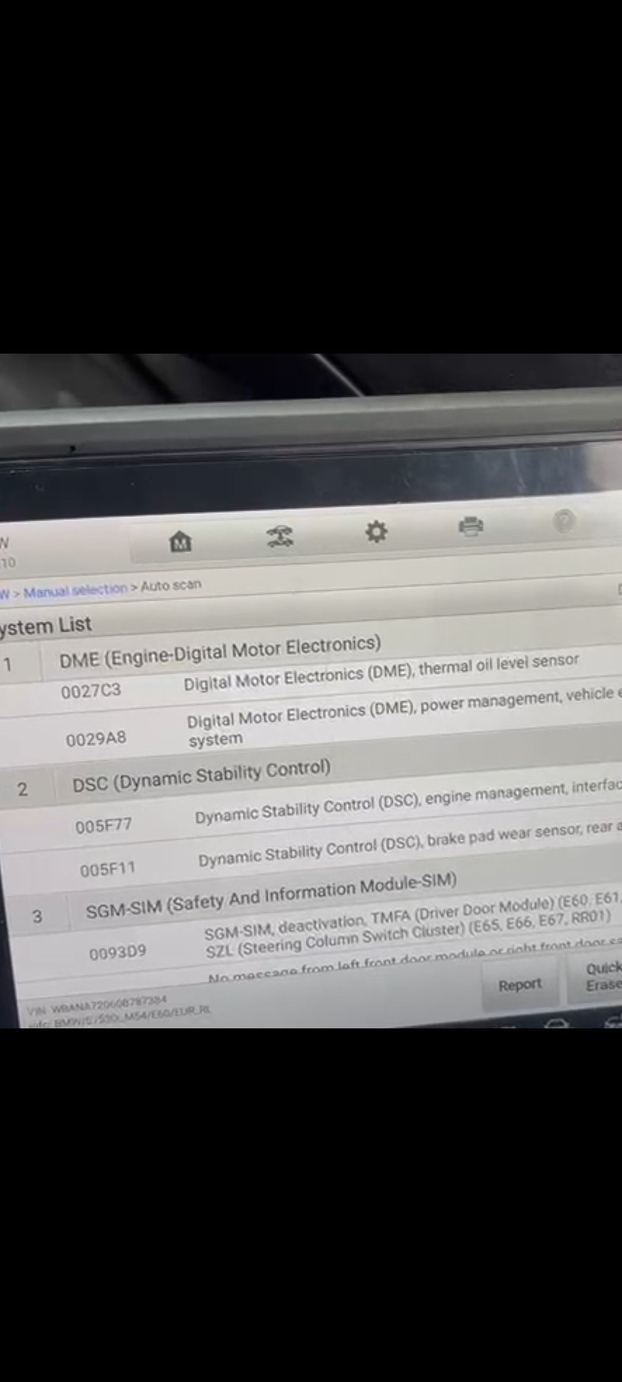

Originally Posted by donpb
First, read your codes using a BMW-specific code reader.
Hopefully the picture quality is readable

It looks like you purchased a project. You're not going to get any good help online with that many issues. You'll need someone local to assist you. Have you tested the battery and alternator? Hopefully that is what's causing some of the issue. We didn't get any history so everything would be as guess at this point

As I'm looking at the pics again it seems like you have some absent errors. Correlated a few by comparing the photos. Take a pic of the whole screen in the same pic so you can at least get valid responses
I will rescan the car and put up some latest codes as quite a few of them had cleared due to finding a broken wire in the driver door which in turn caused issues with the air bag and other stuff which is now sorted
