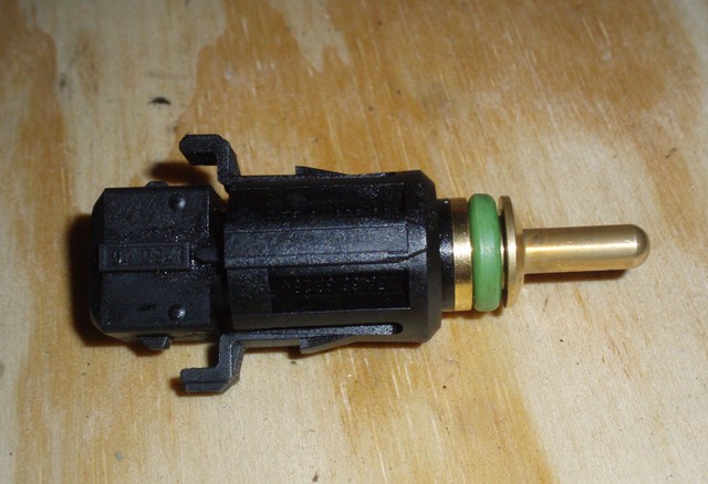

here comes the exact O-ring size data. i had to buy a new coolant temperature sensor the other day, and it arrived just now. the first thing is measuring it. the outer diameter is 14mm, and the thickness is 3mm, so the central circle is 8mm.
the new sensor:
now the old one(i borrow it from another thread):

to get long-lasting effect, i think , maybe 14mm(whole diameter),3.5mm(thickness) also work, and better.

Thanks. I bet its the same exact o-ring I had on my instake camshaft position sensor. It came with an extra o-ring so hopefully it is. Looks the same and BMW always uses exact sizes in other parts.

Just in case anyone needs to replace this o-ring it is #31 and a suitable replacement can be found at Home Depot or ACE Hardware.
