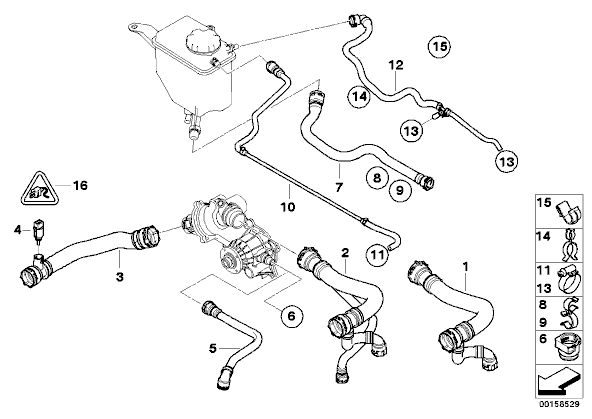

The hose is the one coming from the engine into the radiator it looks like, any idea if there is a DIY anywhere for what can be safely removed? Tbal what is TIS?
Edit:
The return hose is the problem.

I had the same problem a couple of months ago, yes i was out of warranty. Mine was the return hose (#3) on the diagram. I went ahead a bought the hose at the dealer, replaced it and the darn thing still leaked. I know i pushed the hose all the way with the clamps in perfect. One thing i didnt buy was the sensor (#4 on diagram) Went to the dealer again got the sensor, replaced it and it stop leaking. Cost me less than $100 for parts and i did the labor. The clamps are built in the hose, just use a flat head to release. It is pretty simple to do. Good luck.

Yep thats exactly what I need, thanks for the help guys! How much does the hose run at the dealer?
