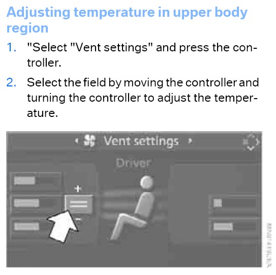

Originally Posted by rodybmw' post='498728' date='Nov 25 2007, 04:28 AM
That's not really true. I can get those vents to be as hot as the windshield and floor vents (really hot) by adjusting the iDrive "vent temperature" setting to all red lines with no blue and no white lines (I'm talking about the lines that the arrow is pointing at in the following picture). Note that this is NOT adjusted at the same time that you adjust the level of the mid vents. You actually have to highlight the mid vent setting and then PUSH the iDrive controller to the right. Once the lines are highlighted you can change the temp setting of the vent from all blue lines to a white line, and all the way to all red lines by turning the iDrive knob. If I remember correctly the maximum number of red lines you can set is 3. If that does not work for you then there must be a problem with the climate control system in your car because all red lines should make the air coming out of those vents really hot..
Attachment 41038
Yeah I know about the all red in the idrive and mine is fully up 4 or 5 bars on my car, and like i said i can force the hot air out of the vent by over riding the vent settings but only after extended idleing and playing with the dials and the hash marks can I get any sort of heat. So I do believe something is wrong, my hkra has been replaced once under warrenty so if this is the problem it should still be covered according to my SA
