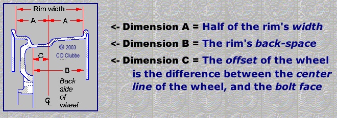

Originally Posted by Richard in NC' post='724579' date='Nov 18 2008, 05:42 PM
Per Wikipedia:
The offset of a vehicle's wheel is the distance between the centerline of the wheel and the plane of the hub-mounting surface of the wheel. It can thus be either positive or negative, and is typically measured in millimeters. Offset has a significant effect on many elements of a vehicle's suspension, including suspension geometry, clearance between the tire and suspension elements, the scrub radius of the steering system, and visually, the width of the wheel faces relative to the car's bodywork.
Zero Offset - The plane of the hub mounting surface is even with the centerline of the wheel.
Positive Offset - The plane of the hub mounting surface is shifted from the centerline toward the front or outside of the wheel. Positive offset wheels are generally found on front wheel drive cars and newer rear drive cars.
Negative Offset - The plane of the hub mounting surface is toward the back or brake side of the wheel's centerline.
In short it determines the clearance between the tires and fender and the suspension components. The wider the wheel, the more critical (the closer to factory spec it needs to be).
Here's a more "visual" exhibit.
