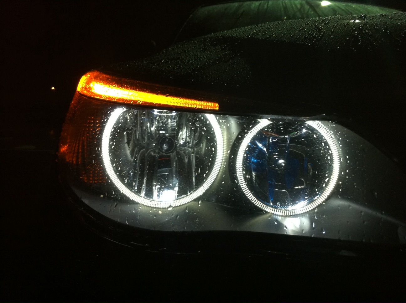

I know you can get T10 LEDs for the AEs if you got halogen headlights. I got them in mine, from ebay and no errors on dash, canbus version. But its hit and miss if you go for the chinese crap.
As you can see from attached pic they're nice at night but in daylight, not as visible.

I bought these ones here.
You need 4. 3 worked fine and 1 was giving error so I ordered another set of 2 which fixed that. Depends on your luck
Make sure you start engine all the way to make sure the errors clear if you get any.
