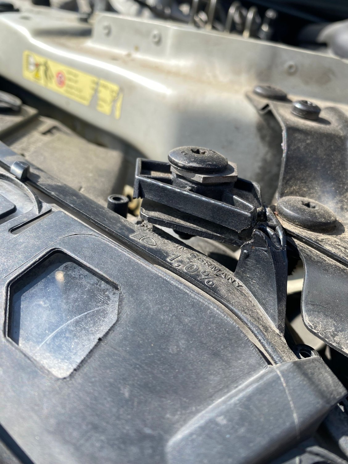

Hello I was wondering if somehow I can fix this headlight mount? Can anyone explain to me. It broke off and now my headlight is moving

It's a UK auction, but would this sort of thing help?:

yeah I saw this one it's probably it I just dont understand how to mount them haha I cant find any videos of it and it looks kinda different than the one on the headlight

I think you use 2 self tapping screws to screw it into the holes either side of the broken clip. You can see the holes in your photo, to the left and to the right.

Yes, that repair part is a legit BMW part.
#18 in this diagram. Put in your car info and make sure it is the same for your car.
https://www.realoem.com/bmw/enUS/sho...diagId=63_0799
