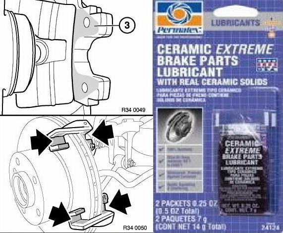

Engine: N62
Originally Posted by wasupdu' post='896974' date='Jun 1 2009, 01:05 PM
... but one of the mechanics applied a brake glue of some sort to the pads and they've never made a noise since (15,000 miles or so).
BMW AG - TIS 01.05.2007 10:20
Clean contact face (3) of brake caliper and apply a thin coating of antisqueak
compound.
Clean brake caliper mounting bracket at hammer head guides and
apply a thin coating of anti-squeak compound.
"Do it right the first time."
