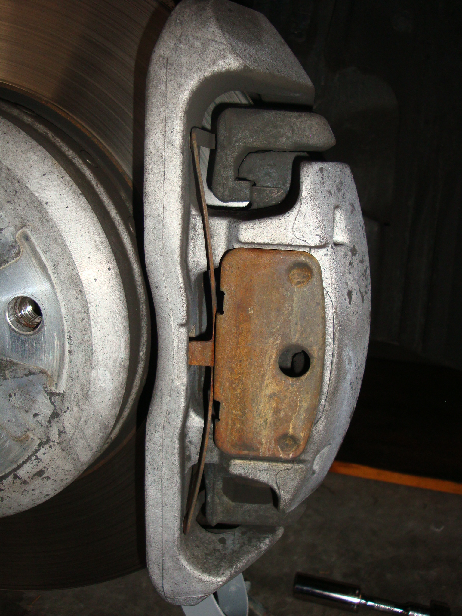

Originally Posted by luigi524td
Could be ... my e60 is a '07 530xi. So, your 545 has brake discs that are riveted/fastened to an aluminum hub? Would you mind sharing a picture?
I found a pic of my 545 OEM rotors and they sure had the rivets. Frankly I was surprised to see rivets on the hat portion myself. Here you can see 3 of the rivets
