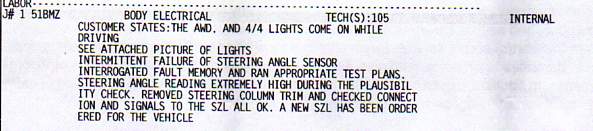

Originally Posted by gerrypd
This means you have a low battery charge. Turn on the car and turn your steering wheel all the way to the right and then turn it all the way to the left. This will reset the system.
Maybe not ...
Attached Thumbnails AWD and DSC Malfunction photos-530xi-awd-fault001.jpg   AWD and DSC Malfunction photos-awd-fault_b.jpg   AWD and DSC Malfunction photos-awd-fault-medium-.jpg

I don't have an XI, but I had those errors on mine and the SZL was replaced. No errors since.

Mine did the same thing on New Year's day. Dealer replaced the steering angle sensor under CPO warranty. No problems since. Does anybody know how often these things go bad?

+1. Mine did that almost a year ago and I'm still on the same battery. Also, it would pop up intermittently while the car is already on. Replacing the Steering angle sensor (aka SZL) fixed it.
