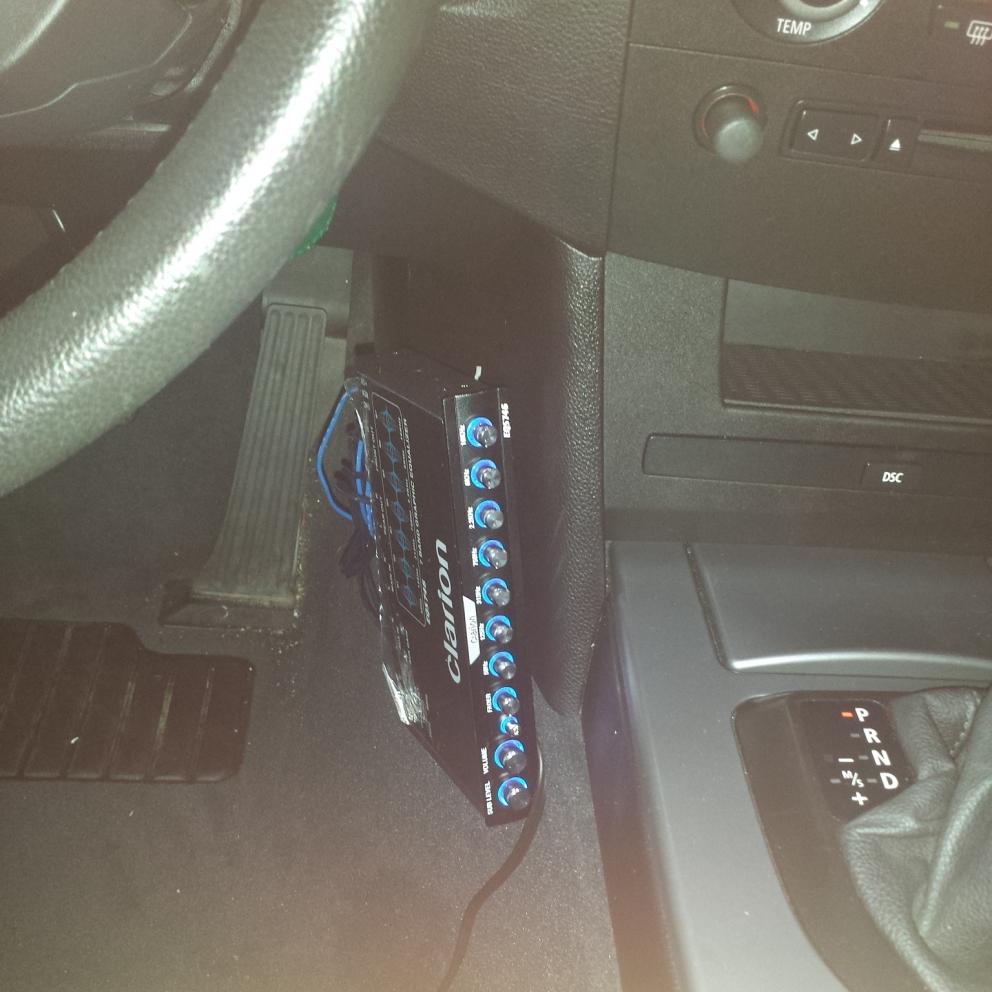

i wouldn't go with that setup using just 1 amp to drive voice and power speakers your best run is a 4 channel for door speakers and a mono amp for your subs if you want a clean cut sound with lots of bass that what i did with my 530i but your setup don't cost much that is the easiest way out a 5ch amp to power everything. if you want bass from that trunk that's so sealed you gotta get a killer amp with some nice subs i heard JBL's are real good you wont loose parking sensors . i did my cars sound system all by myself gotta tell you tho use the best quality of RCA's and In-Line Converters or your going to get alot of static feedback cheap wires= worst sound.
My Setup
Equalizer->Crossover->4ch amp-> Door Speakers
|_>Mono amp> 12'' Kicker Subs
i haven't changed my door speakers as yet will do tht soon
Attached Thumbnails Audio Setup for BMW E60 520D 2008-img_20140716_203145.jpg   Audio Setup for BMW E60 520D 2008-img_20140716_203224.jpg

i used Clarion EQS746 Equalizer
Cross-over Hifonics HFXR
4Ch amp Hifonics BRX640.4
Mono Amp Hifonics Mt Olympus 6000w
going to upgrade with a 2 farad capacitor and 2 amplifier fans to keep the amps cool for long high volume plays. add condensers to your voice speakers and tweeters to avoid getting a blown speaker you can add them to your sub too if you have a very powerful amp

I used a line in converter/ speaker wire to rca and connect it to the front speaker wires left and rite so I can get the main input to the Eq thats all u need to do. So my factory amp is no longer playing my door speakers they're all disconnected and powered by the amp I install to play voice, I had to take the door covers and door sills off take out the back seat and run fresh wires from the amp I installed to the door speakers
