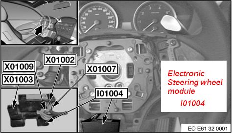

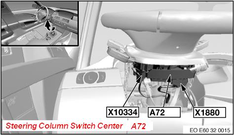

Originally Posted by pjinca
Hmm, wonder which fuse controls only the steering wheel buttons? Interesting, I'll have to check
F28, 20 Amp, in the fuse block behind the glove box powers the steering column switch center which in turn powers the electronic
steering wheel module actually located in the steering wheel. Does the horn work? And the lights behind the buttons?
Be mindful of disconnecting the airbag if you have to go deep!
Hopefully Rudy's reset will do the trick
