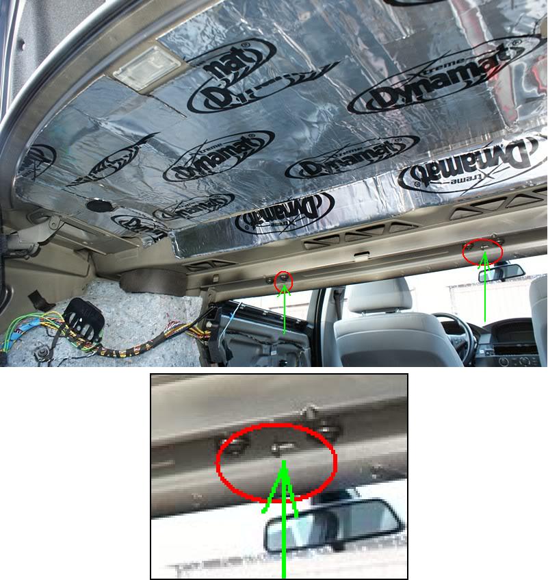

Ok. Well, then you could make the hole in the base panel bigger so that you can put your arm through it. With a screwdriver you could try to unlock the two little clips in the roof of the trunk. The clips hold the upper edge of the back rest in place. Then you would be able to remove the backrest and crawl into the trunk and try to work with the trunk lid.
I'm searching for the pics showing the two clips...
- Antti -
edit: Pic

GREAT LOOK!
So, any idea how hard it will be to get the clips undone? Would I be able to do this one-handed not being able to see anything? Remove carpet?

I think you would be able to do this without seeing them. The clips are just a bit tight, but trying to move them with a screwdriver you will understand into what direction and how you need to move them. You will notice when a clip is released.
