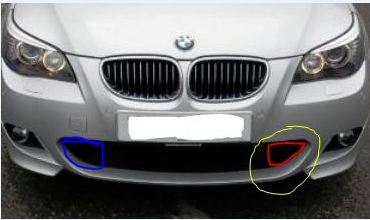

I have one last question (for now), which I hope you dont mind me asking. When I inspected the car I noticed that as per the image below (highlighted in red) there was a triangle shaped tube leading upwards into the engine bay, which I guess relates to the intake. that was rattling around inside the bumper. It looked to me like it had simply popped loose of the clip it locks into, on the bumper. The dealer I bought from said they would check it out for me. I had a look underneath and saw some expected scrapes to the underside of the bumper. Am guessing that the previous owner went over a speed bump or up a ramp a little hard and knocked it out place. Is this anything to worry about? tried to find the part number online but I couldnt.
The other side (highlighted blue) was different, just looked like an angled black blanking plate. Rather than an intake or tube like the red side. This is a RHD car
I would not worry about that bumper so much. Just check if the car has/had Night-vision and active-cruise control, because place of their sensors are just in those 2 corners you marked on pictures (red/blue). If you suppose to have it and you dont see there anything like black bulge in each corner - the car was crashed, or someone stole it (both of them are quite expensive and might have value for some junkies...). Otherwise there are normally holes for fresh air which goes to help brakes to not over-heat. Its made from few plastic pieaces - you can buy them from BMW dealer.
I checked with BMW UK, no night vision or active cruise so nothing missing in that respect.
Interesting feedback about the bumper. I have a feeling one if the blanking plates is missing. (the one on the RED side).
If you go here:
http://www.realoem.com/bmw/showparts...52&hg=51&fg=15
I think that the part I'm going to need is either:
07 Dummy plug left ACC2 1 03/2007 51117178105
- Or -
05 Air duct, BKS, left 1 03/2007 51117178111
The part that was loose which they've now fixed is:
02 FRONT LEFT BRAKE AIR DUCT 1 03/2007 51117178085
Thanks!
Adam
