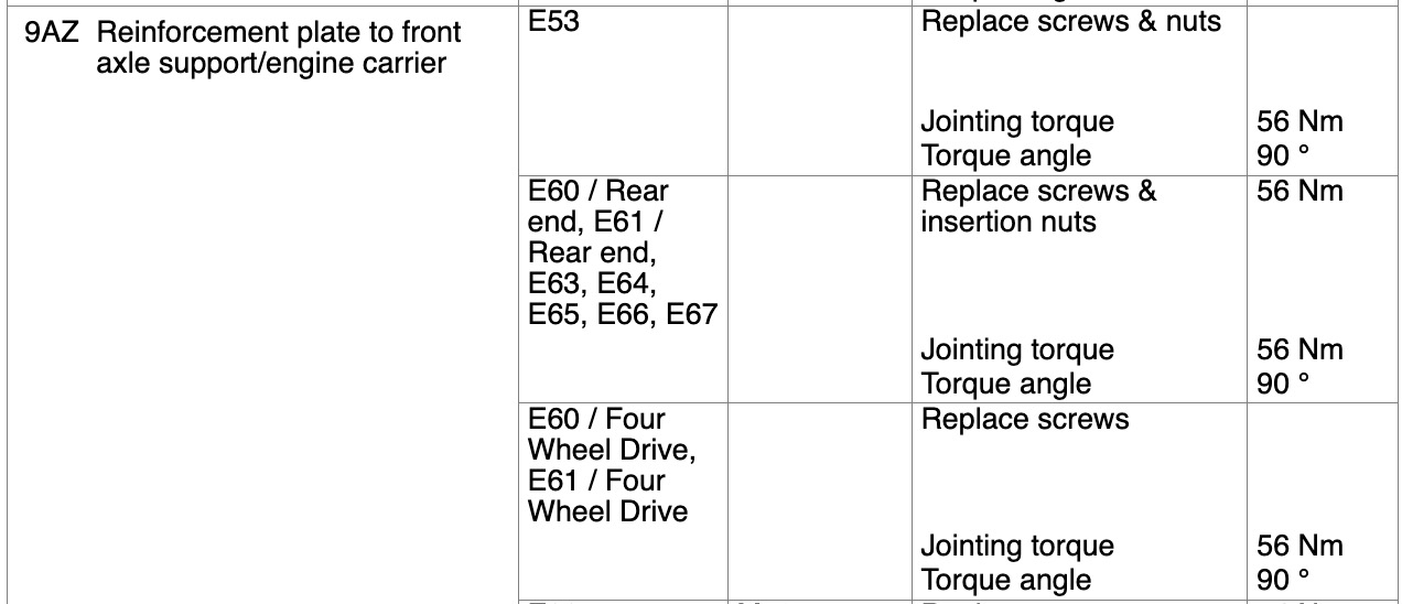

Been under the car collectively for at least 45 minutes now while the missy turns the wheel. Got it down to the front subframe where aforementioned control arm bolts up to. It seems to flex in a certain way when the car turns or is on uneven road. My question now is i'm sure BMW is aware of the issue. I wonder what the procedure for this would be. I don't think the subframe bushings are shot as it's a faint noise. not something super constant.

turned out to be subframe reinforcement plate

Just checking that you got new bolts. The reinforcement plate uses one time use torque to yield bolts. First you use the torque wrench and then you do the additional angle listed. This stretches the bolt and attains a tighter connection, but since the bolt is now deformed, it cannot be reused. Most all of the aluminum bolts are this way and a handful of steel ones such as these.
