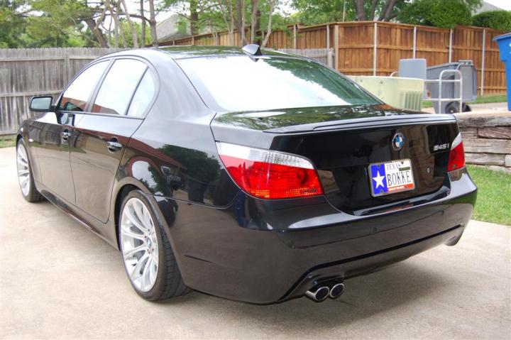

Added the 166's about 2 months ago and went with the 275/30's in the rear.
Go with the PS2's, I had the Goodyear's on my E39 M5 - the Michelins are a much better tire!
check out the link: http://forums.e60.net/index.php?showtopic=39303
