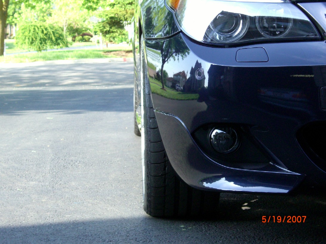

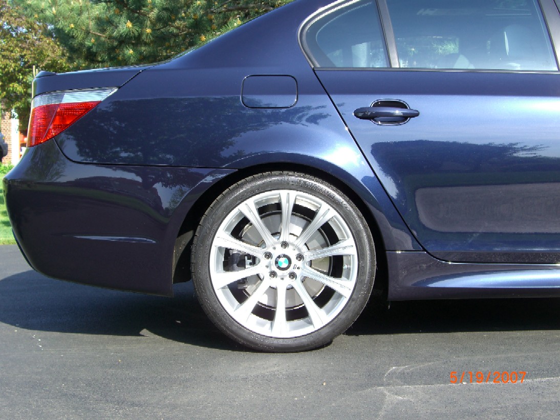

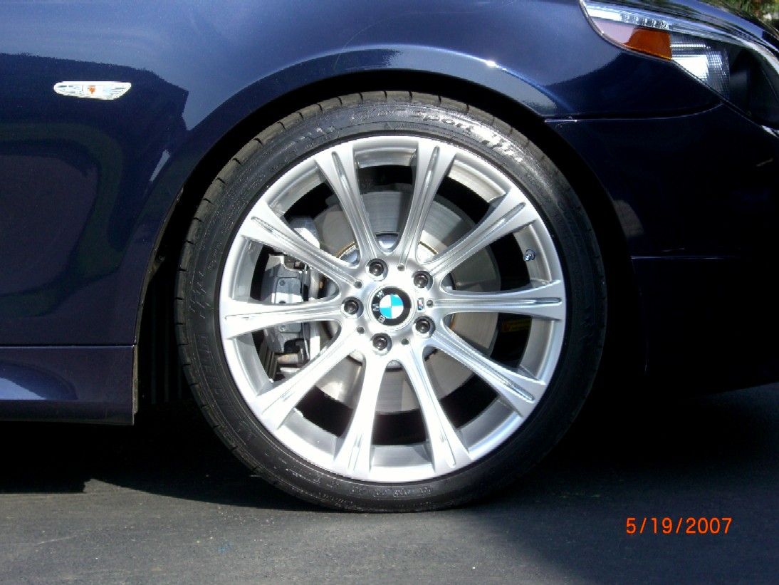

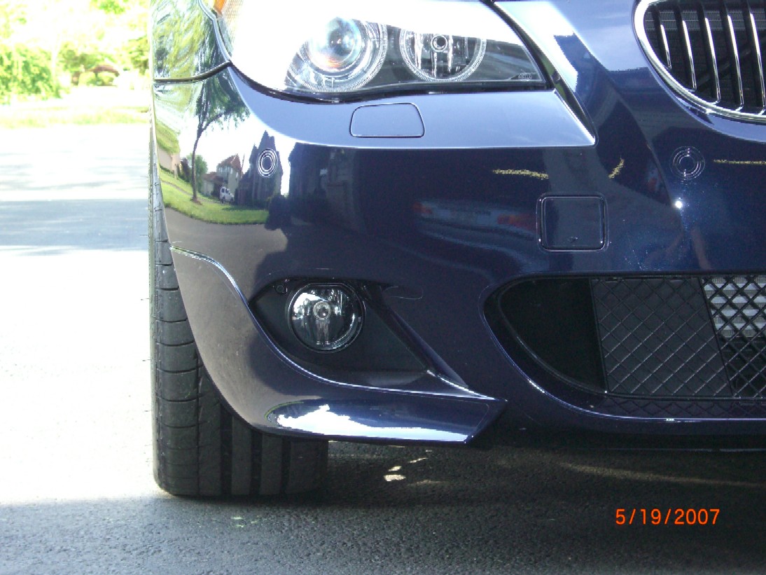

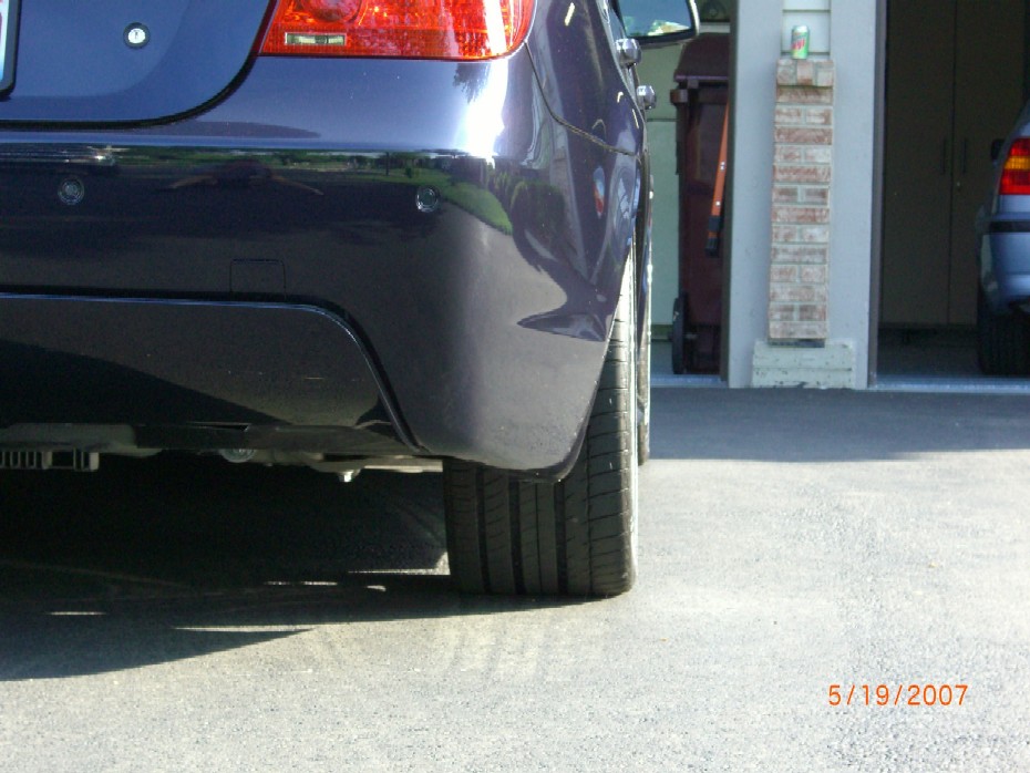

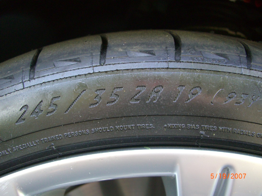

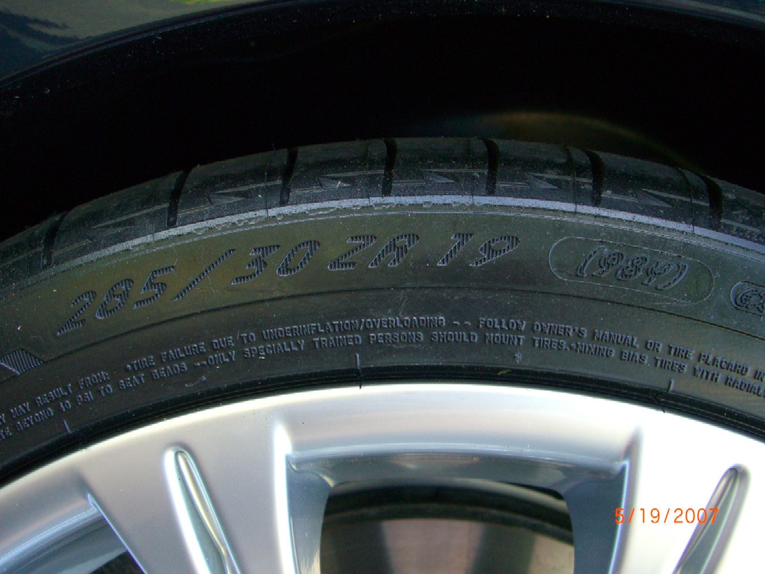

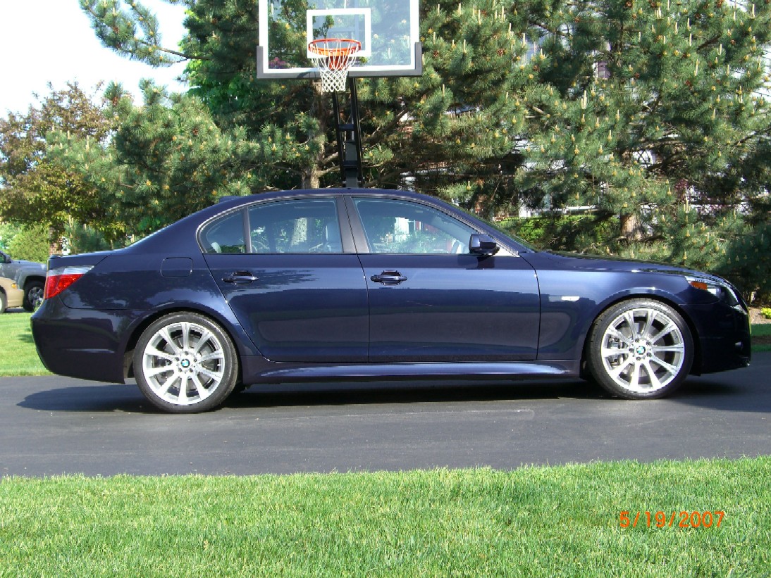

Attached Thumbnails 166 Wheels being installed on Saturday-side_view_of_166__s.jpg   166 Wheels being installed on Saturday-front_wheel_well.jpg   166 Wheels being installed on Saturday-friont_view_2.jpg   166 Wheels being installed on Saturday-rear_wheel_well.jpg   166 Wheels being installed on Saturday-rear_view.jpg
166 Wheels being installed on Saturday-245__s.jpg   166 Wheels being installed on Saturday-285__s.jpg   166 Wheels being installed on Saturday-front_view_1.jpg

285s look great in back. Good move.
Thanks,
Do you notice much of a difference between the 275's and the 285's?
Have you posted a pic of yours at the same angle?
Old May 25, 2007 | 06:26 AM
  #29
Ricracing's Avatar
Posts: 7,790
From: Helsinki, Finland
There's not much of an differance between 285 vs. 275/30's but why go for the 285's when BMW recommends the 275's?
It will change the ratios and mess up the car's intelligence.
All this, but only slightly.
Old May 25, 2007 | 06:39 AM
  #30
Veight's Avatar
Posts: 1,318
From: Gurnee, Illinois
The 285 /30 19's are closer to the original 275/35 18's in circumferance.
The 285/30 19's are 2053 MM in diameter while the original 275/35 18's are 2041 MM thats only .59% off of original.
275/30 19's work out to be 1948.35 MM that is 4.77% off of original.
The cars intelligence will be more off by the 275/19's than the 285/19's by over 4%. The 285's are almost exactly the same diameter as the 275/18's.
The only issue would be the wider tire which doesn't rub in the wheel well anyway.
What other ratios and intelligence are you talking about here?
