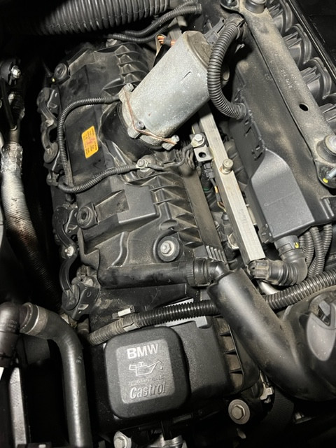

Old Dec 6, 2022 | 08:20 PM
seanjordan20's Avatar
Joined: Jul 2011
Posts: 3,953
Likes: 361
From: Augusta, GA
Engine: 3.0 B58; 3.0 M54
Seems only the driver side has the valve. Attached is the pic of the cars who does not have the valve on the right side

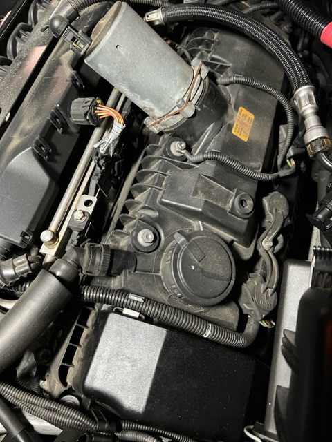

Old Dec 6, 2022 | 08:22 PM
Joined: Jul 2011
Posts: 3,953
Likes: 361
From: Augusta, GA
For the 06 to early 07 they use a vent pipe on the right side.
