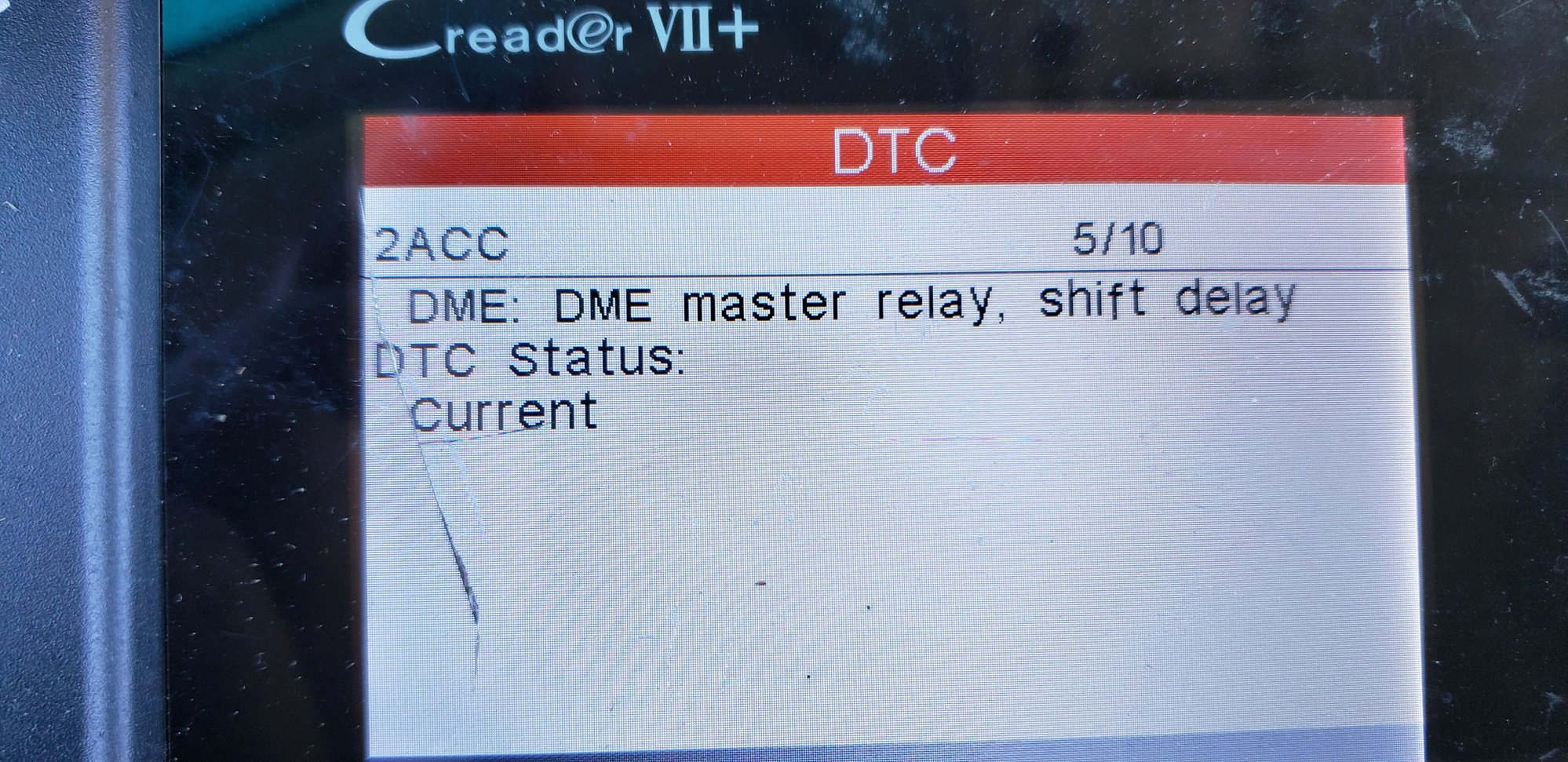

So this new to me 08 535xi cranks but no start.
it will fire on starting fluid. Codes 2ACC,2ACB 2E85,2E83,2E98,2E98
looks like a fault in the fuel system ignition system
There was a new pump in the car so i installled it as well as a new filter. Scanner pressure 6108 hpa fuel rail 17540hpa so there fuel ready
. Tested the old pump (works) darn.
So i found the DME location and found a mess, mice had found there way into the box. So i cleaned it all out liquid taped the chewed wires and cloth taped them up. Found a blue relay in the box i here it click. So its doing its job. Still the same no start. The injectors are not pulsing , no fuel, so thats next.also no spark.
So i have to keep at it.
any help suggestions would be great. I dont have any bmw style scanning tools as yet but i may have to visit getting one. I have the older creeder scanner so that is giving me basic info.
thanks Pat

So the DME connector was corroded , not alot but some white corrosion and green on a couple connectors so i cleaned the dme connector with detox it liquid and contact cleaner. Sprayed inside , blew it out then applied (detox it) inside the connector and let it sit for a couple days. Then sprayed it out with contact cleaner and then air. Put detox it on it again for a couple days then repeat it. Well still didnt work . Cranks no starting. Any help?

So ive tried not to use the parts cannon. Ive checked and tested so many things in the car. I have a creader scanner that reads dcts even the bmw code that i can see. It does not read some things im sure. I tried to figure out what program /cable i need but not much help from bmw sites. So i struggle through reading everything i find.
