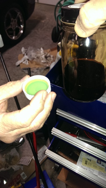

Well after having gone back and forth whether to service the transmission or not, I finally decided on members recommendations here that the fluid change was in order,
With 125,000 highway miles, I started feeling the transmission was after all not as smooth as it once used to be. The over drive gear had started jerking from time to time.
Today, my trusted Indy mechanic drained and replaced the transmission fluid.
I am happy and relieved to say, once again, the car feels and drives as it used to be.
Please find attached a picture of the fluids (current and the new one)
