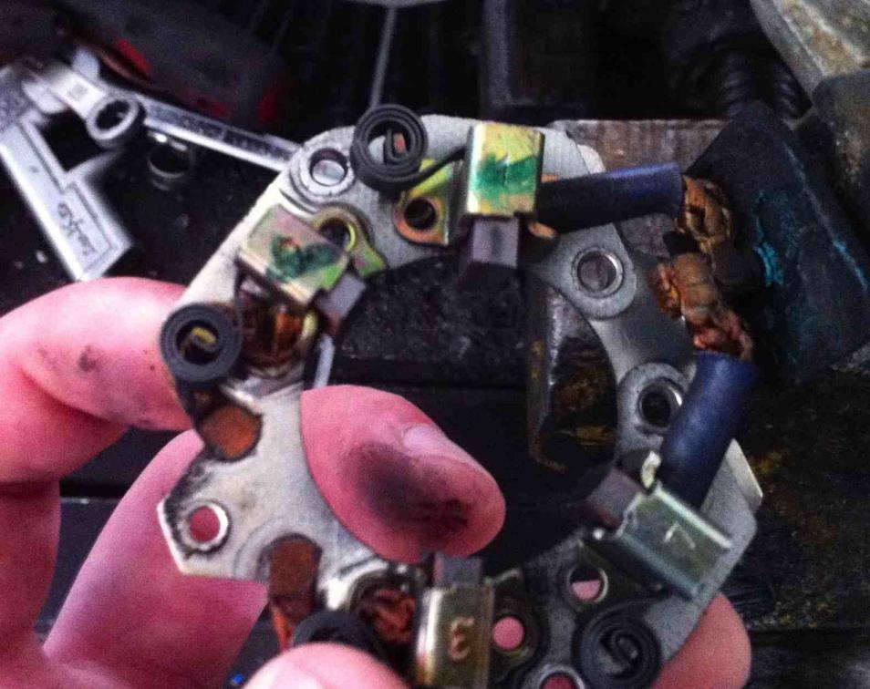

Hello ,
Check the starter - I had same symptoms.I have replaced only the starter's "coal plate" - check the picture. It is easy to check : try to punch the starter with hammer (use a long & strong screwdriver to reach the starter from engine compartiment and hammer on it ) .This should unlock the coals and your car will start...any way this is only a temporary mesure. You have to replace the "coal plate " ( should cost less than 50 usd ) or you can buy a new starter...
I mention also that is no need to take out the intake manifold ( at least on N52 engine) . It is difficult to reach all the screws but not impossible - you need some skillful mechanic...

coalplate.... hmmm are you talking about brushes in the starter motor?
also, replacing starter [on N52 engine] without removing intake manifold? really?
