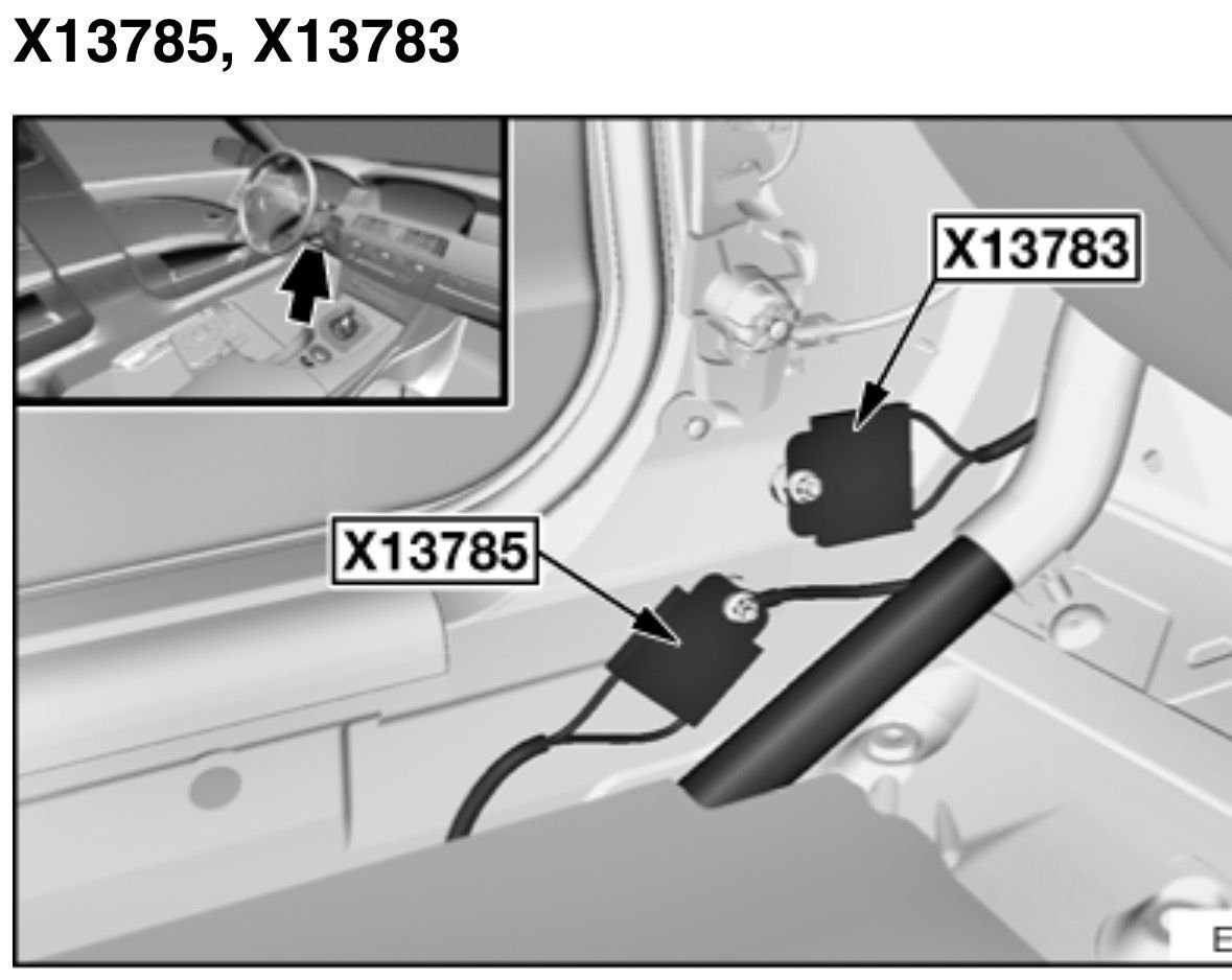

You checked the IVM and connectors in that box. Pay attention to pin 15. Probably the whole X6009 connector is bad or maybe x6021. Youre issue is definitely electrical from what I'm reading. Just need to find the bad location. Also check the X13783 connection. Its under the driver kick panel.
