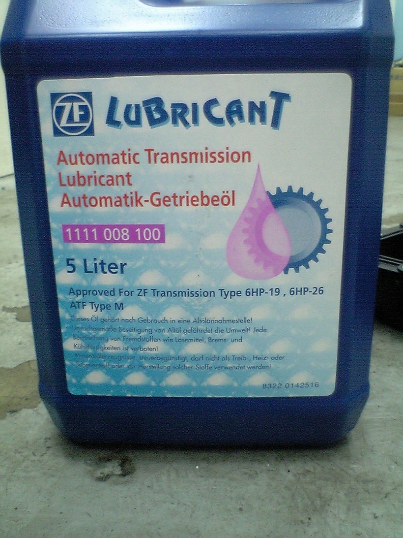

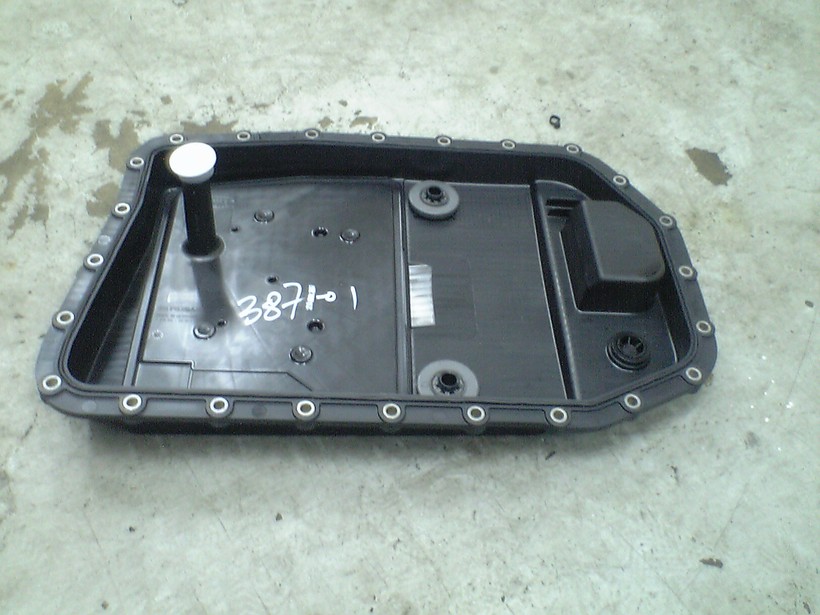

did my last year at 45000km
Attached Thumbnails Tranny Fluid Change-001_tray.jpg   Tranny Fluid Change-003_gearbox_zf_oil.jpg
Thanks for the closeup photos.
How much did you spend for ATF and oil pan?? are they OEM dealer parts??
Thanks.
Old Feb 22, 2009 | 02:56 AM
pinguhk's Avatar
Posts: 21,274
From: Hong Kong
My Ride: Mini Cooper
Thanks.
total $320us
yes the are BMW parts
