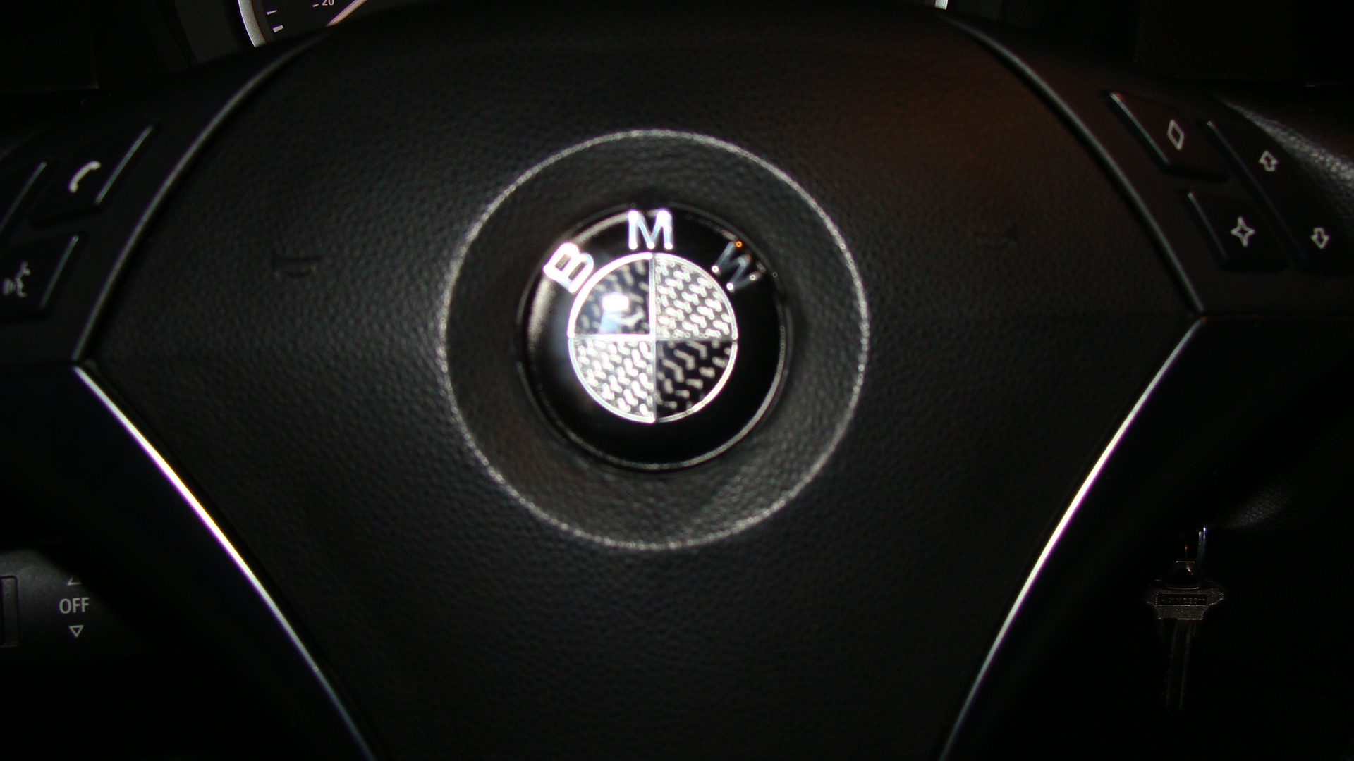

Here is an image of how it turned out...everything looks good and is intact. The integrity of the the airbag was not affected.
