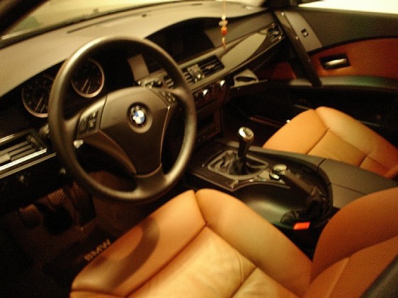

geezzz thas a lot of work....should I even replace it with titanium trim?
attached pic
Attached Thumbnails Interior Trim pieces - how to remove them?-1720804011.218217576.im1.02.565x421_a.562x421.jpg
