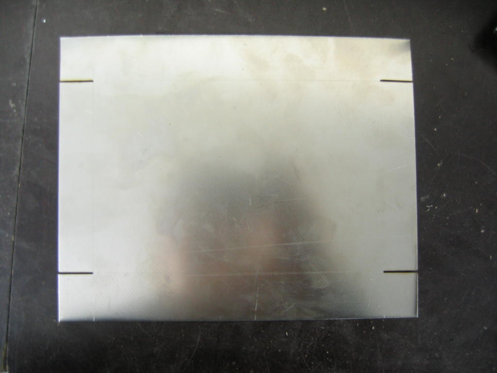

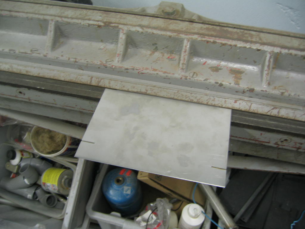

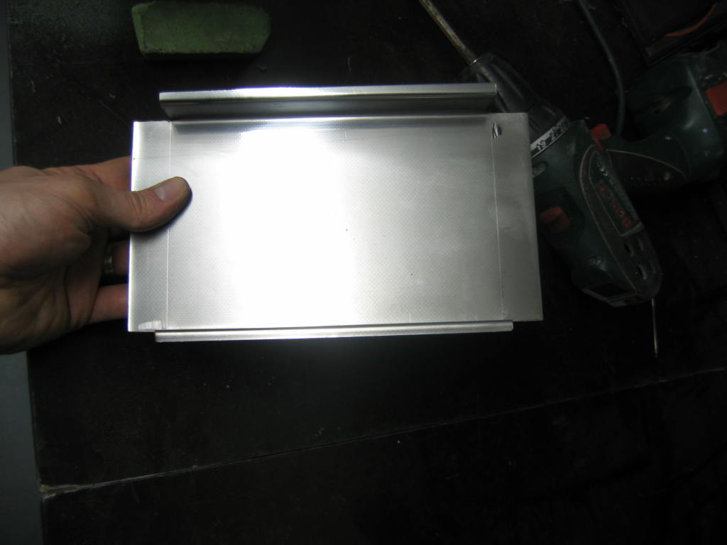

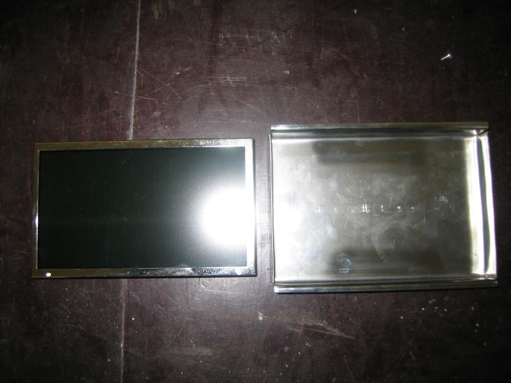

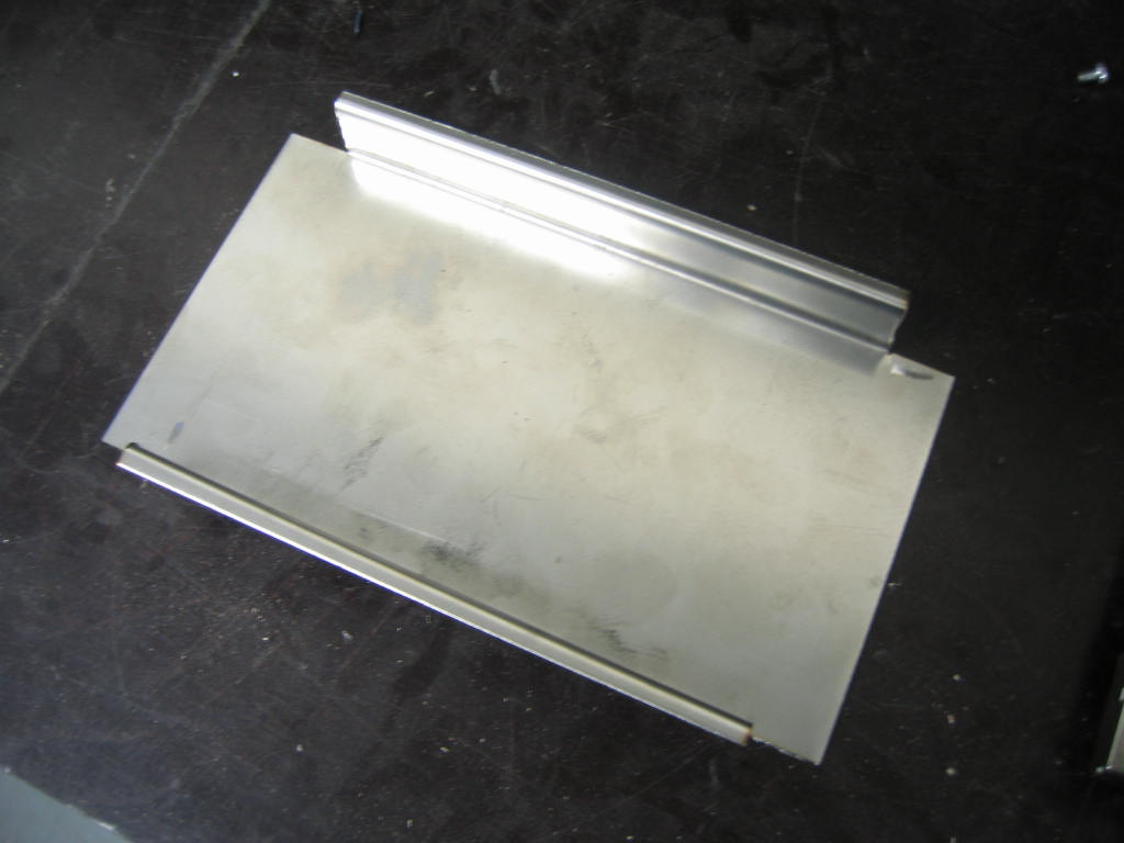

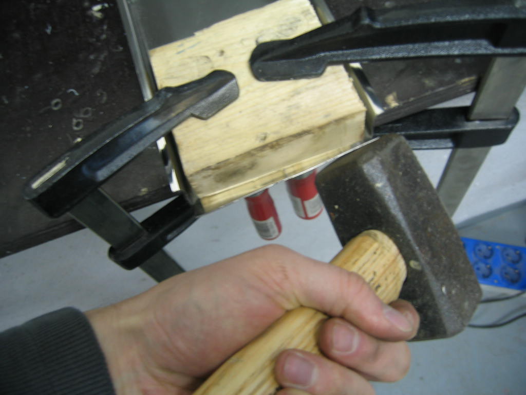

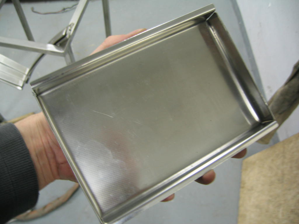

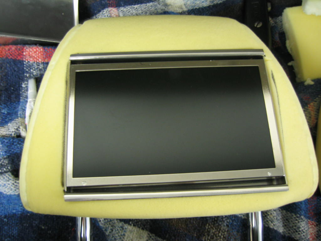

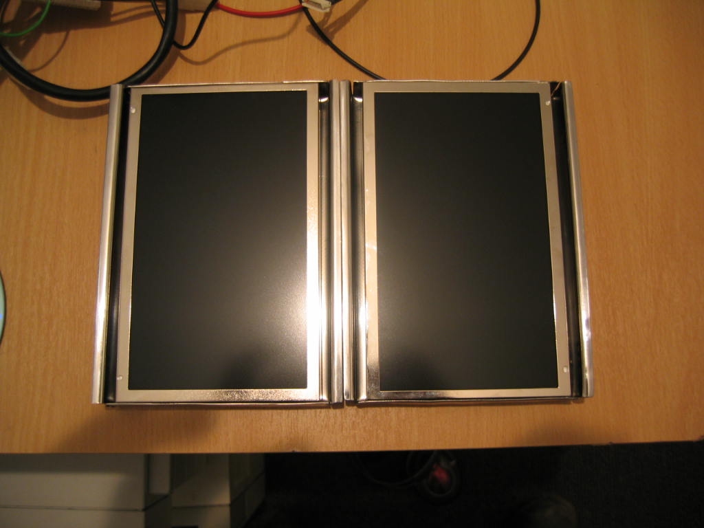

Because I got the dispays through my work , I started to create my own rear seat entertainment system.
The displays I used are normally sold to car manufacturers, at my work we were developing a navigation system for cars, and we used these displays as samples. After the project stopped I could buy them for 10 euros.

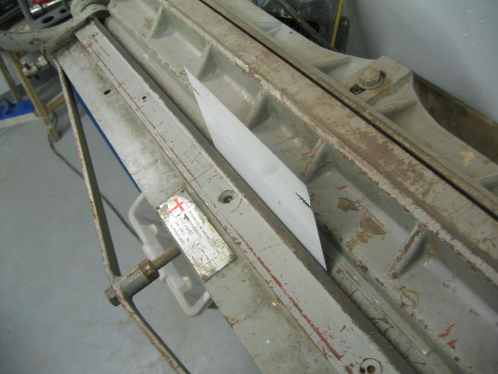

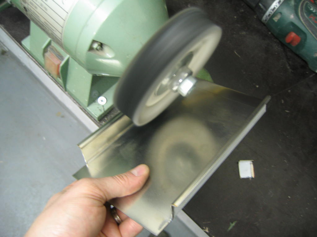

The displays were without any mouning rack, so I had to create me a own mounting rack from stainless steel

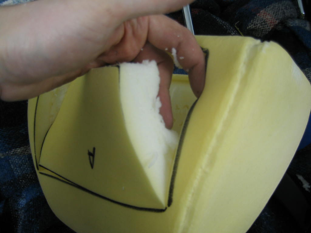

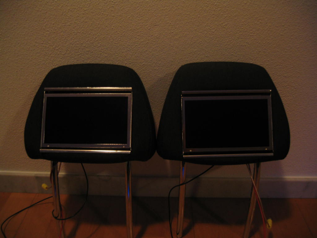

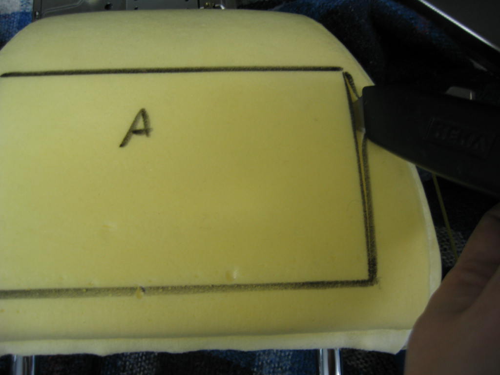

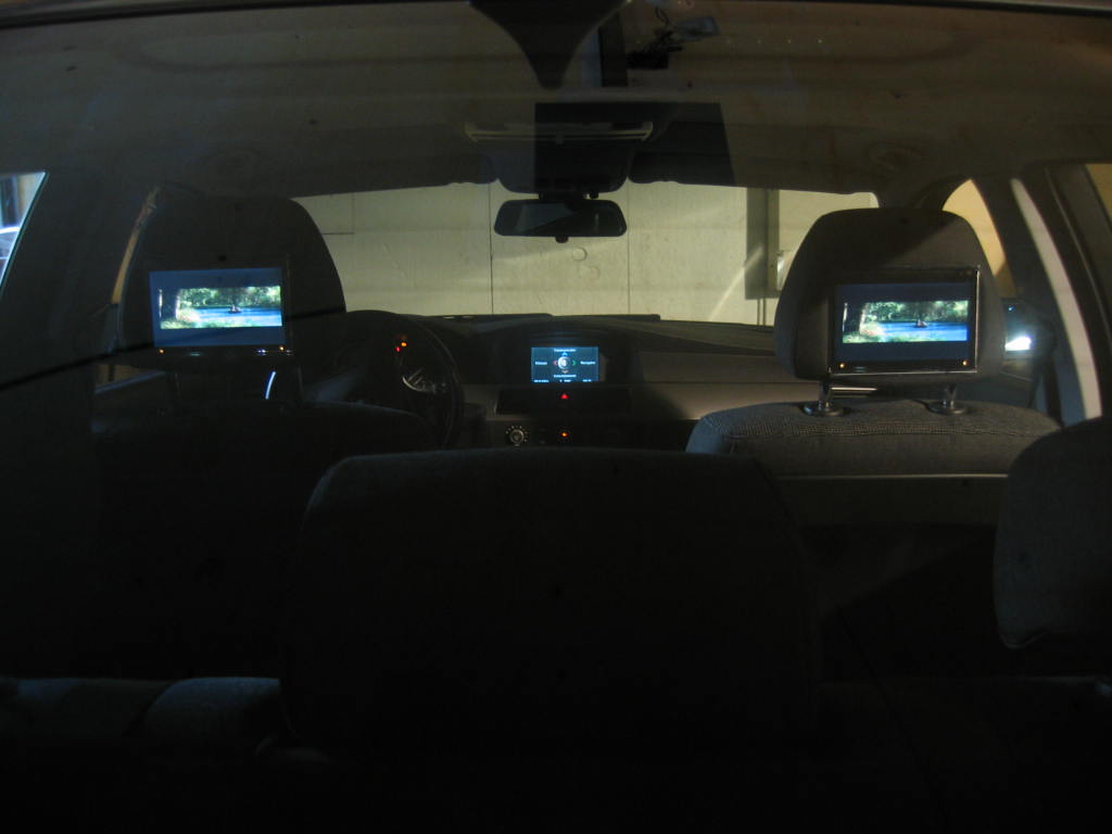

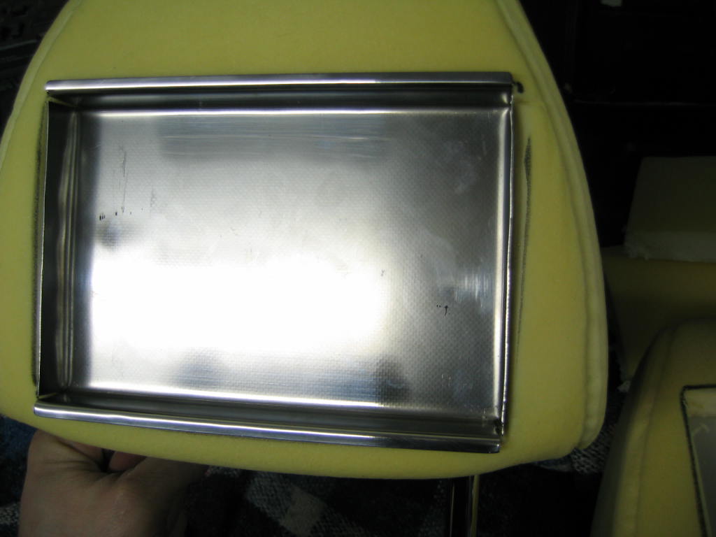

And these are the headrests:

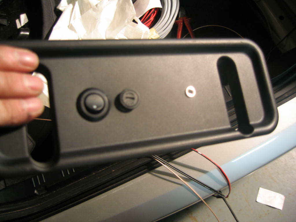

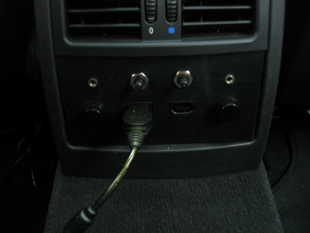

and this is the panel under the headrest, I installed a fuse and a switch to switch the display on or off
After installing the headrests and the cables from the lcd, I guide all the cables from the headrests trough the seats, carpet to the boot of the car.

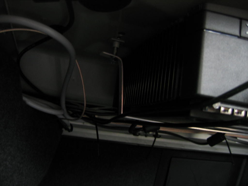

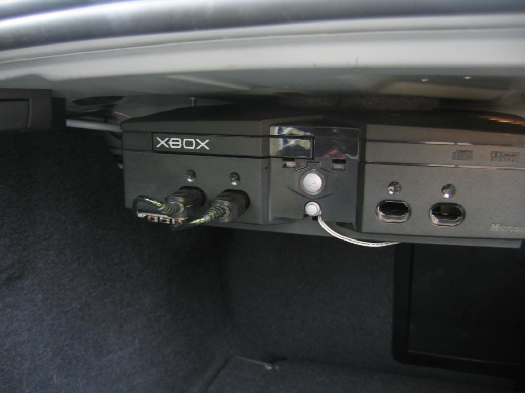

This is the place where I mounted my xbox.
There are already two screw-holes where you can mount your xbox on.

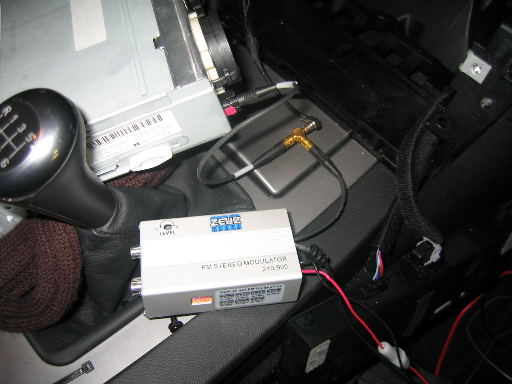

The audio of the xbox goes to a fm-modulator (situated behind the radio with smb connector)
read this for more information :http://forums.e60.net/index.php?showtopic=23305

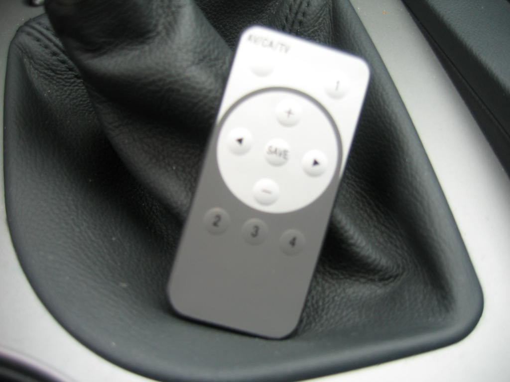

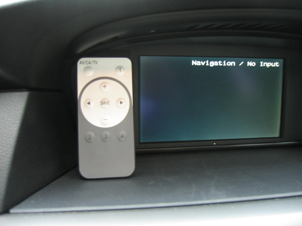

for the idrive lcd, I used a interface module from euro-navi-systems:
Installation of LCD screens in the headrests-24_0_e60_video_interface_1_.jpg
for orders mail this guy:
don't try to call because their english is very very bad, but if you mail them, the english is good
euronavisystem@kornet.net
Just ask for the "E60 interface module"
http://euronavi.co.kr/
Price of one unit is 300 USD he ships world-wide. The quality is very good of this interface, its housing is in aluminium, so there is no interferance, you will recieve a remote control with the unit

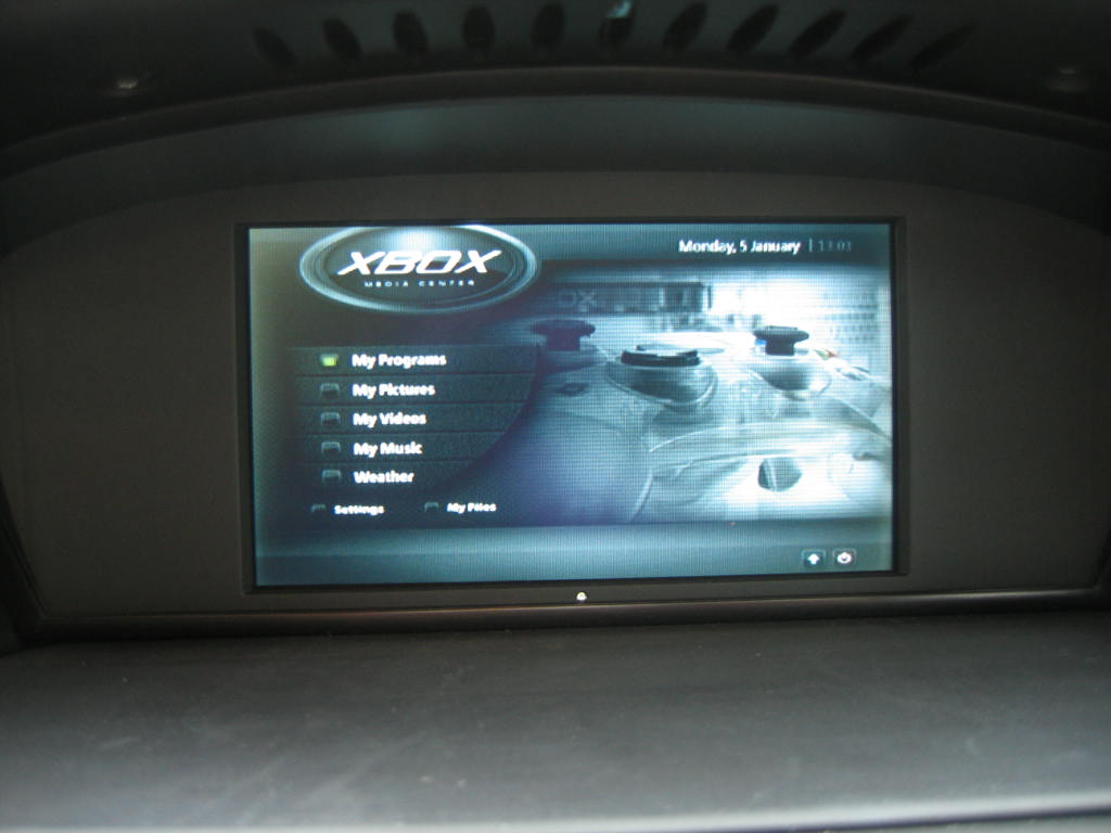

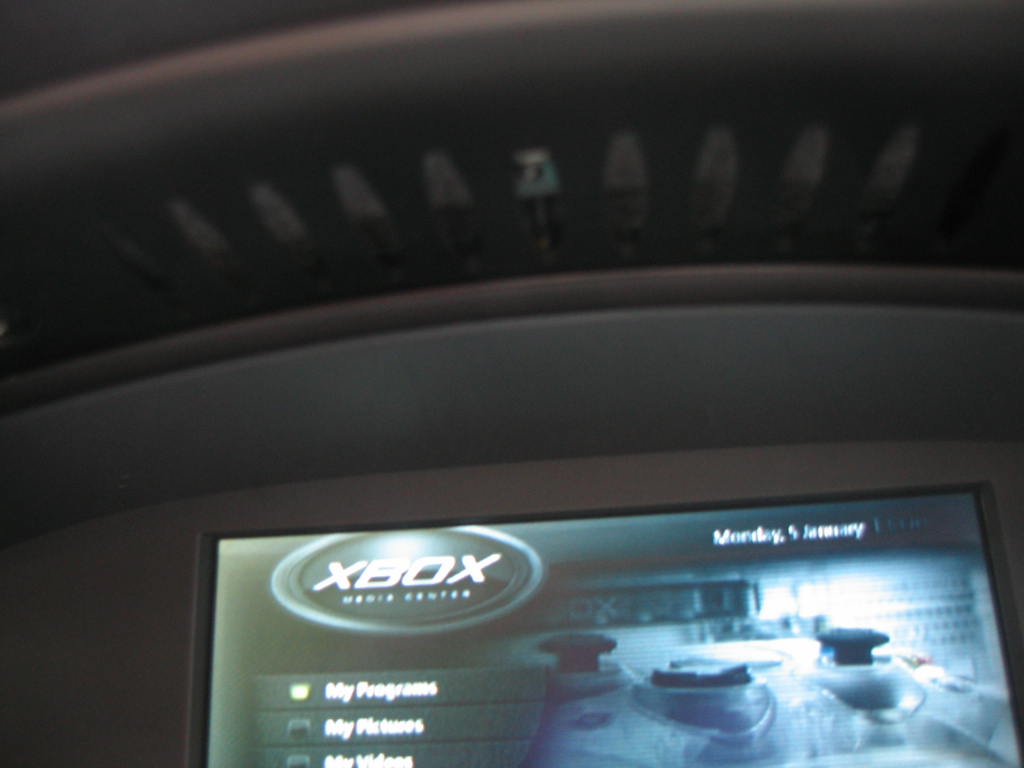

This is the result of the interface:
and this is the infra-red reciever, mounted invisible (take a good look in one of the openings):
for controlling the xbox, and for power the xbox on while driving, I extended the power button, headphones and two controllers to the center console for the rear passengers:
please let me know what you think of this...
