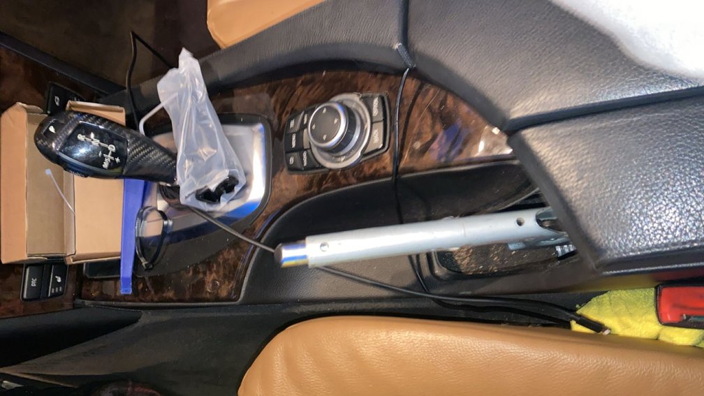

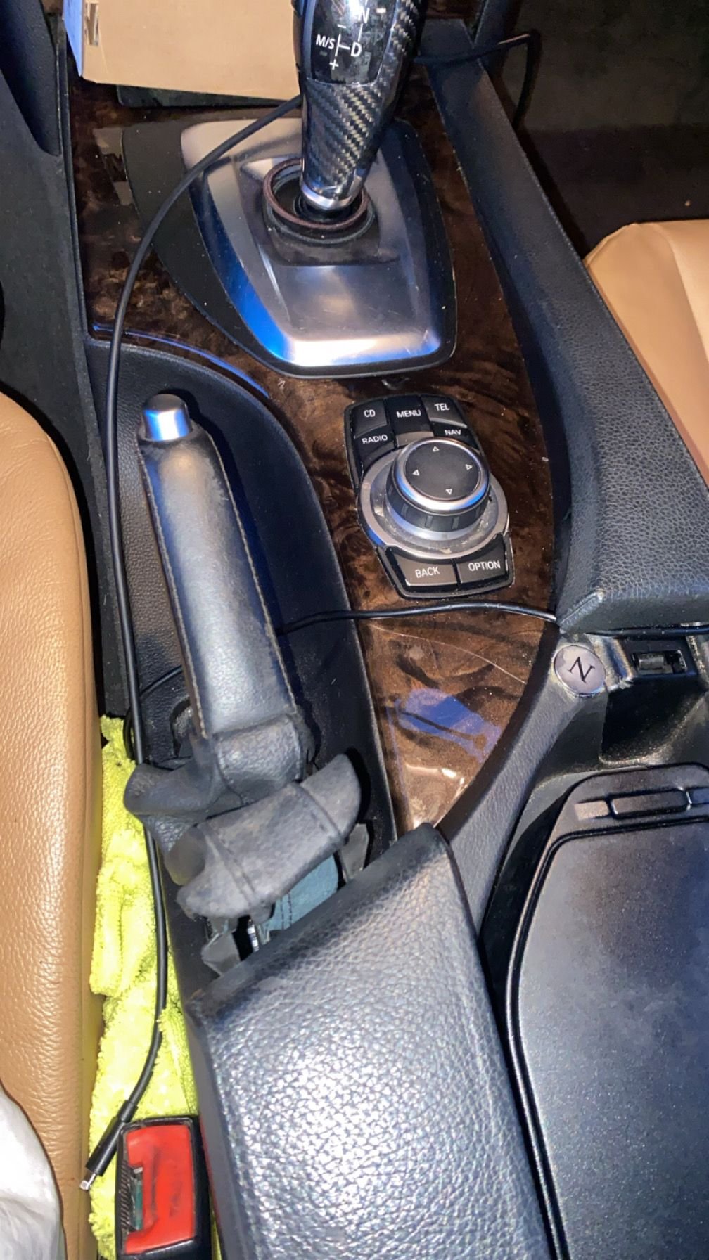

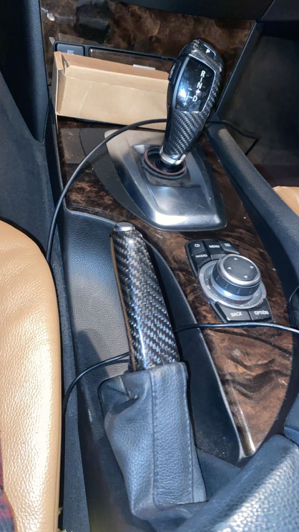

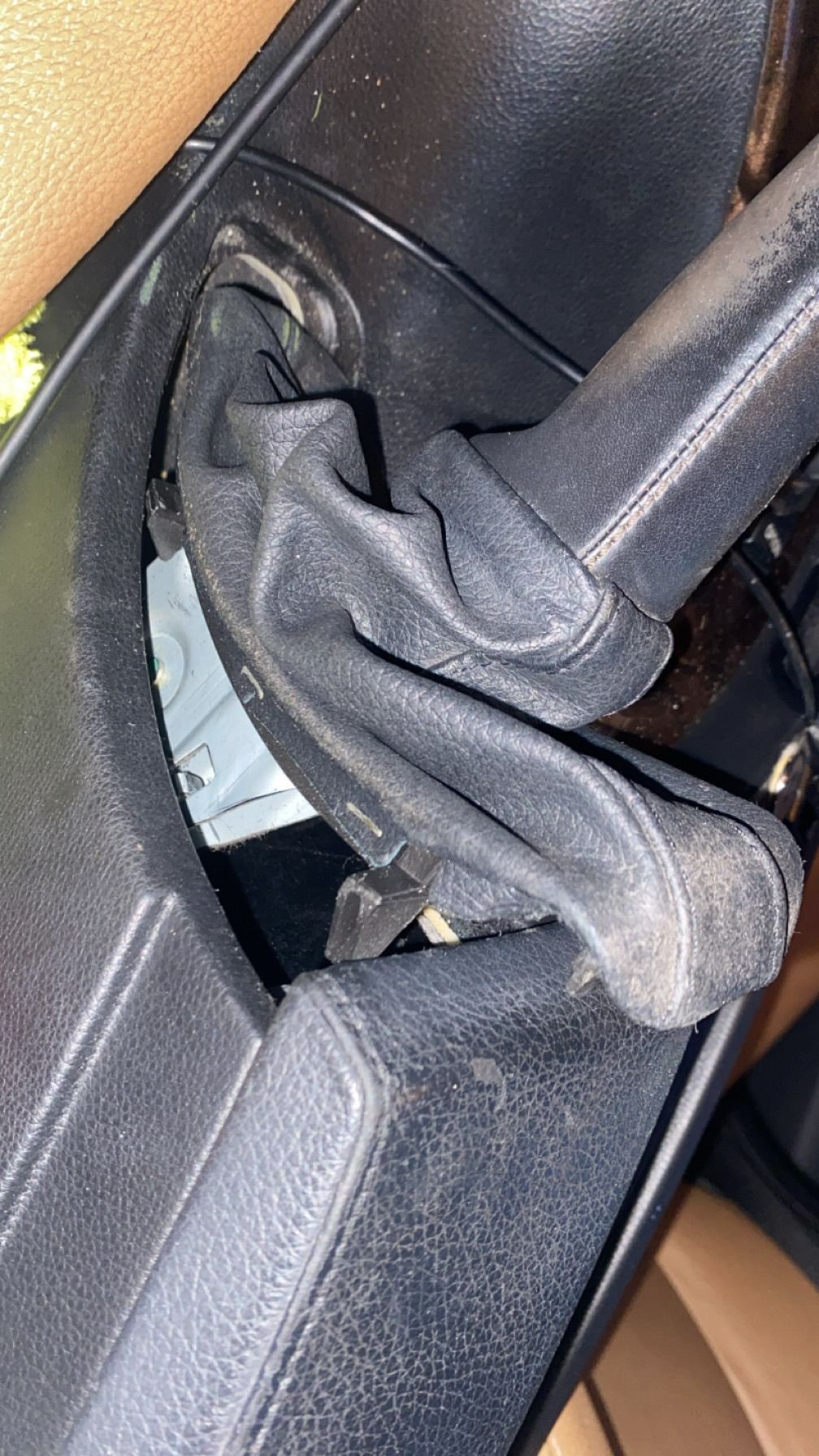

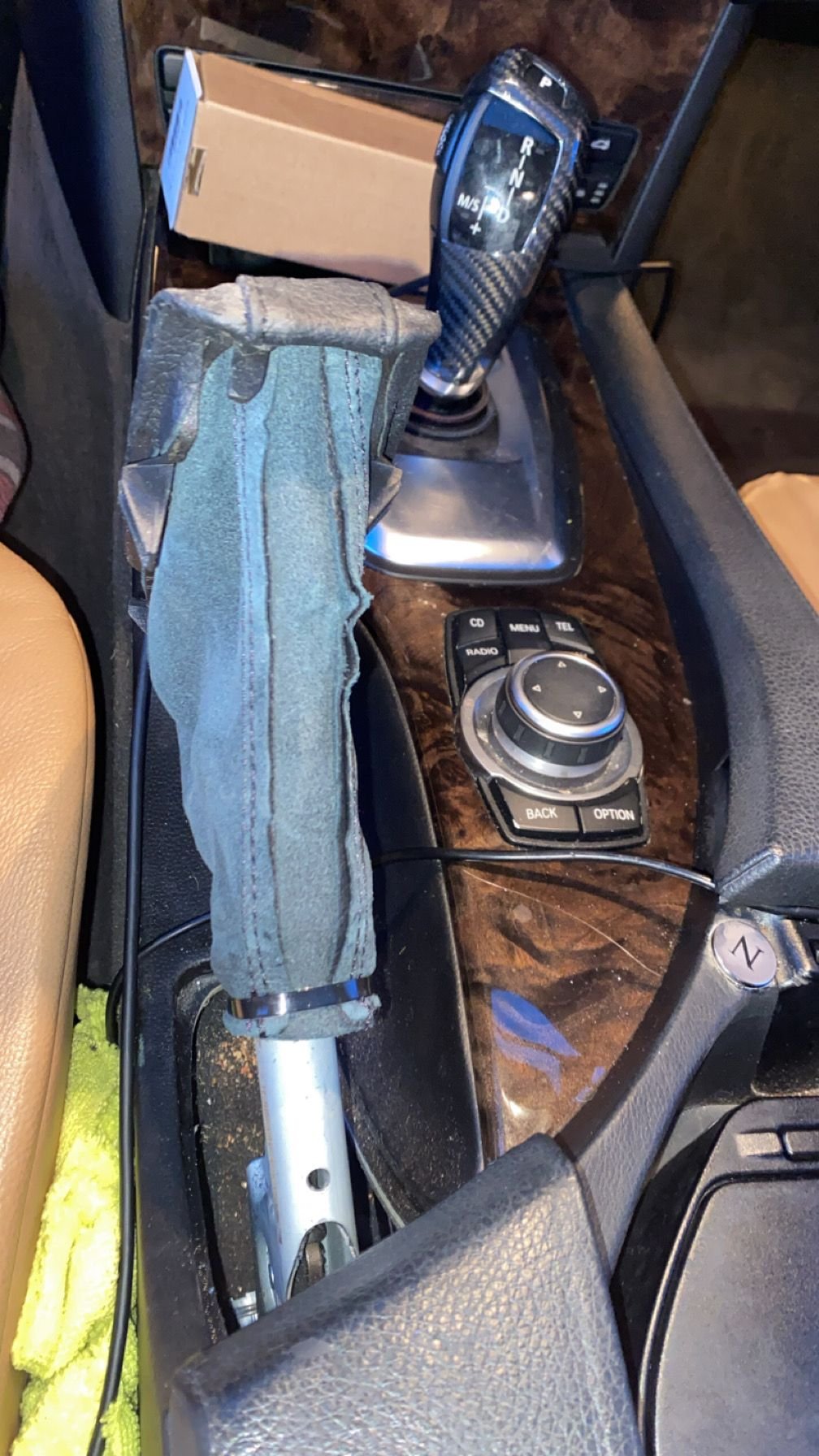

Some images below showing the process. The part I didn't enjoy was removing the leather boot but it's easy once you know how. I have shown some pics of the clip locations in case it helps other people. I would say the best way to remove is to firstly use your fingers in the space between the handbrake and the centre console and push the base of the boot in towards you i.e. bend it inward to create an openening, rather than just pulling the boot upward by grabbing the leather (I had already read on here that pulling on the leather is a bad idea). Once you have a gap you can get your fingers under the boot and pull it out without having to the pull on the leather at all. It does take some force, but the boot frame is tough and flexible part.
The handle itself is a simple push on/off. Make sure you have a new cable tie to replace the one which holds the boot to the handle.
As you can see, the new handle is quite a good match, if a little light. But I prefer it to the black. There may be other shades of beige available in the parts for the other series - I only looked at Z4.
