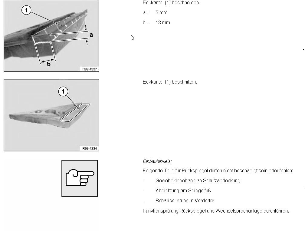

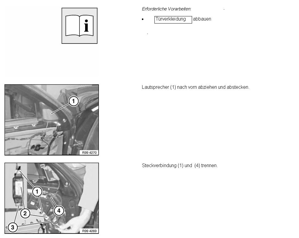

Hi,
1. remove the door paneling
2. remove the speaker behind the mirror (1)
3. disconnect speaker and mirror (1/4)
4. to untighten the three bolts (1)
5. remove the mirror
(sorry for my english!)
regards Centaurus

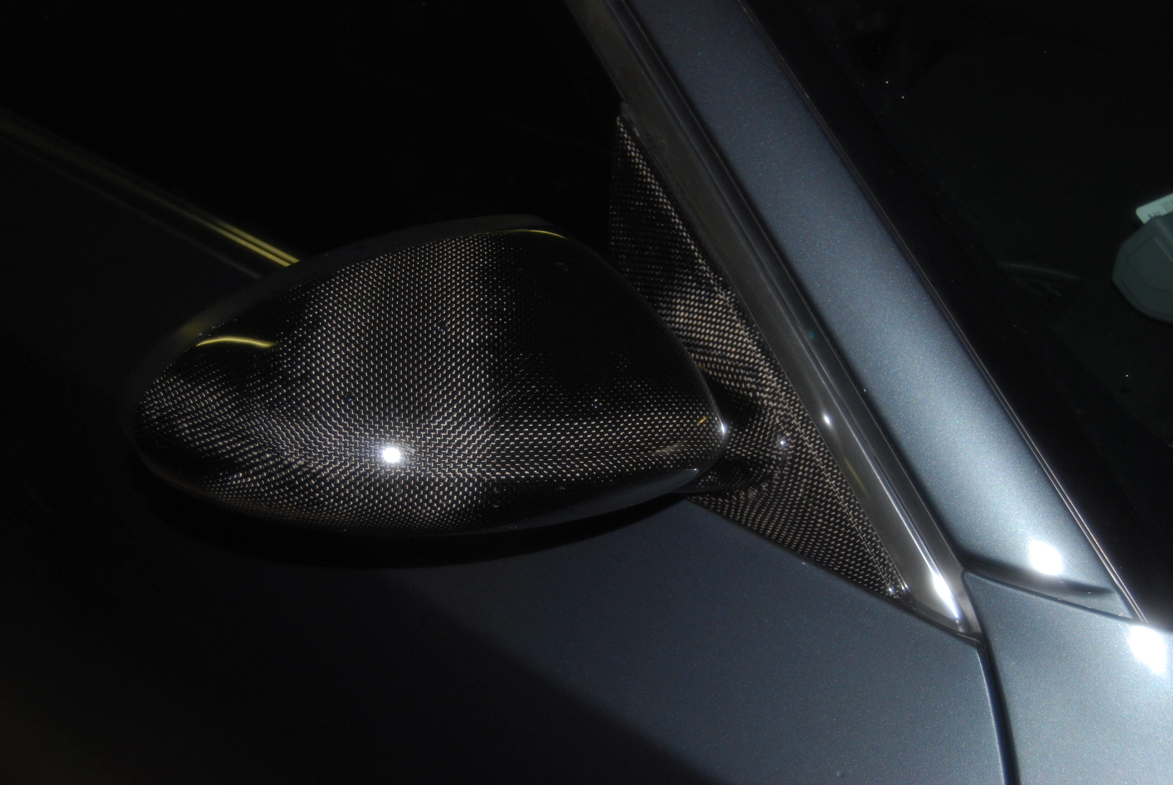

Hey!!
I got them from Ca automotive! Fantastic finish and the carbon is flawless! They are awesome!
Mine is an LCI - 2007 facelift
here is a pic of them fitted! was very easy -just played about with it for about 30 mins and the second one took literally 10 minutes !!
Enjoy! sorry for poor pics, ill get better!

and do you have all the functionality of a standard mirror? such as folding? passenger mirror dip when reversing and things like that?
Old Mar 6, 2008 | 08:46 AM
guy's Avatar
guy
Posts: 42
Yeah i have full fold, and when put in reverse mirror dip! and of course able to move the mirror by my buttons so i can actually see out
