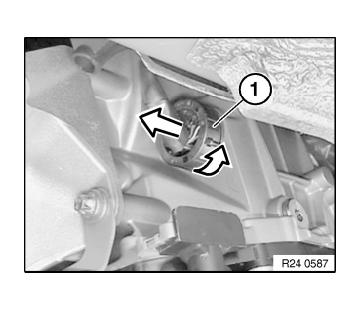

I want to DIY it all and was wondering if anyone has replaced the mechatronics sleeve before. I've read around that you have to drop the pan to release the clip for the sleeve and that you can just turn and pull the sleeve out. I just want to confirm that. I attached pictures of the sleeve itself and a picture from the manual on how to remove it but it looks too simple to be true. Hopefully it is just release the clip, turn and pull and replace.

Suggest drop down the exhaust a little bit for easy turn off this clip.
