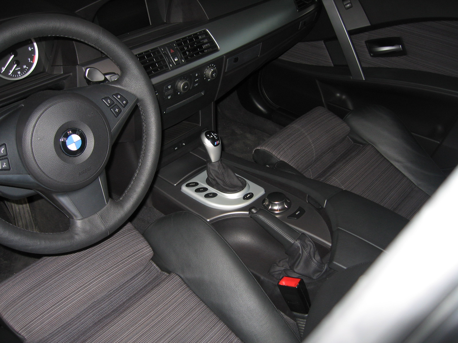

Hi,
Here is a picture of my steptronic gear shift which has original M5 gear knob and slightly modified surrounding plate and leather cover. Lights are still missing, but it is under constructions. All gear shift positions (P, R, N, D and DS) are working perfectly. Buttons doesn?t have any functions yet, since my car is 530i, not an M5 What do you guys think of my mod?

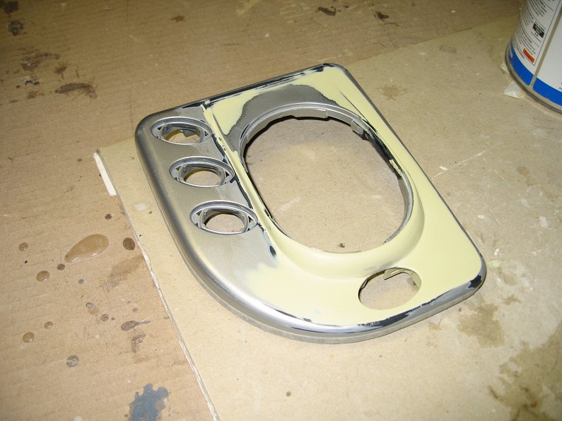

Here is short step by step instruction, if you wanna go for this mod:
1.) Cut original surrounidng plate as in the following picture marked with red.

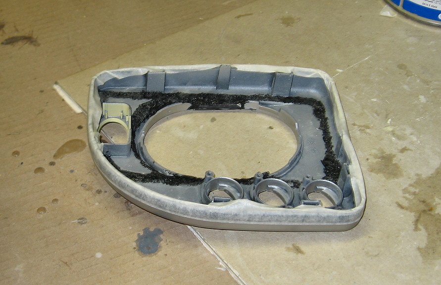

3.) Weld pieces together as shown in the picture
DIY: M5 gear knob and surrounding plate for steptronic-img_0586_pieni.jpg
4.) Fill weldings with plastic packel and grind with water sandpapers starting from 600 all the way to 1200.
DIY: M5 gear knob and surrounding plate for steptronic-img_0583_pieni.jpg
5.) Paint with gray primer, paint with silver and finally paint semi gloss lack all over the surrounding cover.
6.) Take M5 knob and cut the plastic frame away from it and cut leather to smaller. Cut circle plastic frame into two pieces and weld some plastic to extend it to ellipse.
7.) Take original steptronic leather cover and cut it half. Cut unnessary leather away until it fits tigtly to ellipse plastic frame and after that sew up leather pieces. Finally glue the new leather to plastic frame.
8.) Install it to your car...
DIY: M5 gear knob and surrounding plate for steptronic-img_0680_pieni.jpg
