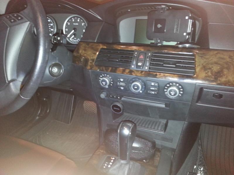

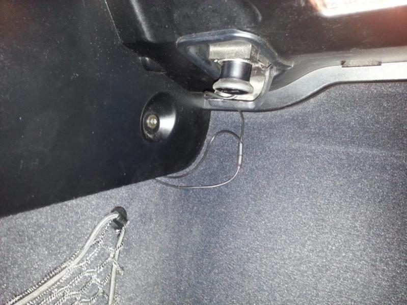

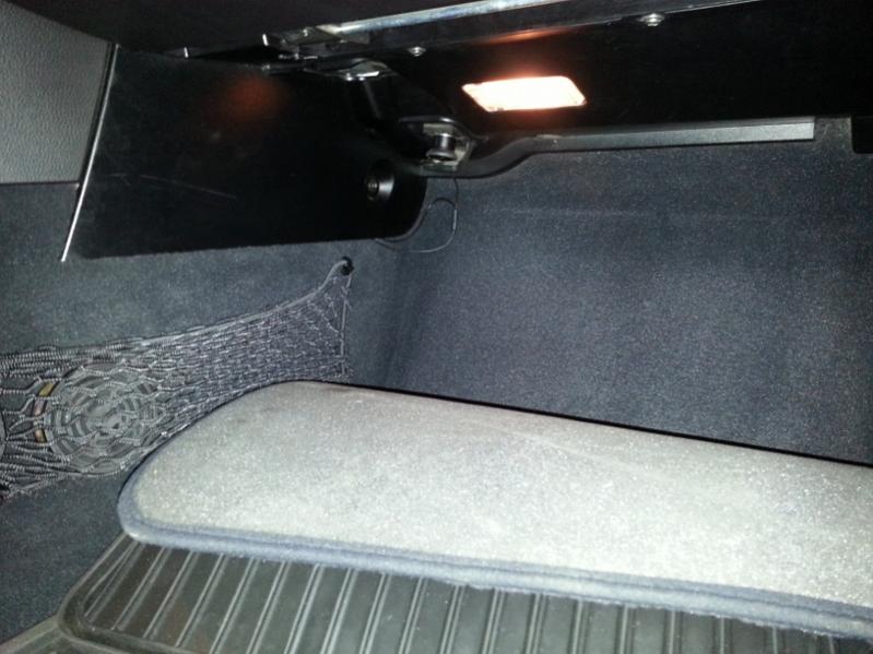

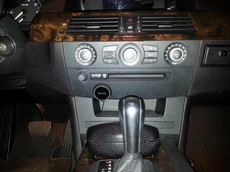

ok i finished it today, coding took 2 minutes after i figured out how to use everything, and the Aux-in cable install took about half an hour. very easy
came out real good.
I ended up installing the belkin Belkin Bluetooth Car Hands-Free Kit
CarAudio Connect AUX with Bluetooth® | BT Music Receiver | Audio | Entertainment | Products | Belkin USA Site
left the aux cable inside and used power under the dashboard where you feet goes.
I am very happy with the install, both musics sounds awsome and handsfree works great.
