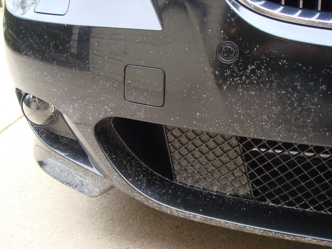

I have gotten some "gritty" white substance - almost like a spray on the front bumper and related areas of my black 550. I think it was last night driving through some road repair zone on the interstate where I might have gotten it.
It is gritty and rough to feel and touch. I tried using "goof-off" but it does not do any thing to dissolve it. Is there another solvent or any other product I try to safely remove this from the paint without doing any damage - OR the only other option could be to take it to a body/ paint shop and have them tinker with it?

That does look like road repair material that has become "stuck" to your finish. I would not use any abrasive finish restoring product. If it's a concrete road material I'd repeat what you've already done with a diluted gentle detergent or cleaner degreaser like Simple Green. Use a SOFT brush and keep the area flushed with water so you don't grind the grit back into the finish.
This happened to me once on a road trip with a rented van. The highway was being grooved (cutting into the concrete with saws) and it was raining - all the concrete dust was being picked up by cars and trucks and bathed the side of the van. After we returned from the trip, and overnight the crap dried on the side of the van and was STUCK there. REALLY STUCK!!
It took hours of washing and scrubbing to get it unstuck.
Maybe something would dissolve cement without damaging your finish - are there civil engineers or chemists out there on the forum ? ?

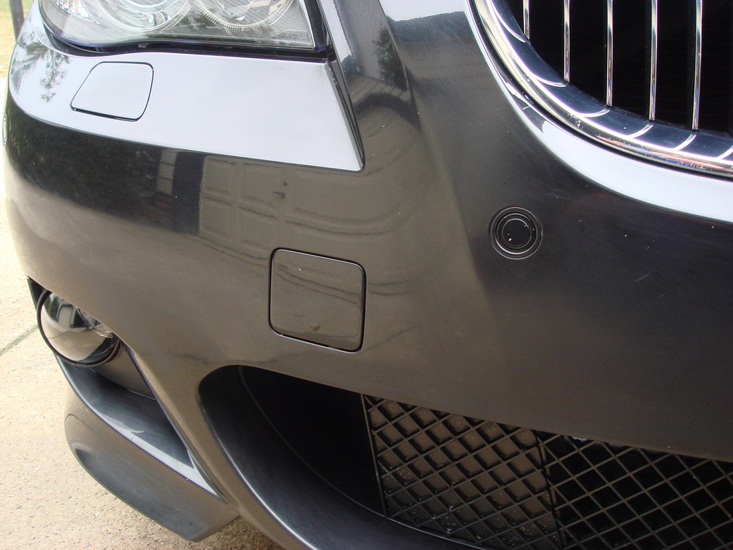

just had the opportunity to take some pictures after washing the car this weekend.. showing the refinished front...all of the strange grit.. which was actually sticky road repair concrete, is finally gone..
