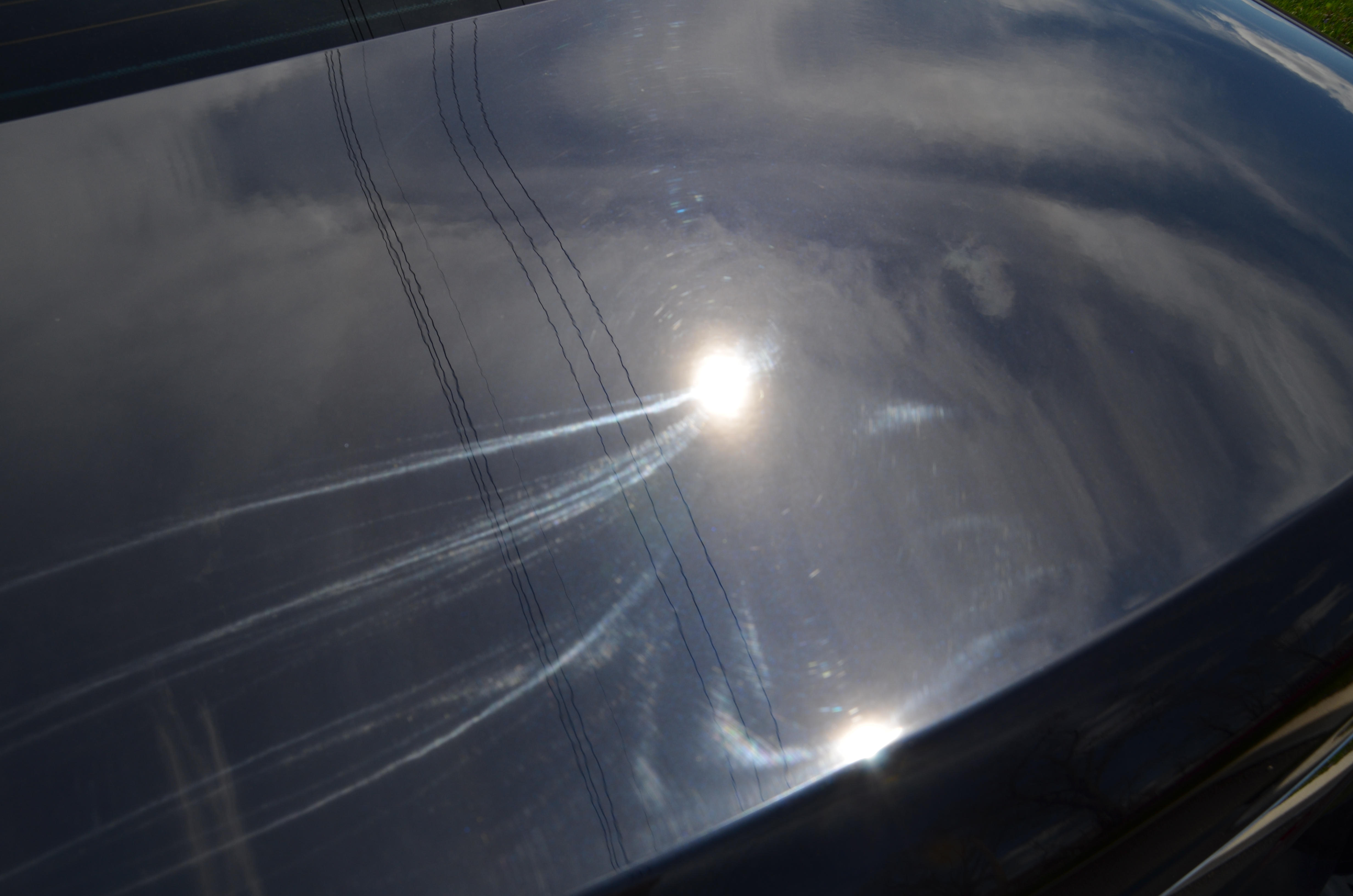

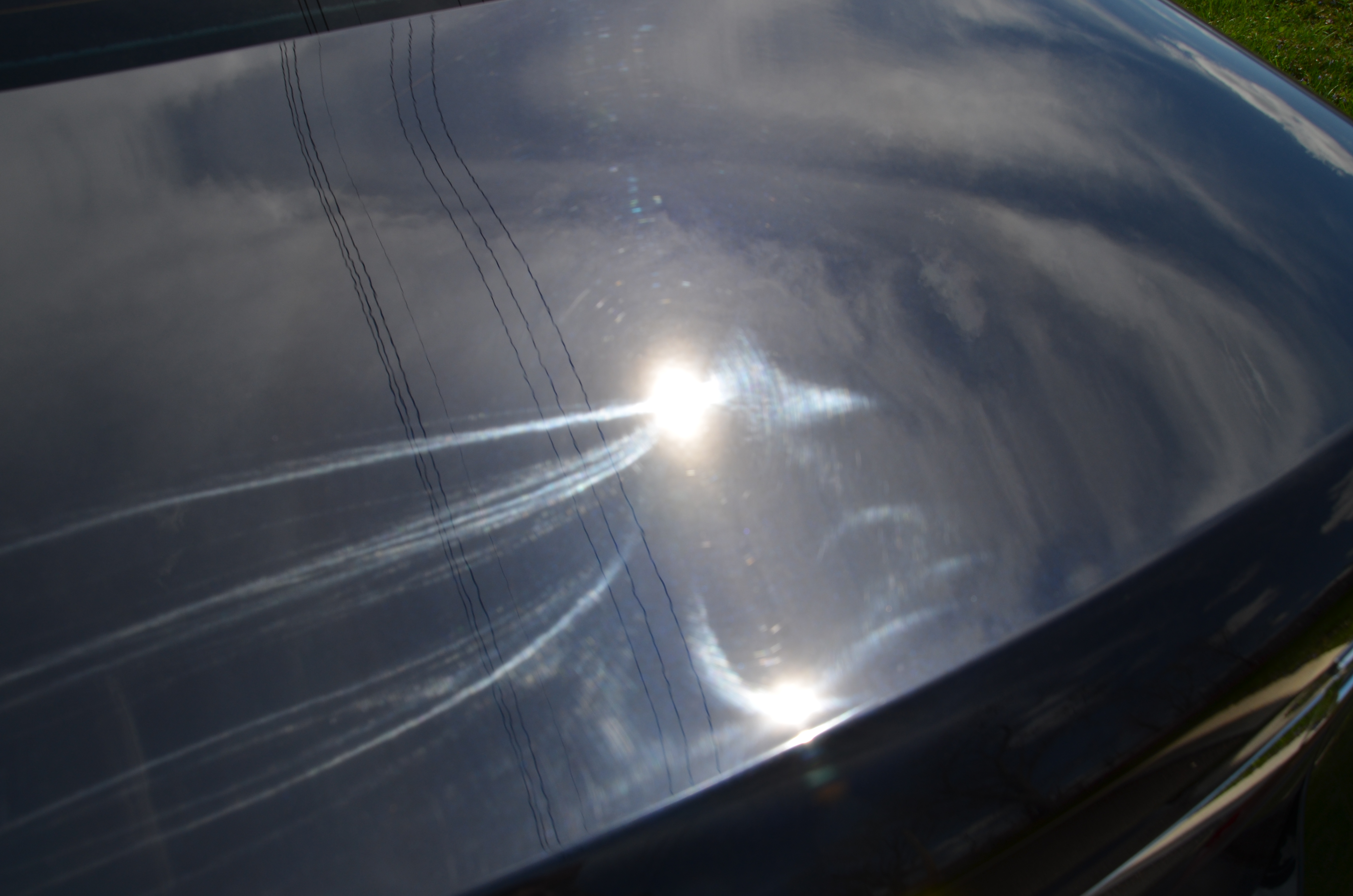

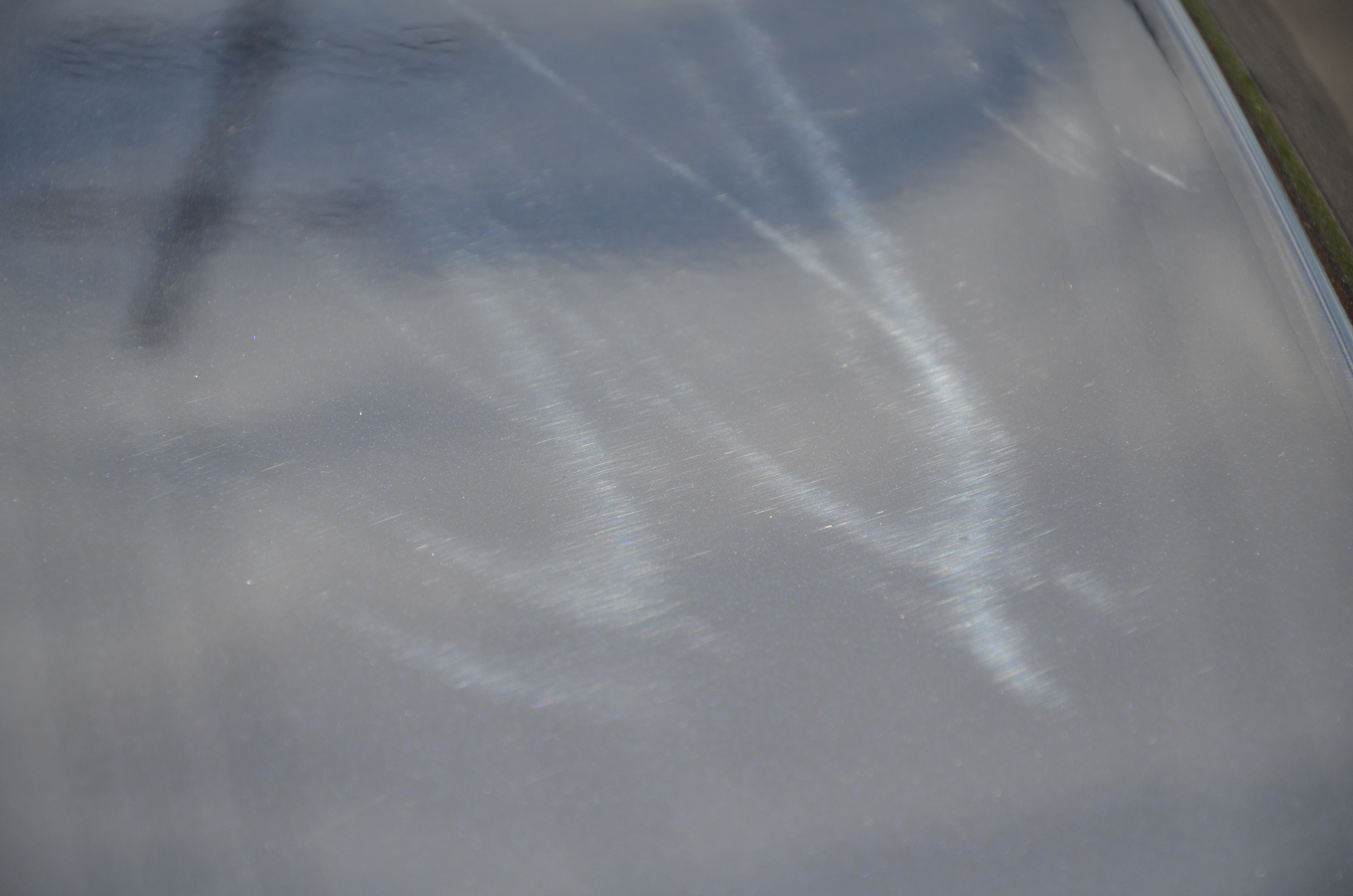

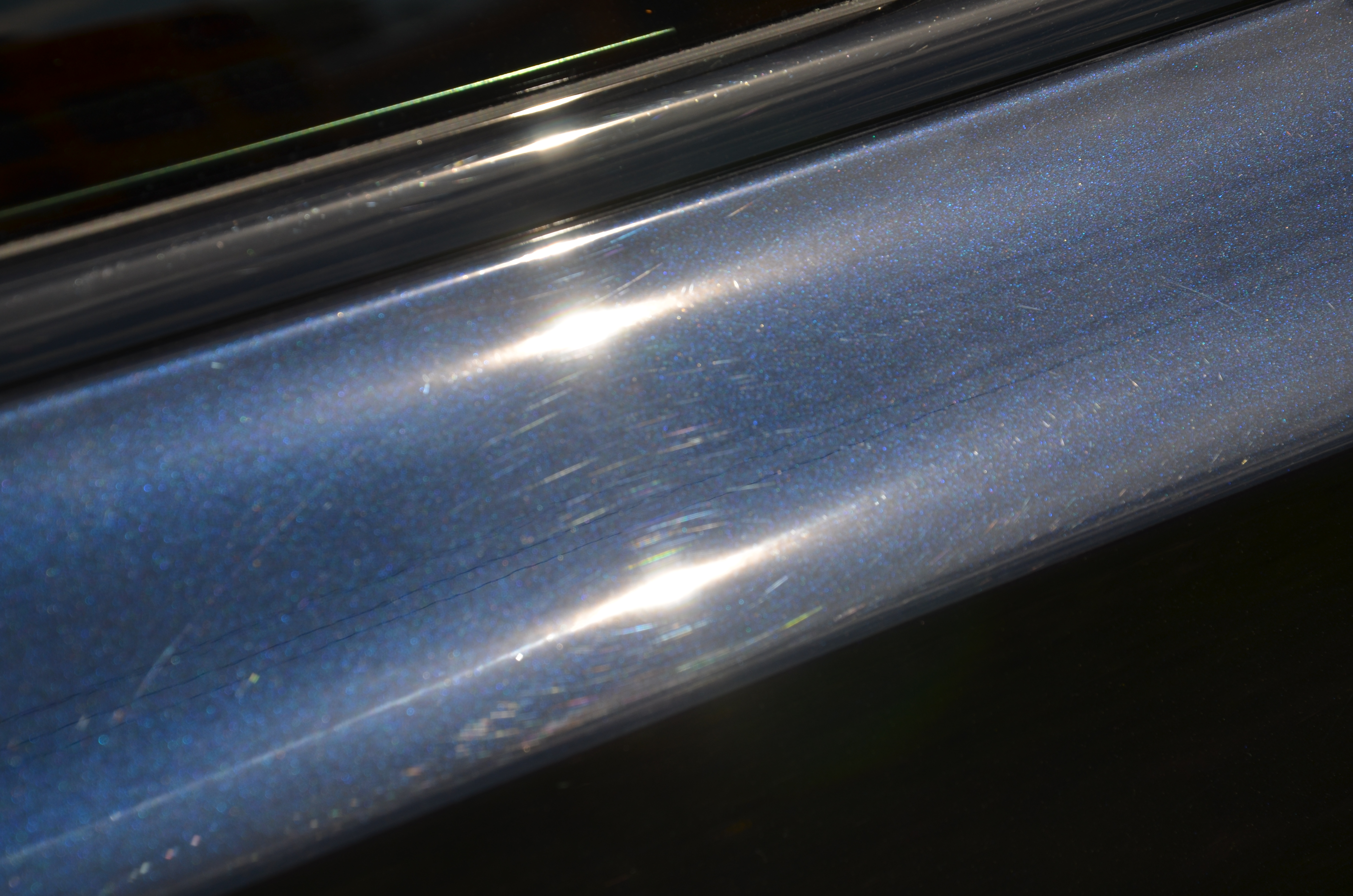

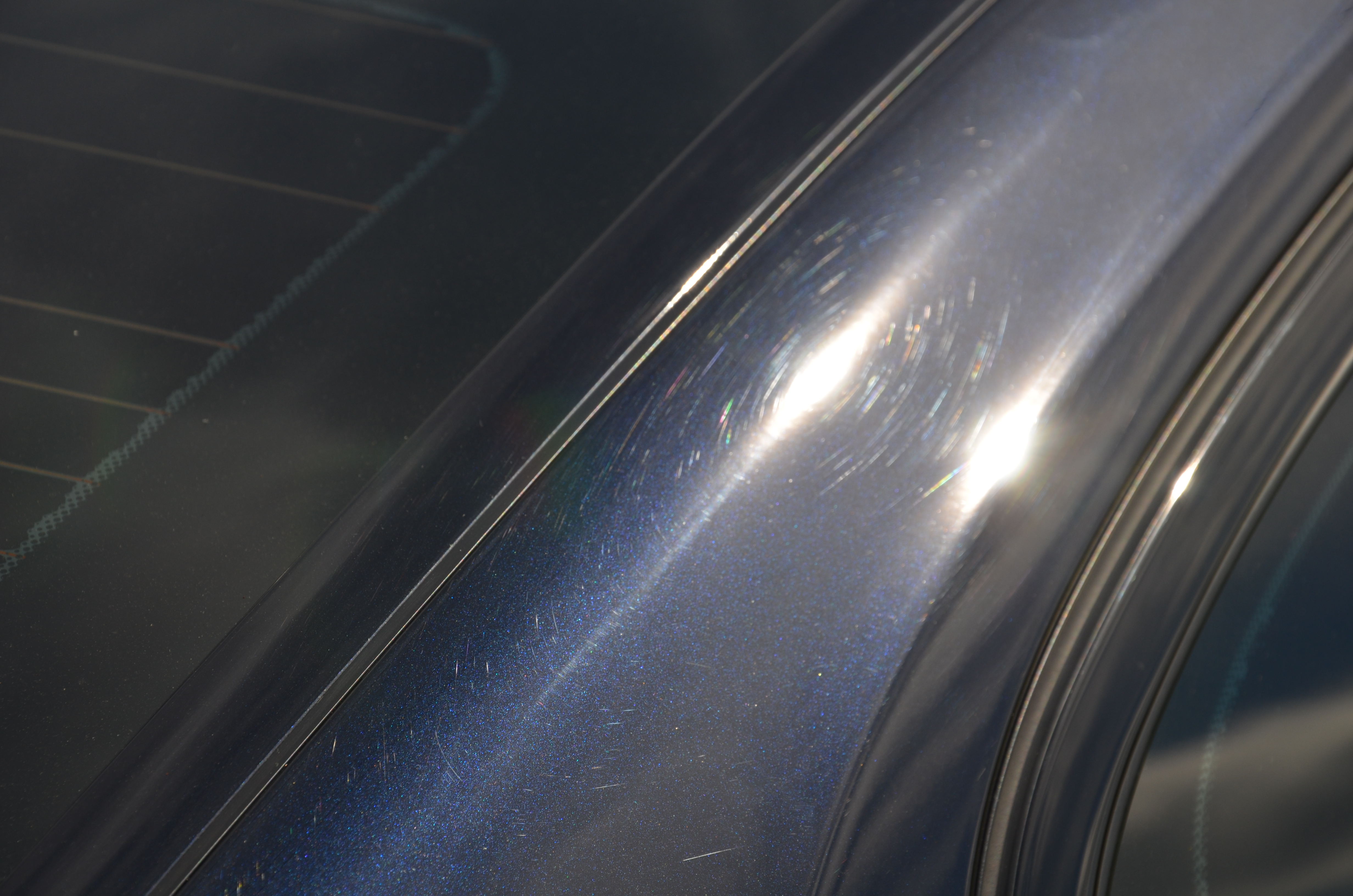

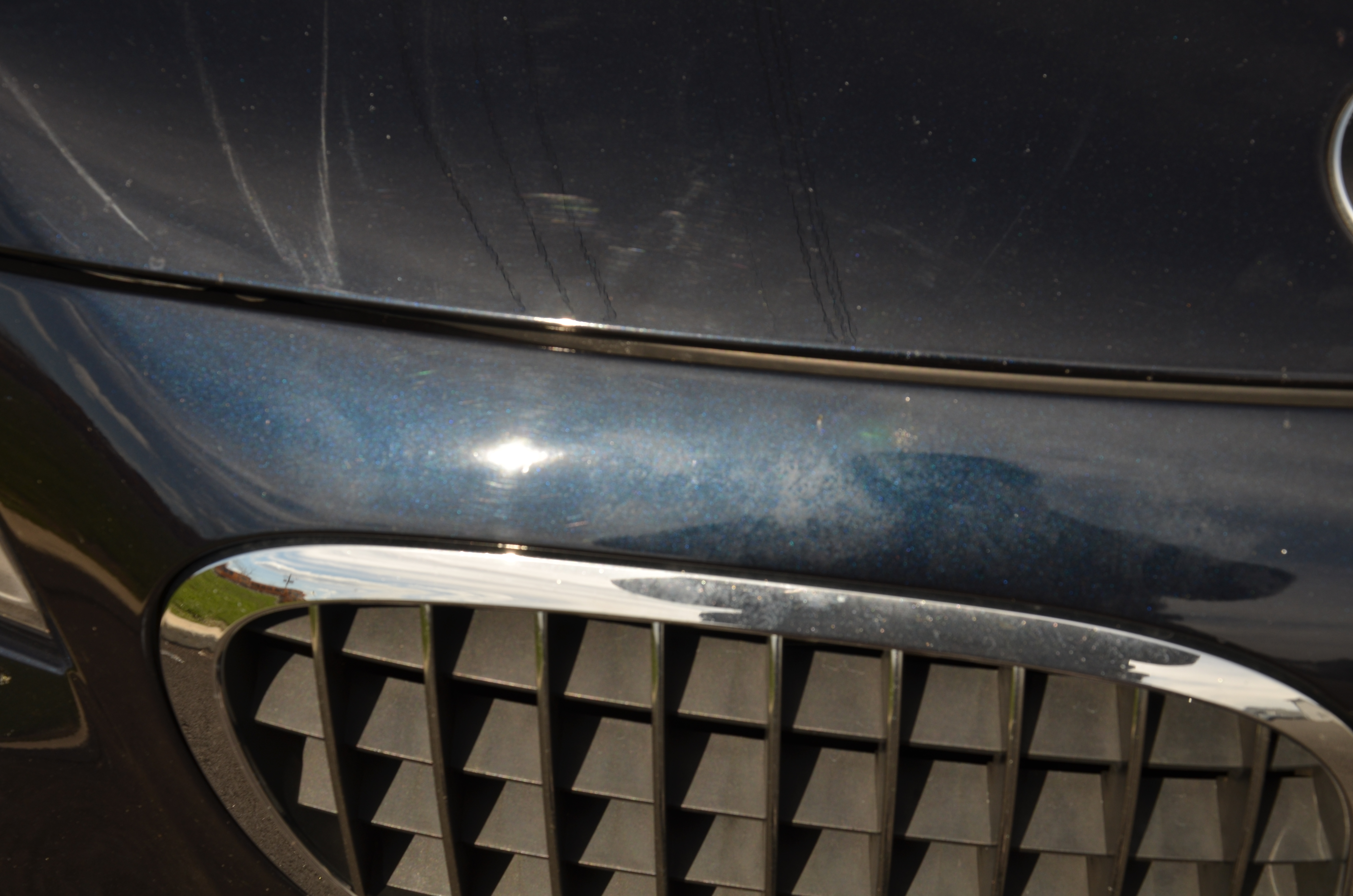

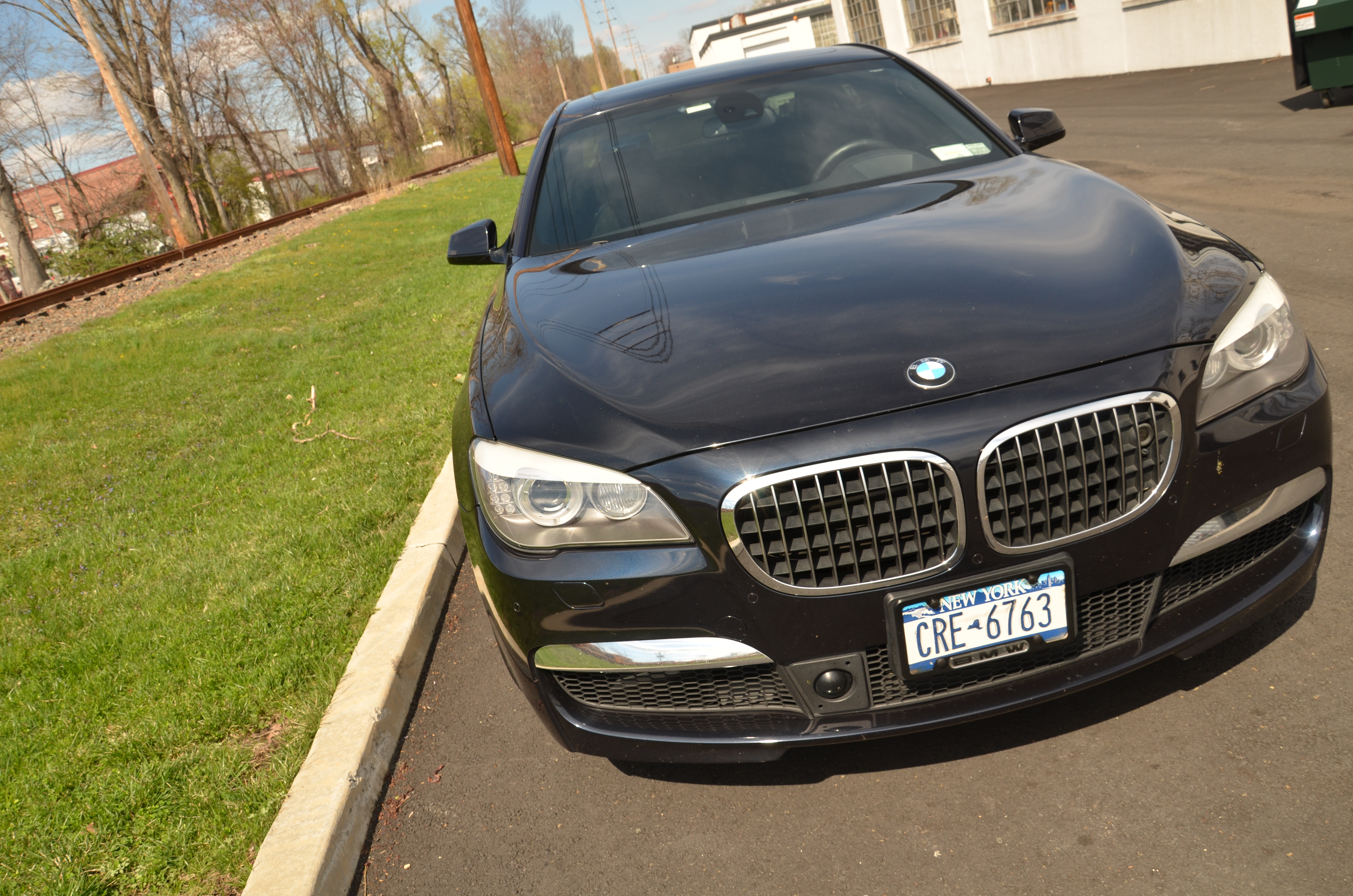

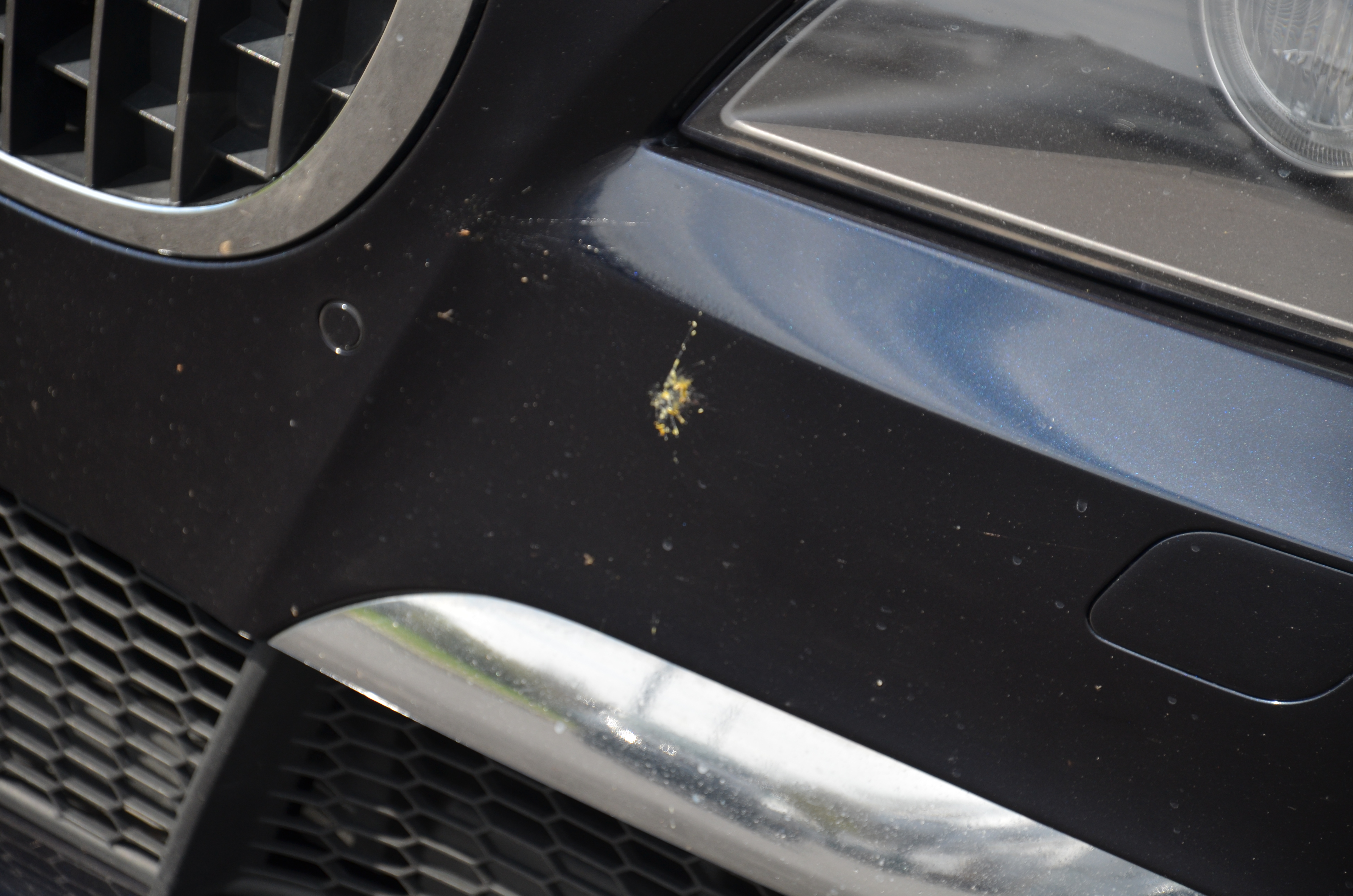

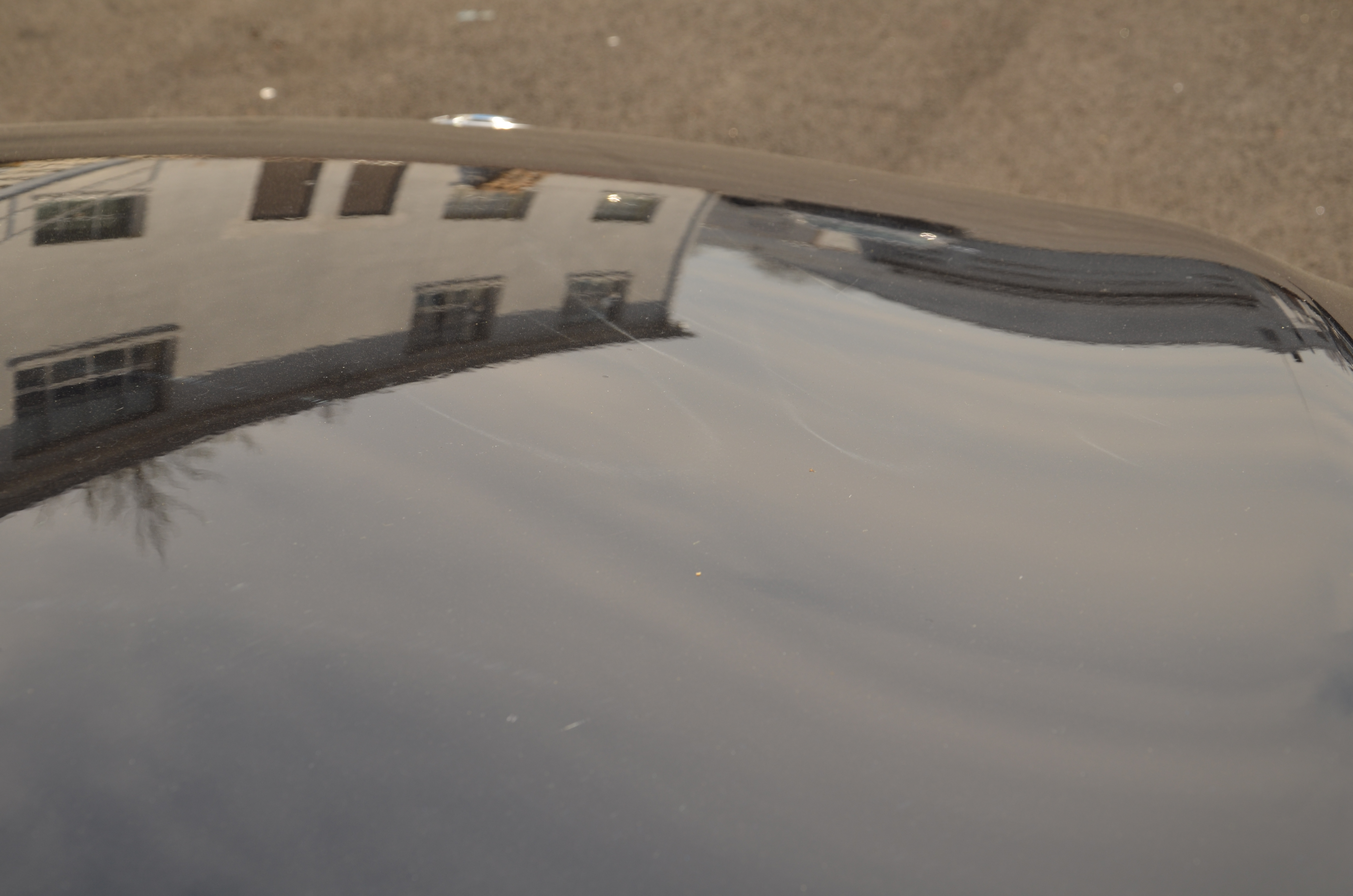

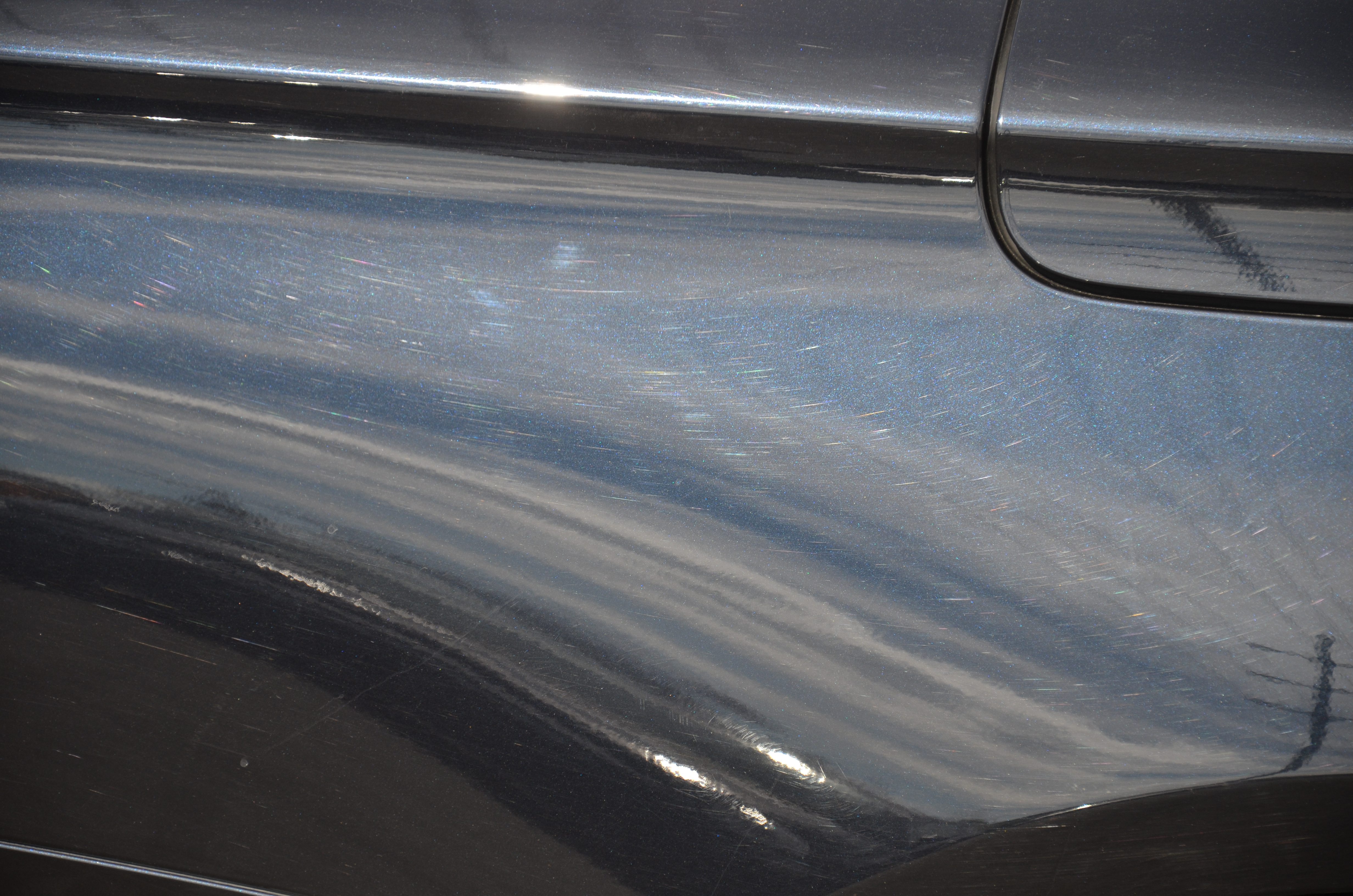

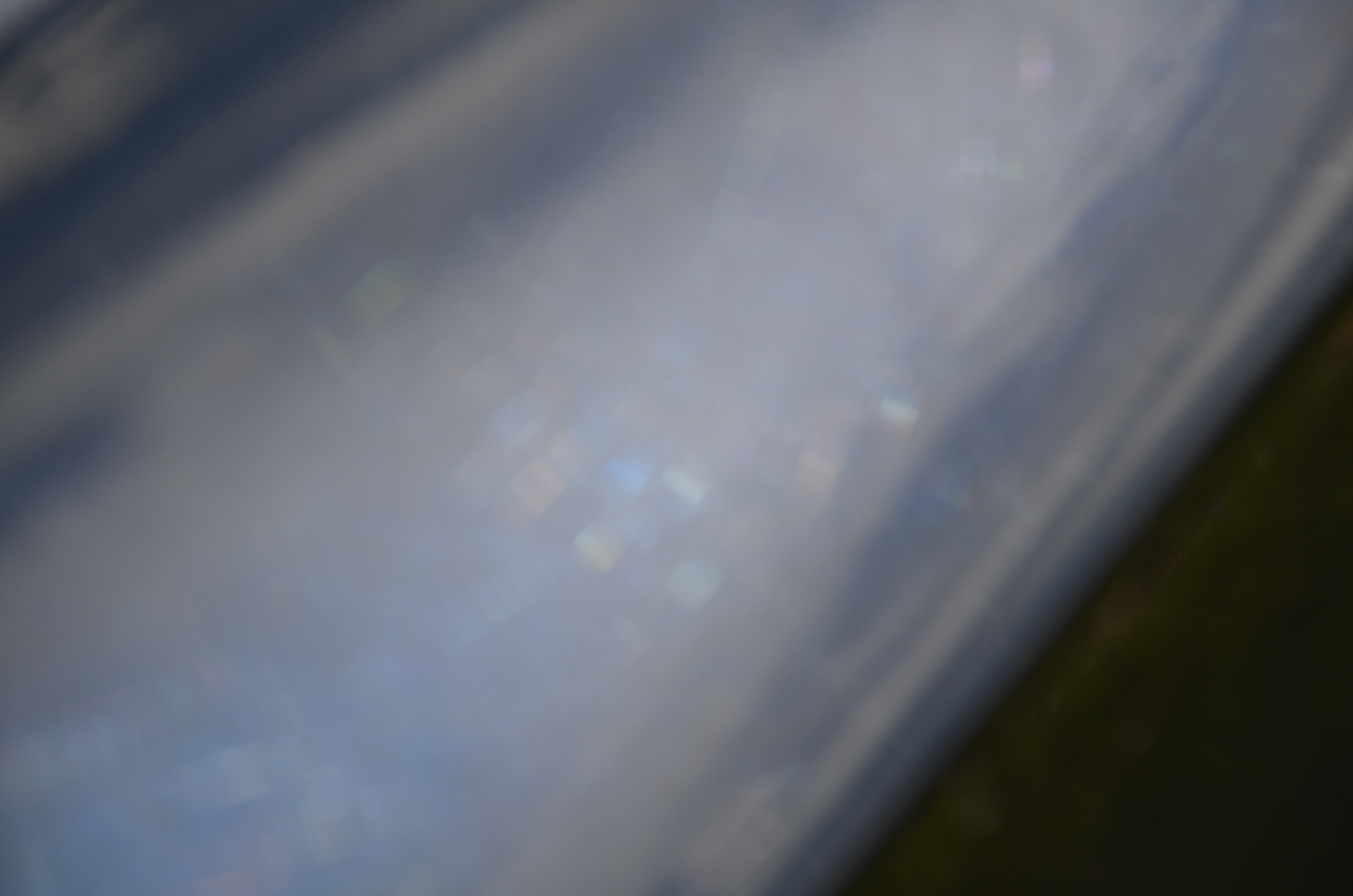

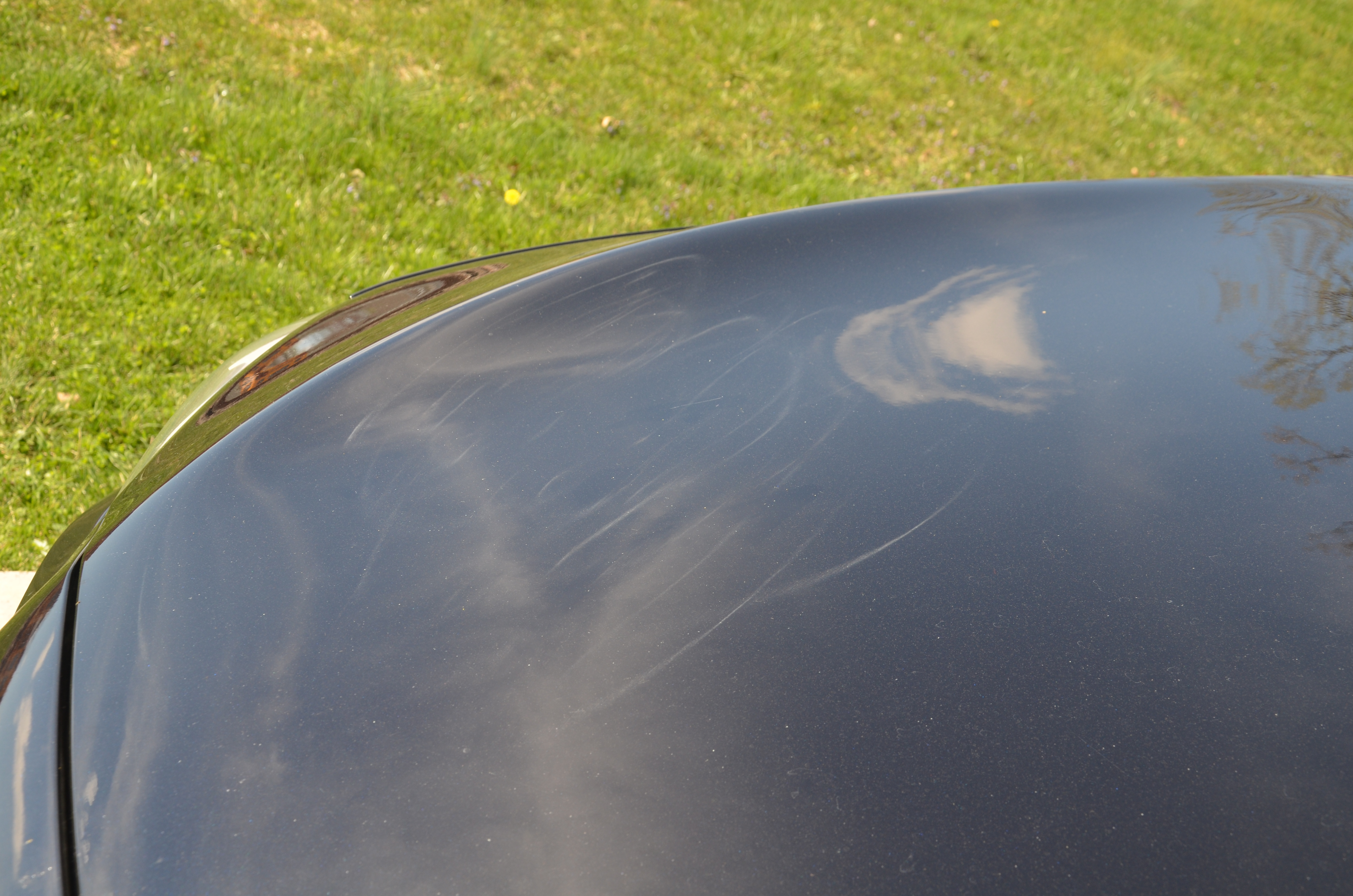

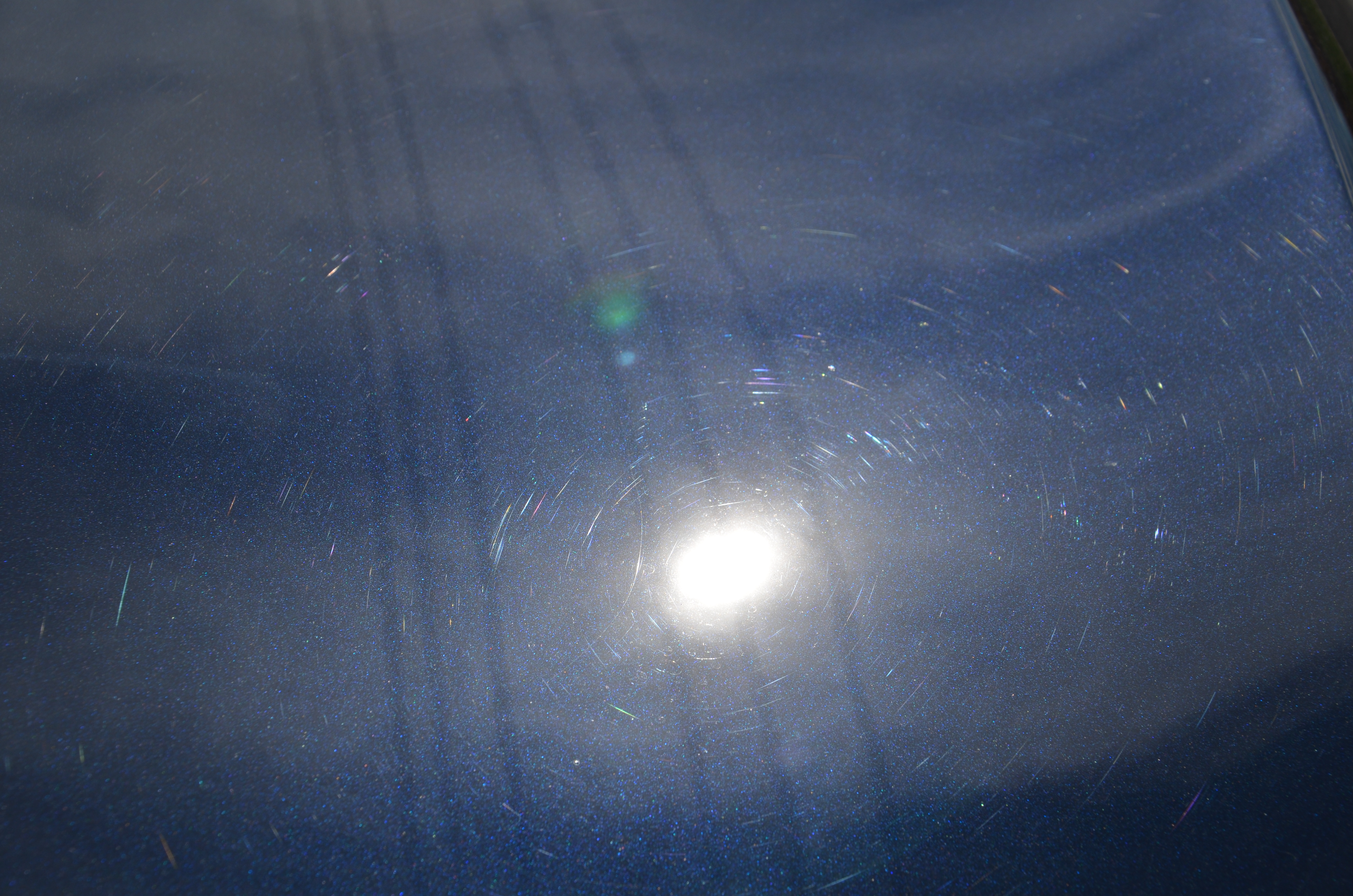

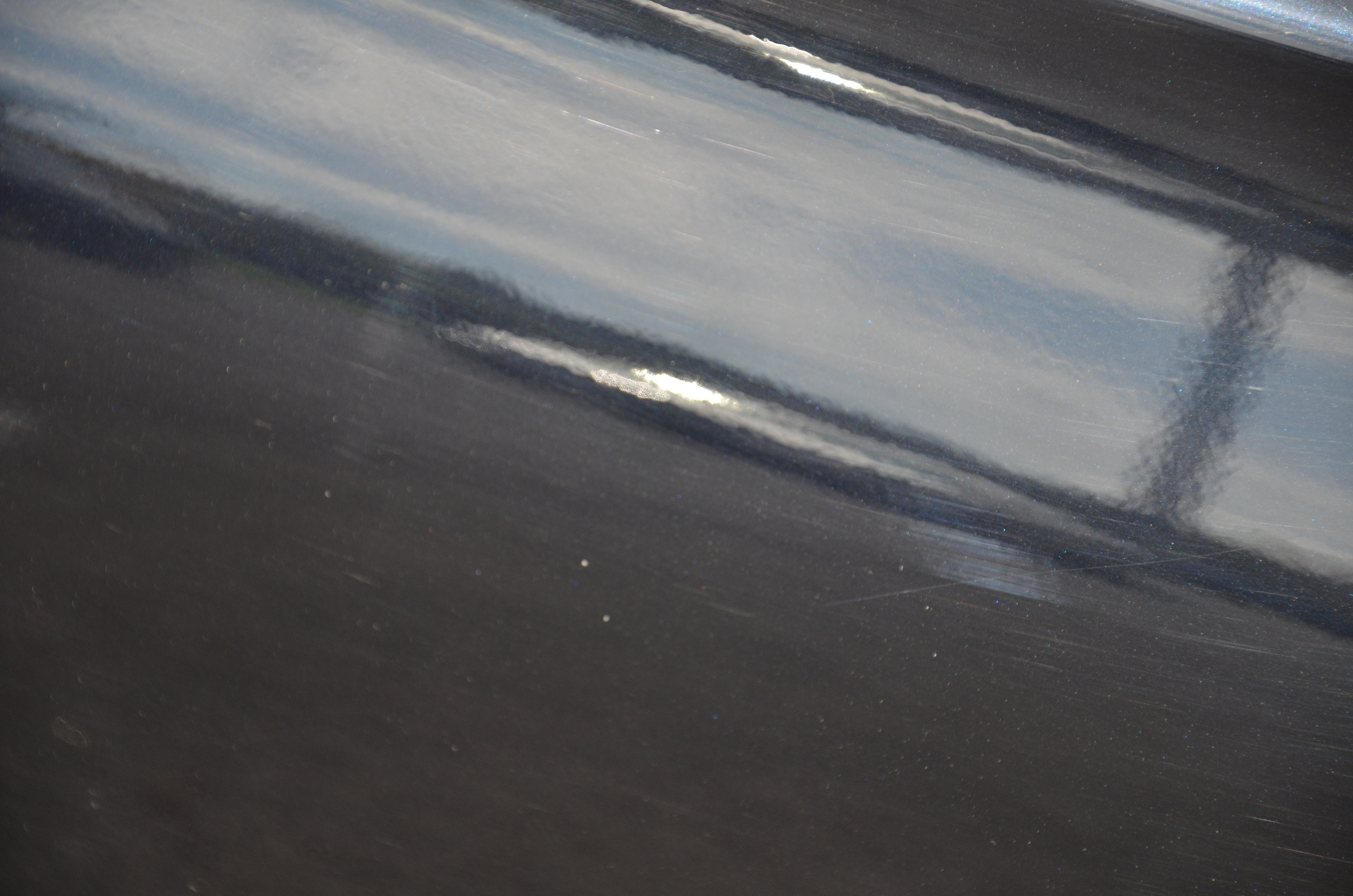

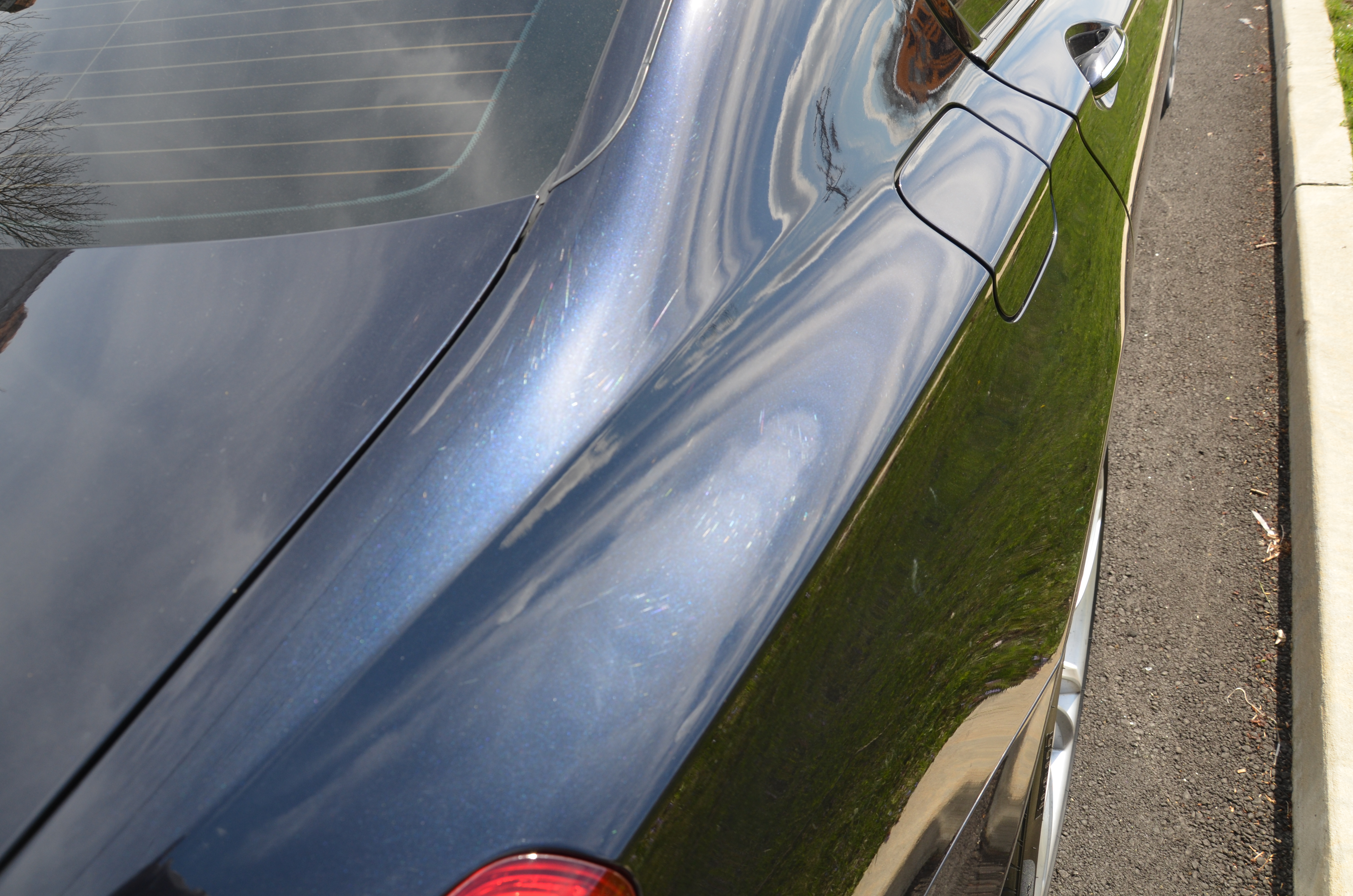

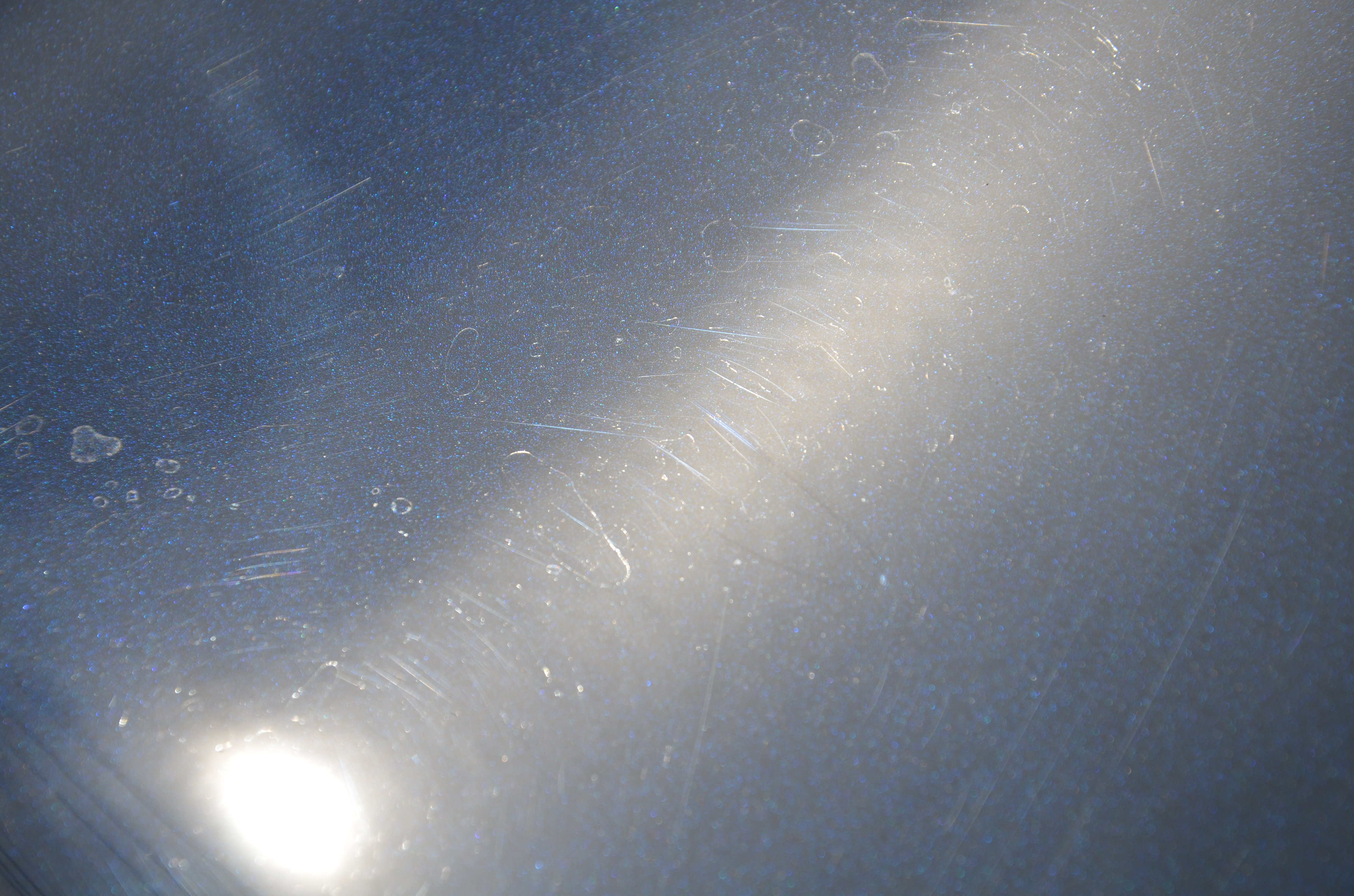

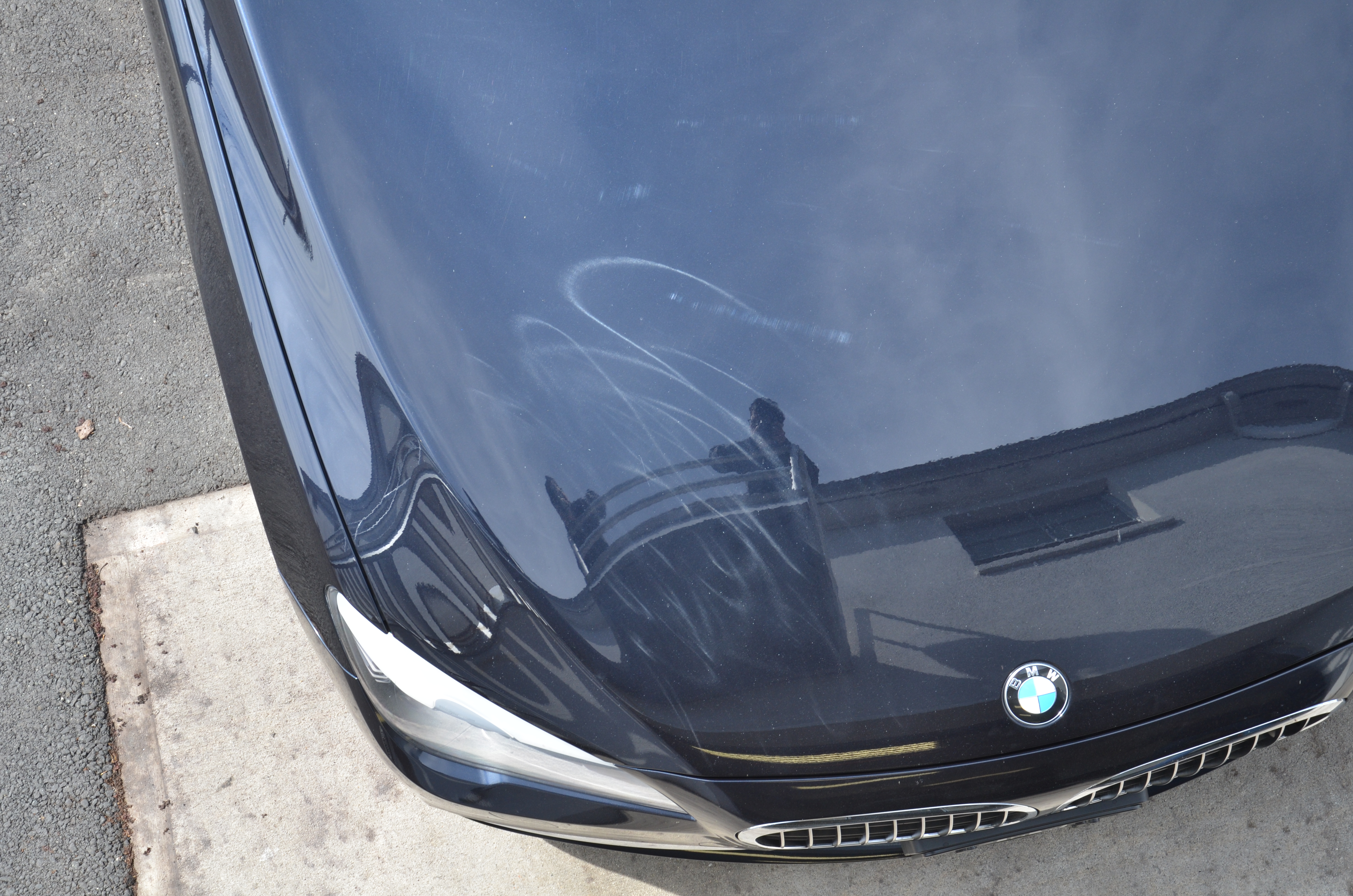

Before - as you can see some pretty bad swirls, holograms, scratches on the paint, buffer trails, water spots
