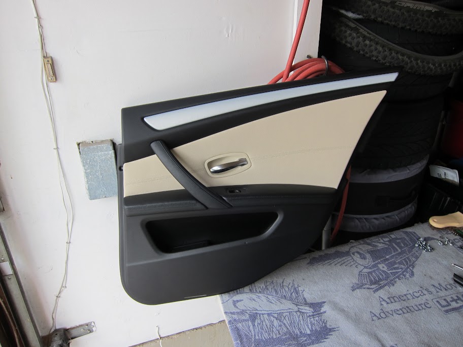

Used doors arrived, I tried to get the full set but unfortunately the seller couldn't find the driver panel so I took the 3 and sourced an additional panel elsewhere.
Black vs Beige

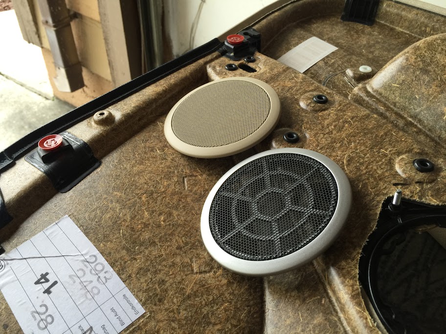

My favorite part of these custom panels, the Dirac speaker grills! I really like the contrast and the aluminum color matches other interior bits.
High performance grills! lol

The black doors and carpet really make a big impact.
