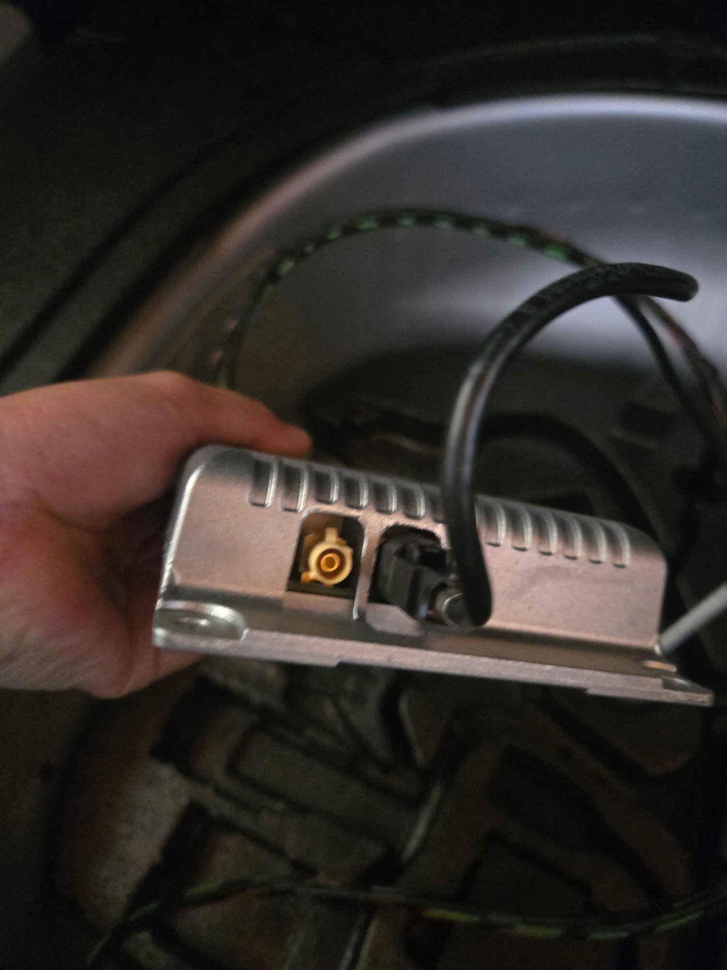

Ah, thanks Sir. There was a MULF2 High under it.
Anyway, there is one port on the module that didn't connect to any cable. Is it normal? Picture provided below.
The yellow port.

The black connection is the USB port. The empty port is for BT which is normal
Seems everything is connected perfectly.
