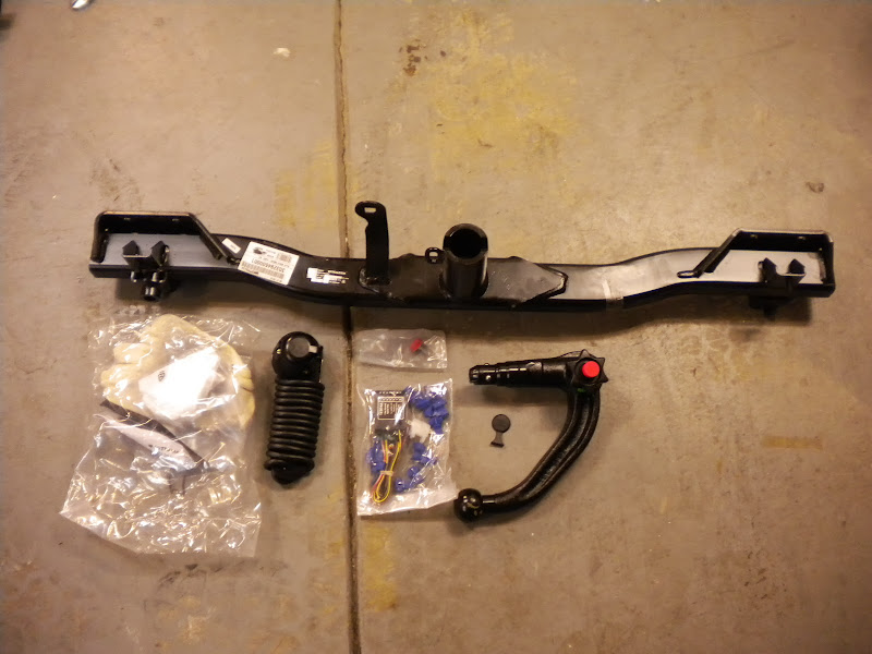

A few years ago I imported and installed a Westfalia Tow Bar from PF Jones. It's the stock goose neck tow bar that BMW sells in Europe.

Can you post some pictures showing how this OEM hitch mounts to car - that is, close-up of the hitch setup? Thanks.
This was the complete set. The tow bar, the goose neck with ~2 inch ball (50mm), the 7 pin euro socket (Euro Truck importers in Georgia USA sells the plug), TEB7AS generic trailer wiring kit, gloves, and a westfalia vynl bag.
The euro 7 pin trailer socket

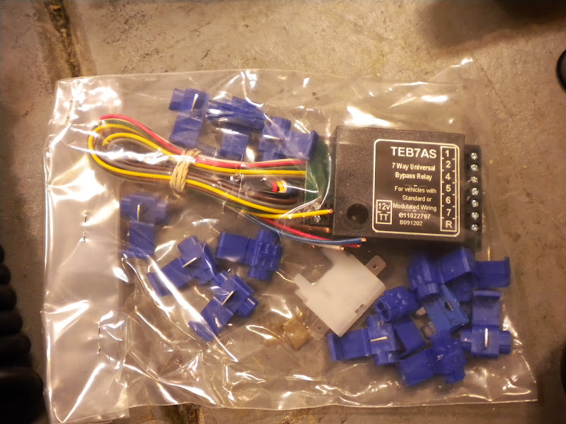

TEB7AS - Generic solid state trailer light wiring kit. I did not use the scotchlok/plier tap crimp connectors. I've seen the damage those do to wires and I will not subject myself or any future owner to the horrors those connectors bring. The TEB7AS works great! It can distinguish the difference between the break light and the PWM'd running lights from the same wire and out puts two separate wires for the trailer harness.
The old bumper carrier anchor (in my hand) and the mounted tow bar. Notice that the bolts don't line up. Don't expect to put your stock bumper carrier back on. It's pointless anyway with the tow bar attached.
The full Monty. Goose neck and all. Mounted to e60.
Some minor cutting required. Easy though.
