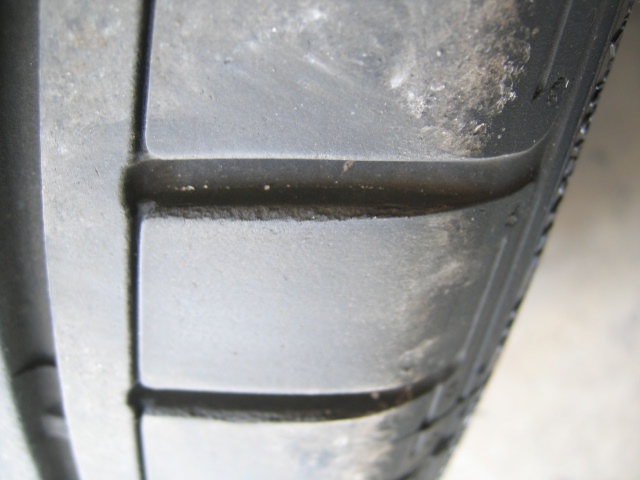

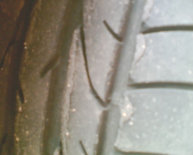

Is it normal to see this for tire wear? I have not expereinced this on other tires.

perfectly normal
you corner too fast

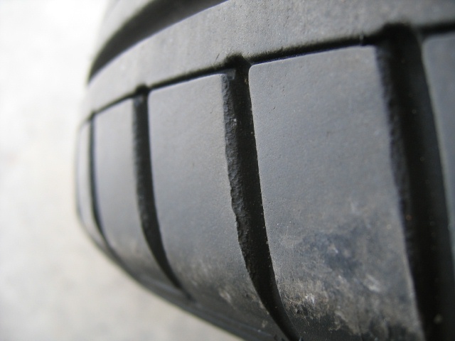

you should see mine after one hour at a race track your's is like brand new

Scalloping I think means when you run your fingers against that edge you'll feel that one side is kind of like "sharp" while the other side kind of just runs off and doesnt feel like anyhting.
Almost like if the inner tire tread blocks makes a jump ramp and one side of the tread curves up and you can feel it being sharp. (* where yours is ripped up* )

of course. the depth of the profile is also absolutely okay

This was waht I thought "scalloping" ment...
I think have very very little signs of this on my rear tires... When I feel the inner edge like I said one side of the thread blocks are "sharper" than the other

Me too but after researching things a bit more, it looks like many people equate "scalloping" to "cupping" but other people equate "cupping" to the "feathering" illustrated above.
Each time my Dunlops started roaring, the inner tread had the feathering like the green graphic illustrates...
