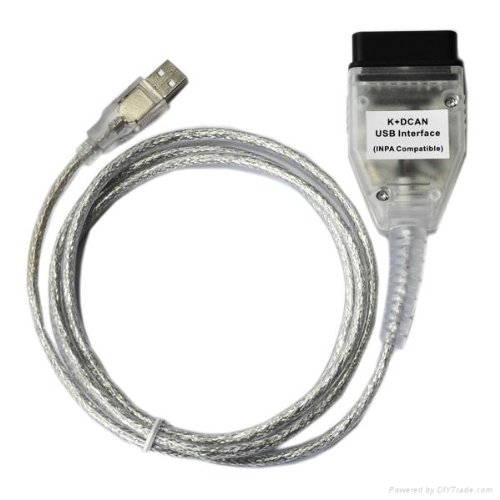

Although this might be exactly what you are referring to when you say "special equipment" I would strongly suggest getting a K+DCAN cable for diagnostic and coding purposes. If you are at all technically inclined or care about maintenance (sounds like you are) or customization INPA, NCS Expert, and WinKFP are fantastic tools to familiarize with. Honestly configuring the software on your computer and getting that up an running is more challenging than any diagnostic or coding you would do down the road.
Evan
