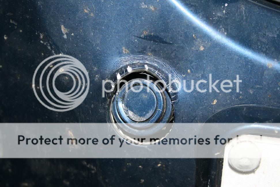

Is it possible to replace the front PDC sensor below the grill (right side) without removing the front bumper? My fiancee kindly managed to impact the PDC exactly against a stationary hard object - don't ask cos even I don't know how the hell that happened

If you can get a hand up to the back of the sensor, then yes. IIRC you'll have to loosen the plastic mudshields to get to it.
The sensor just clips in at the back.
By the looks of the pic, you may need to remove the bumper anyway!!

Nah she hit the back of someone at 20mph, broke one of the headlight retaining clips too, but the bumper is really not damaged at all apart from round the sensor, but God knows there might be damage inside that I cannot see yet. I want to get the PDC up and running in the meantime then try to figure out how much the whole job is gonna cost. I got a price for parts from BMW today, PDC is ?116 cos it's one of the painted ones, headlight is ?330ish and front bumber is the guts of ?500 (primed but not painted). Hopefully the bumper can be repaired and the headlight is pretty firm despite the broken clip, desparate. The only thing I am most thankful for is the fact that the guy she hit, in a nice-ish Audi, just had a look at the cars and said not to worry about it, and drove on with no further action. I was half expecting him to be putting in a claim for personal injuries, like most of the people in this country seem to do whether they are hurt or not!

you can replace it by removing grill ...see post below
http://forums.e60.net/index.php?s=&sho...st&p=515892
