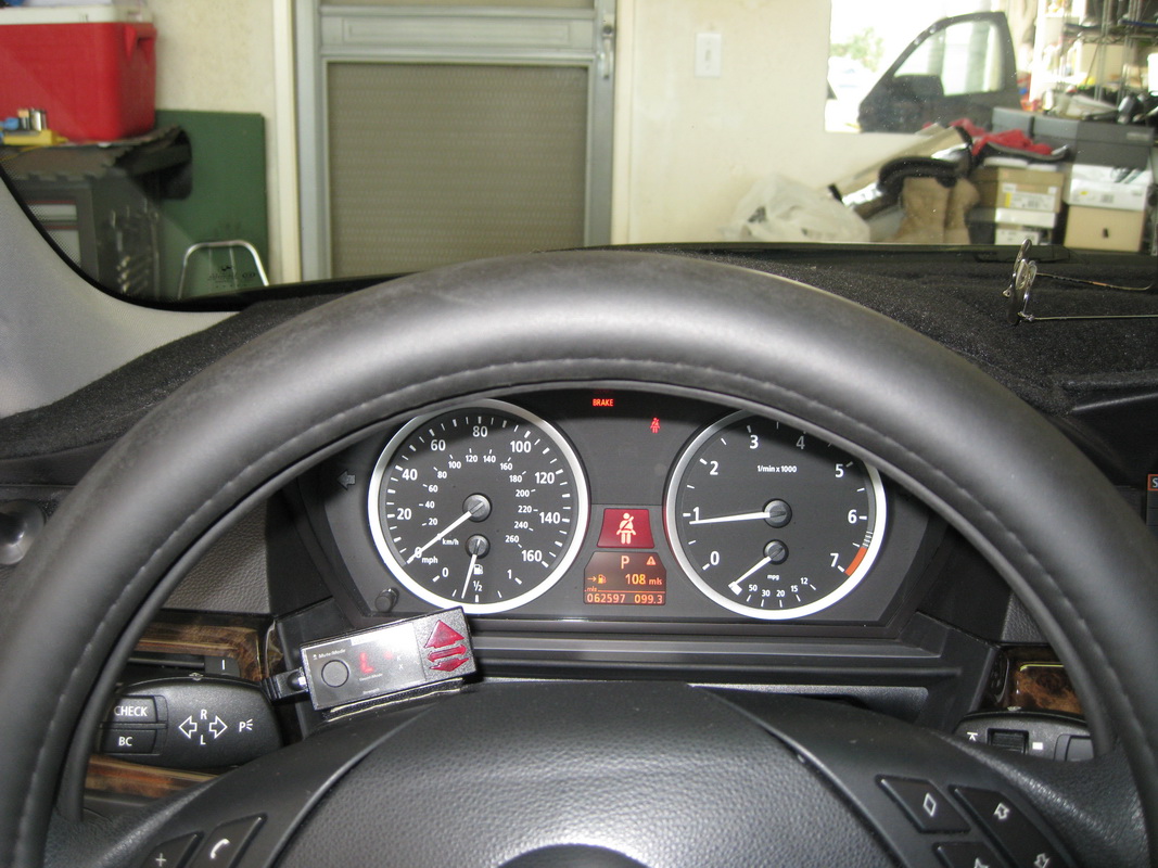

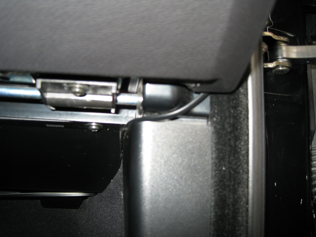

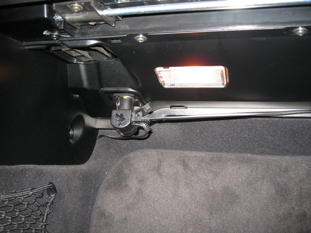

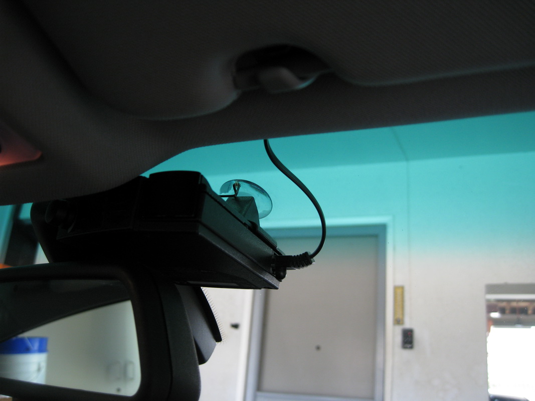

My solution.
I installed my V1 without HARDWIRING, and without visible cables (all nicely tucked-in). I utilized the power socket located right above the front passenger's left foot. Will post pictures soon. It includes the concealed Display Unit (Optional Item) which I velcroed next to the tachometer(No visual warnings from the main V1). Very easy, no pro installer required.
From the footwell socket.

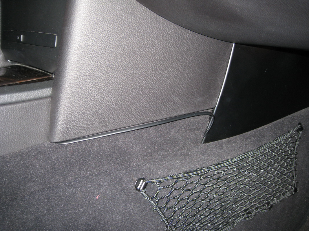

Tuck in flat cable neatly out of sight.

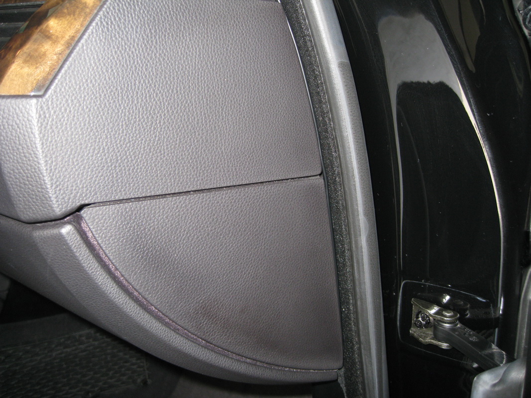

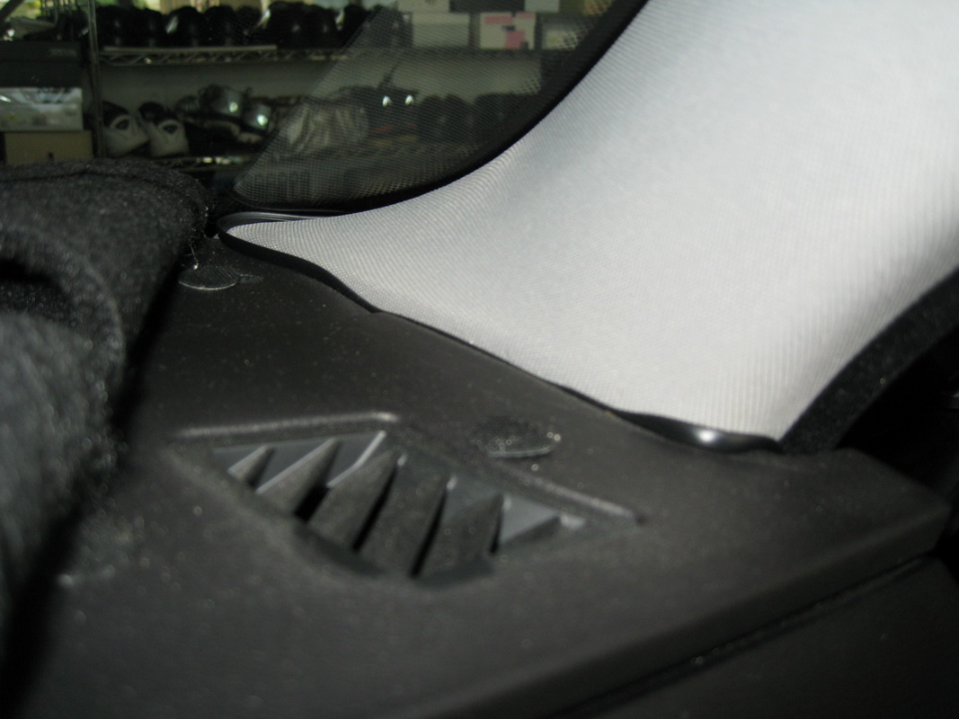

Finally, plug into the V1 unit.

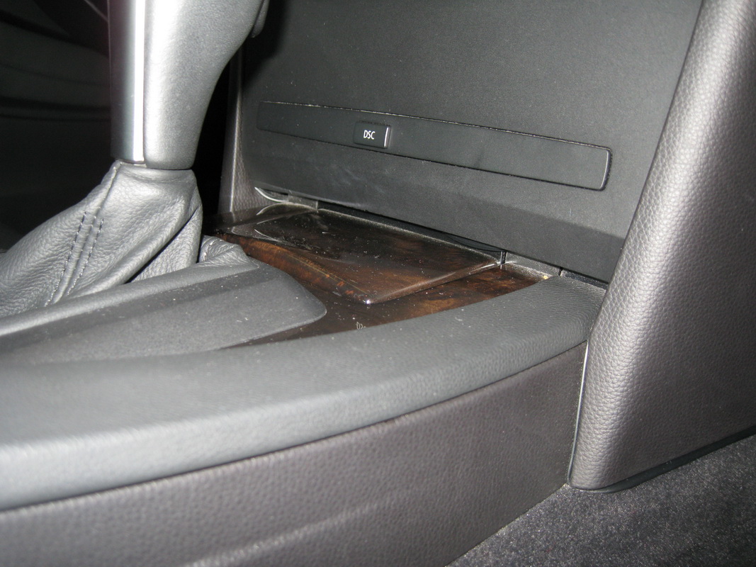

Now for the optional Concealed Display.
From the footwell socket, go left towards driver side.

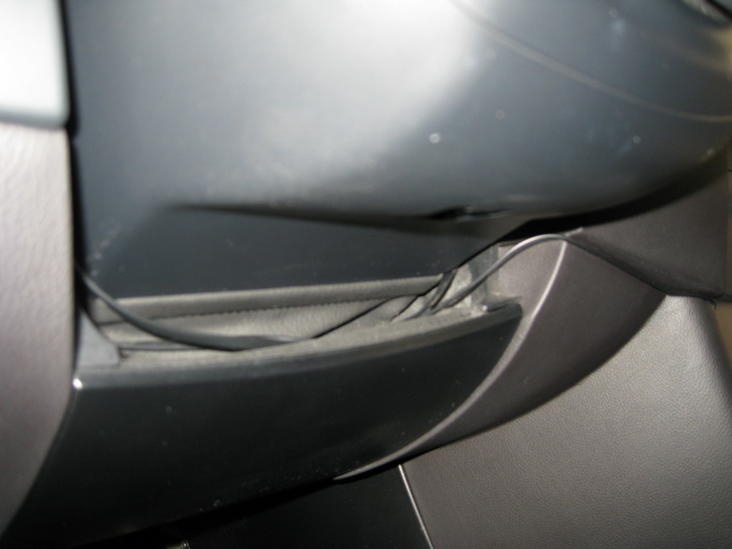

Pardon my dust .
Finally, velcroed the concealed module. Voila! No visual from the main V1 (Dark Mode). Mute and Mode selection are controlled by the Control Knob on the Display (On-Off and Volume adjustments remain on V1).
Of course this concealed unit is another option, V1 works great without it.
Good luck!
