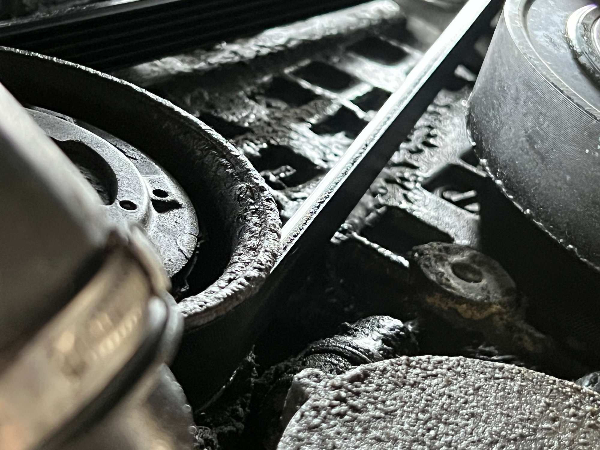

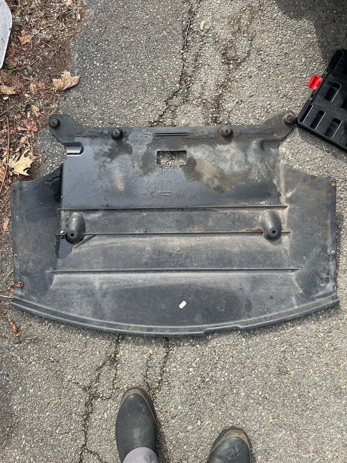

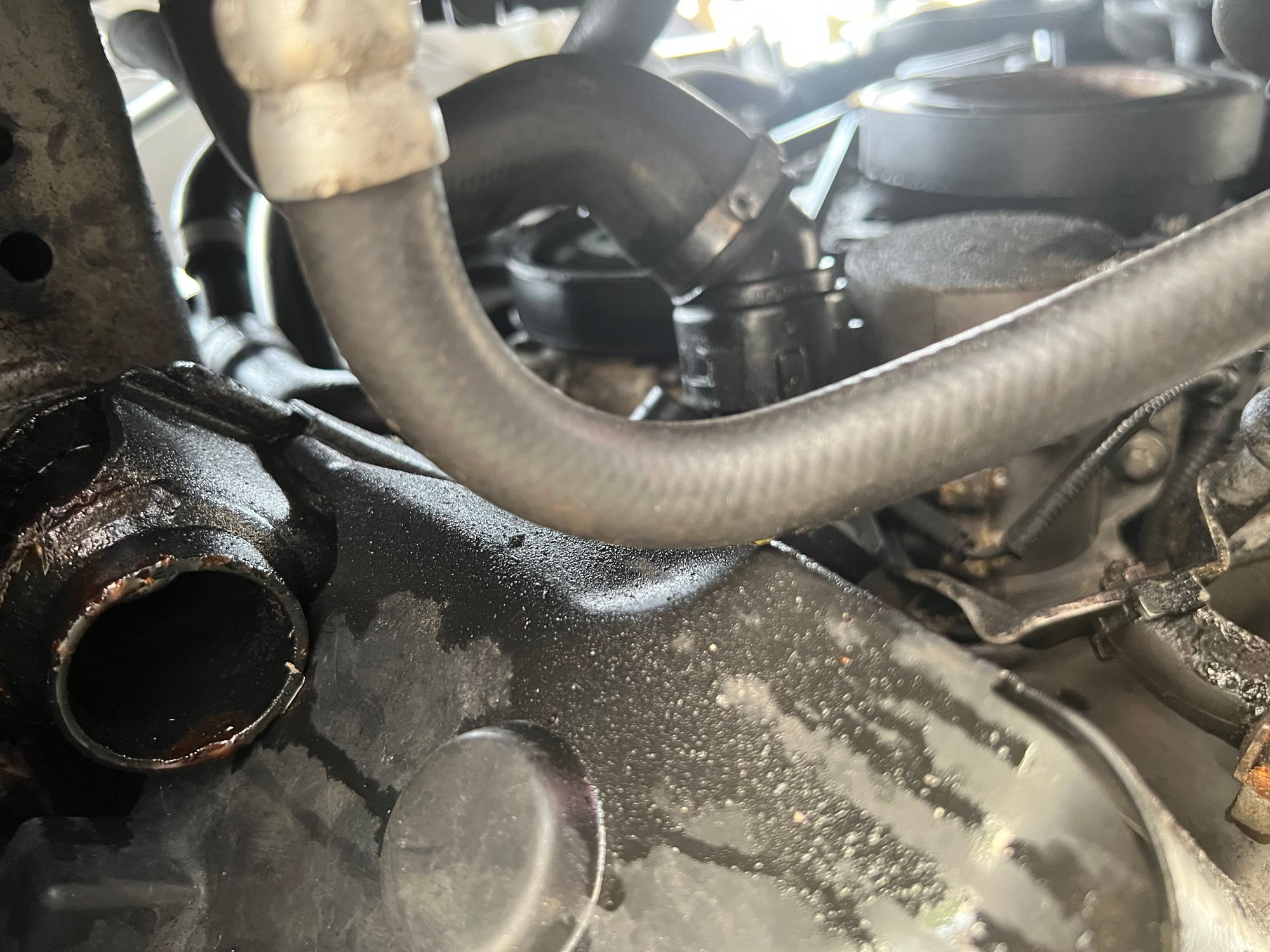

Remove under carriage cover and check to see if there's oil on the bottom of the engine. You'll know immediately because oil will be on the covers. Check front of engine from top to bottom. Crank shaft seal is a very known leak spot on the N52
So finally got around to flushing the engine and changing spark plugs. There does appear to be leaking on right side, as can see on underside of the belly cover. There was some minimal oil on a couple spark plug threads (I think 1 and 2) and then some actual oil pooling in cylinder 6, which seems odd). What do you make of the photos attached?

You are living dangerously. All that grease on the engine and all over the parts near the serpentine belt is trouble. If the belt comes off, it may well get shredded behind the crankshaft pulley and get pulled into the engine and then your engine is toast or mega-work to get back. More than likely you need a new oil filter housing gasket and oil cooler gasket. You also need to get all the crap off the front of the engine. And, get a new belt.

What twh said!
It's often hard to tell everywhere a BMW I6 is leaking because they can have so many leaks! The valve cover gasket is another likely candidate. The best thing to do (after you replace the oil filter / cooler housing gaskets and the serpentine belt) is to clean up the engine block as much as possible, and look for new, fresh oil leaks to see if you cured the entire problem (or not).
