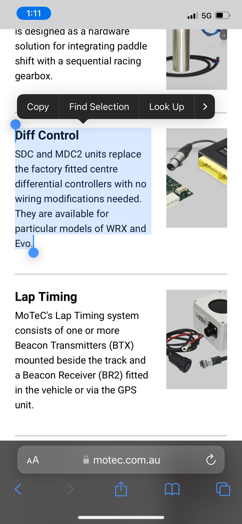

For any who are still following this writing; there is actually so much I want to write, but to keep things simple, I wanted to mention that I just learned the MoTec sells differential controllers… really it should be called a transfer case controller if it’s usable in the BMW or Nissan AWD type systems; if these work it is proof that an AWD car can be constructed with standalone control modules. Meaning, you could ditch all the expensive and old OEM modules and run the engine with a Haltech and the transfer case or center differential with the MoTec module. I haven’t read the parts webpage but it looks like they’re mostly for Mitsubishi AWD. I have no idea how the Mitsubishi system works, as in, I have no idea if Mitsubishi is similar to Subaru or more similar to the transfer care type AWD.
For anyone who doesn’t already know, Subaru is front wheel biased because the transmission has the front wheel’s axles coming out of the transmission case from a literal differential inside the case turned by the transmission and then there is a clutch pack type component (viscous coupler) that turns the rear differential driveshaft when able, (it is like the air-cooled Volkswagen Beetle transmission but turned around AND ALSO has the read wheel drive capability), whereas conversely, the BMW and Nissan type systems that are being talked about in this writing are similar in shape to a jeep where there is a rear wheel drive transmission that simply has a transfer case bolted on, and these are rear wheel biased, and the transfer case sends power to the front differential when it is hydraulically actuated between 0% and 100% - thousand times per second. Look up photos of it
