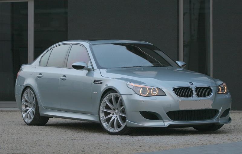

Airborne7, what kind of RIMs are these? They look great. Also who sells them? Thanks
